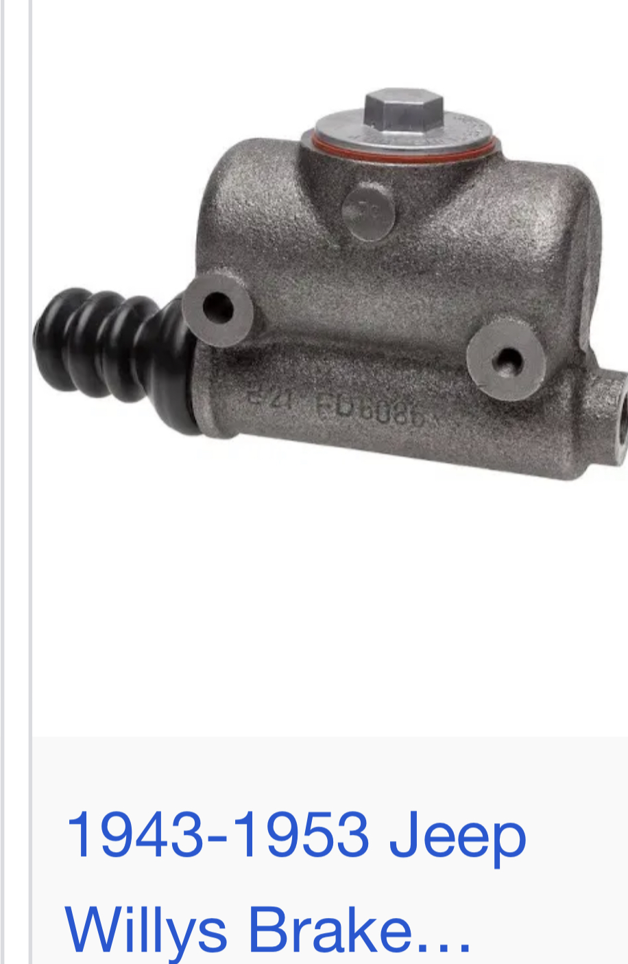

    Can't remember where I saw it, possibly on the HAMB, but there was some type of later model Jeep master cylinder that would bolt right up to stock location.
  10. There’s a 40s-60s CJ master cylinder conversion using the AMC one or similar I posted. That MC or a version of it showed up on Jeeps as well.
    The original jeep MC looks very similar to the Mercury.

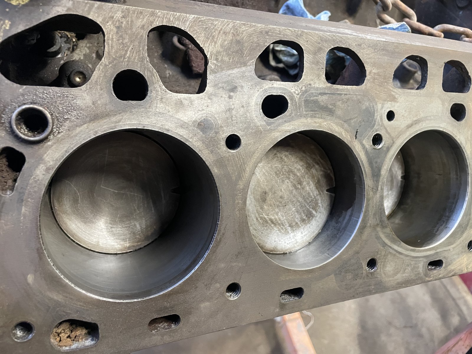

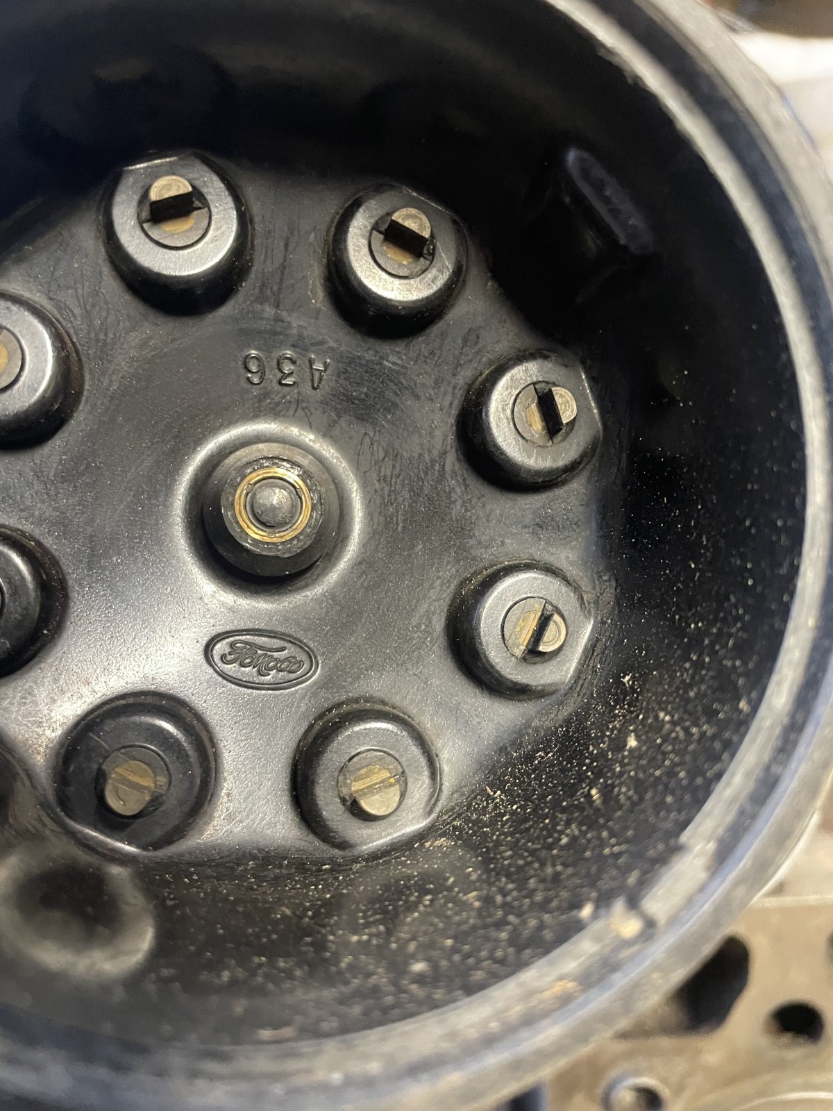

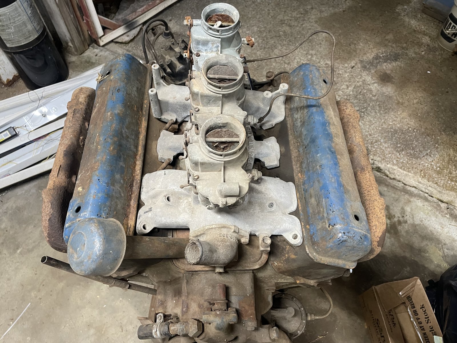

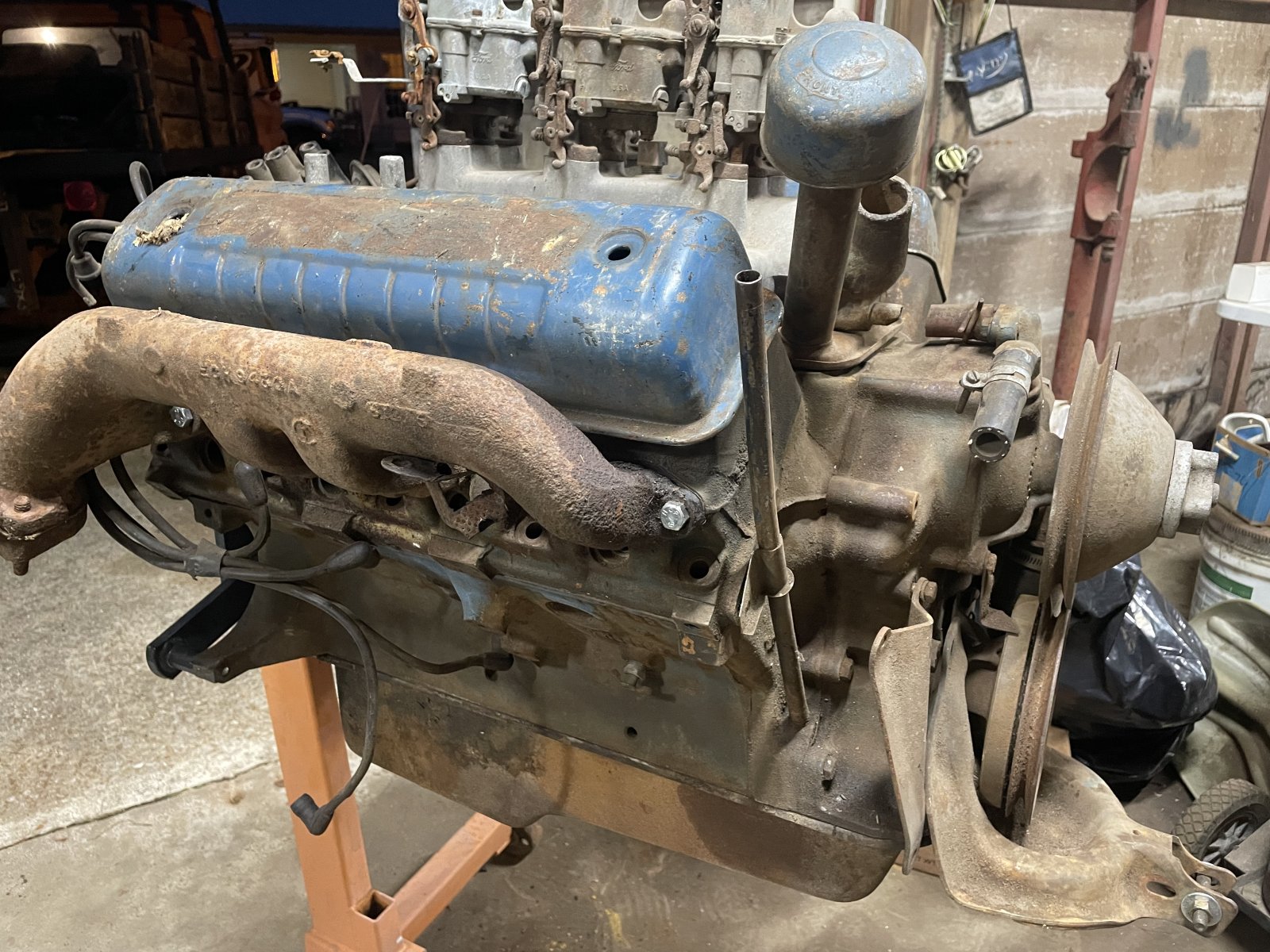

  12. Got a call from my uncle. Said he had some s**** iron he didn’t need anymore.
    55 or 6 272. Car had 55k miles with an overhaul sticker in the door at 50k.
    The exhaust manifolds were given to me earlier this week from a friend. The carbs were freebies and the intake came from a NSRA show around 1999. $35
    96DE38D5-7109-4D4C-8B7E-03EB6047FBD1.jpeg 8B5877AF-BD72-4FE5-B3C0-28E6E4632D80.jpeg
    Turns freely, standard bores look good but a couple have surface rust :(
    Looks to be a standard crank. Has clevite bearings. The rear sump pan is a leftover from my bus.
    Ive got the bell, a nice flywheel and an old reman clutch plus the gen and little stuff
    If I use it or not eventually, not bad for a few gallons of gas and $35

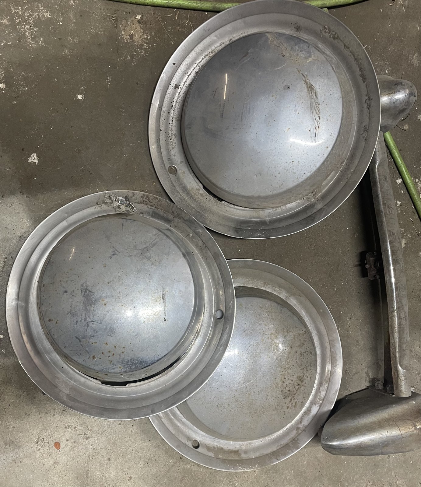

    Cleaned up, those are beautiful hub caps. I ran the set off my 49 Merc on my Dads 312 powered 56 Ford pick up!

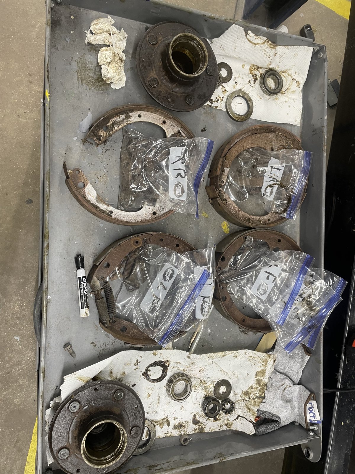

  24. Got the brake parts coming.

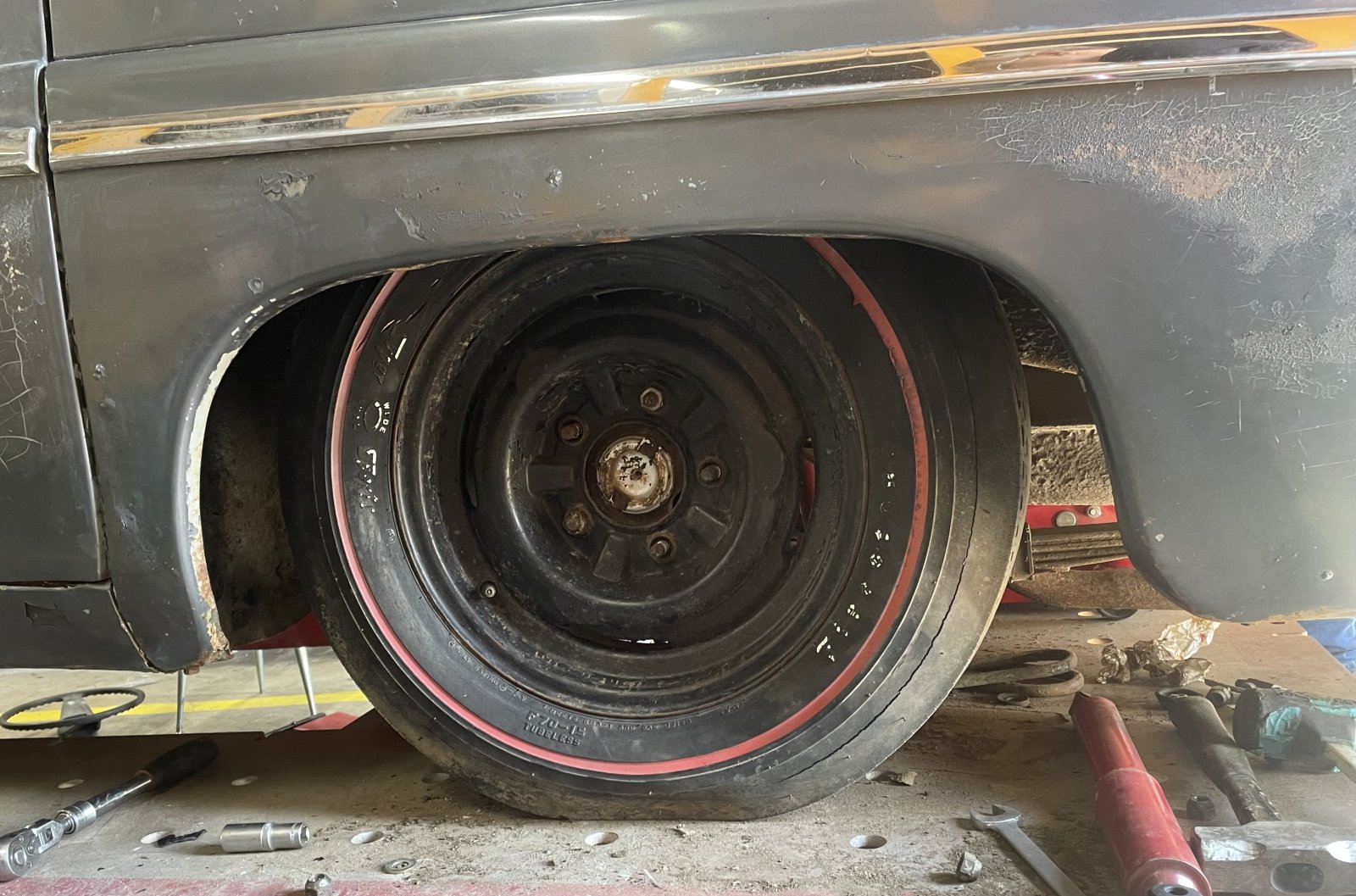

    Students learning to bag and tag
    made 2 and 3 inch blocks. We’ll figure out the stance when the front springs arrive
    turning locating pins on the “lathe”
    2 inch blocks installed
