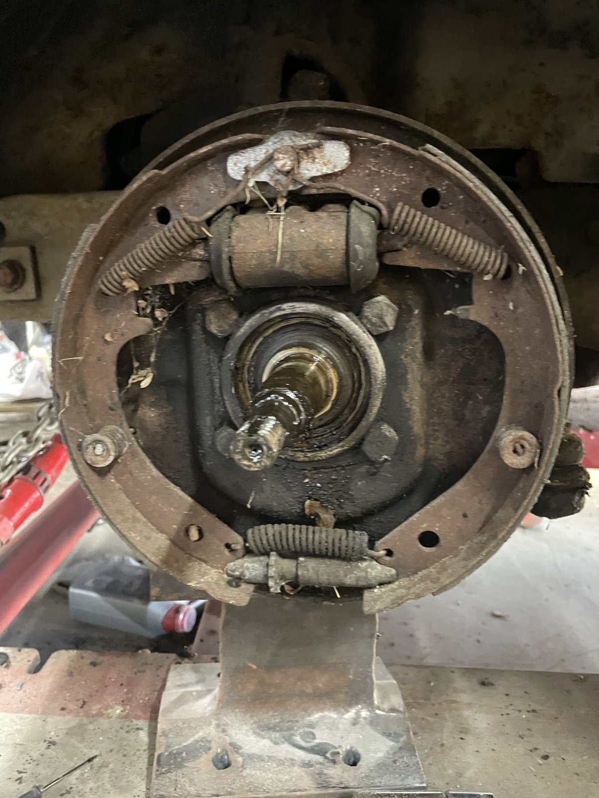

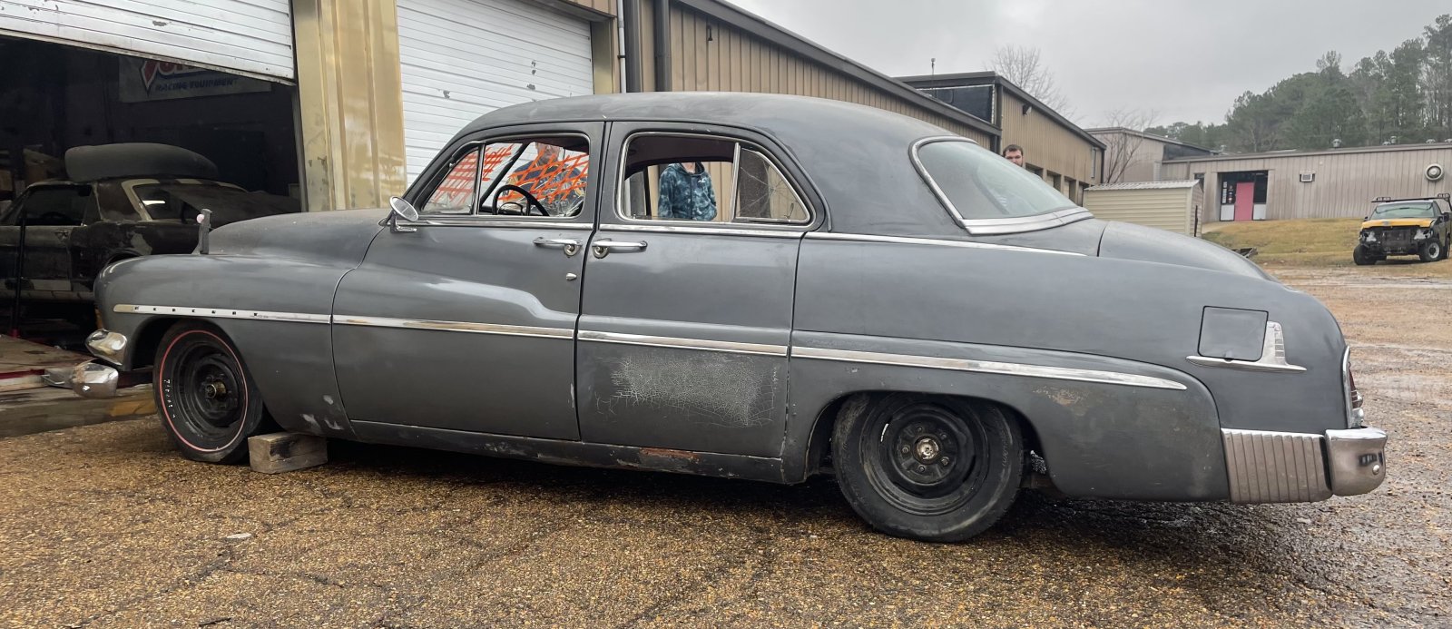

  4. Front and rear pic.
    91F50948-D498-400F-AC13-B5DDE9686961.jpeg 45FAAA40-60F4-4A36-A367-4CB814CA1E50.jpeg
    both the left side.
    Do***enting a build, reference pics. looking up info and parts.
    These phones are cool.
    Hold down springs we’re missing on one of the rear shoes.
    Plan to clean up backing plates and paint em. ***emble them off the car.
    Just picked up the front springs. Hope to have brakes on as soon as parts come in.

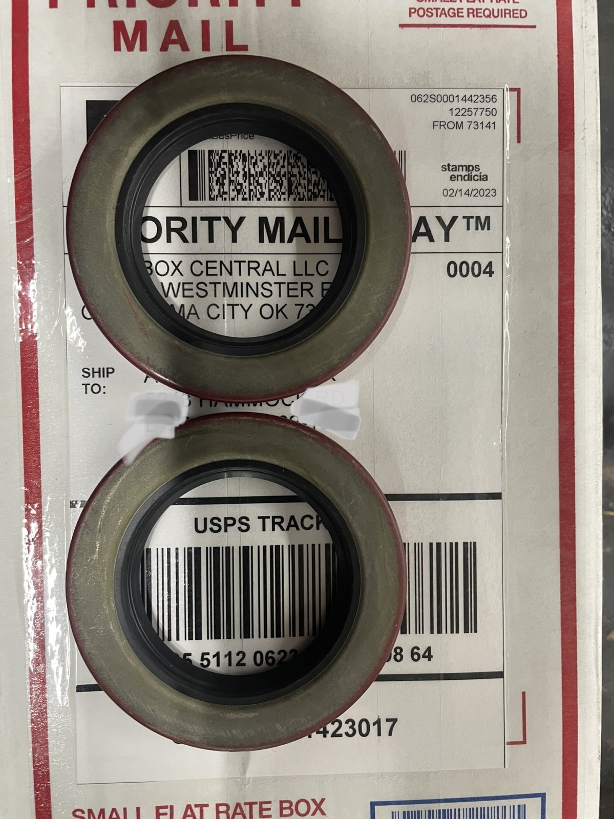

    The front seal 8m-1109 doesn’t seem to have any other application except Mercury/Lincoln.
    National number is 6429
    Shoebox central is sending some.
    Spring kits coming from Kanter.
    The rest was sourced locally.

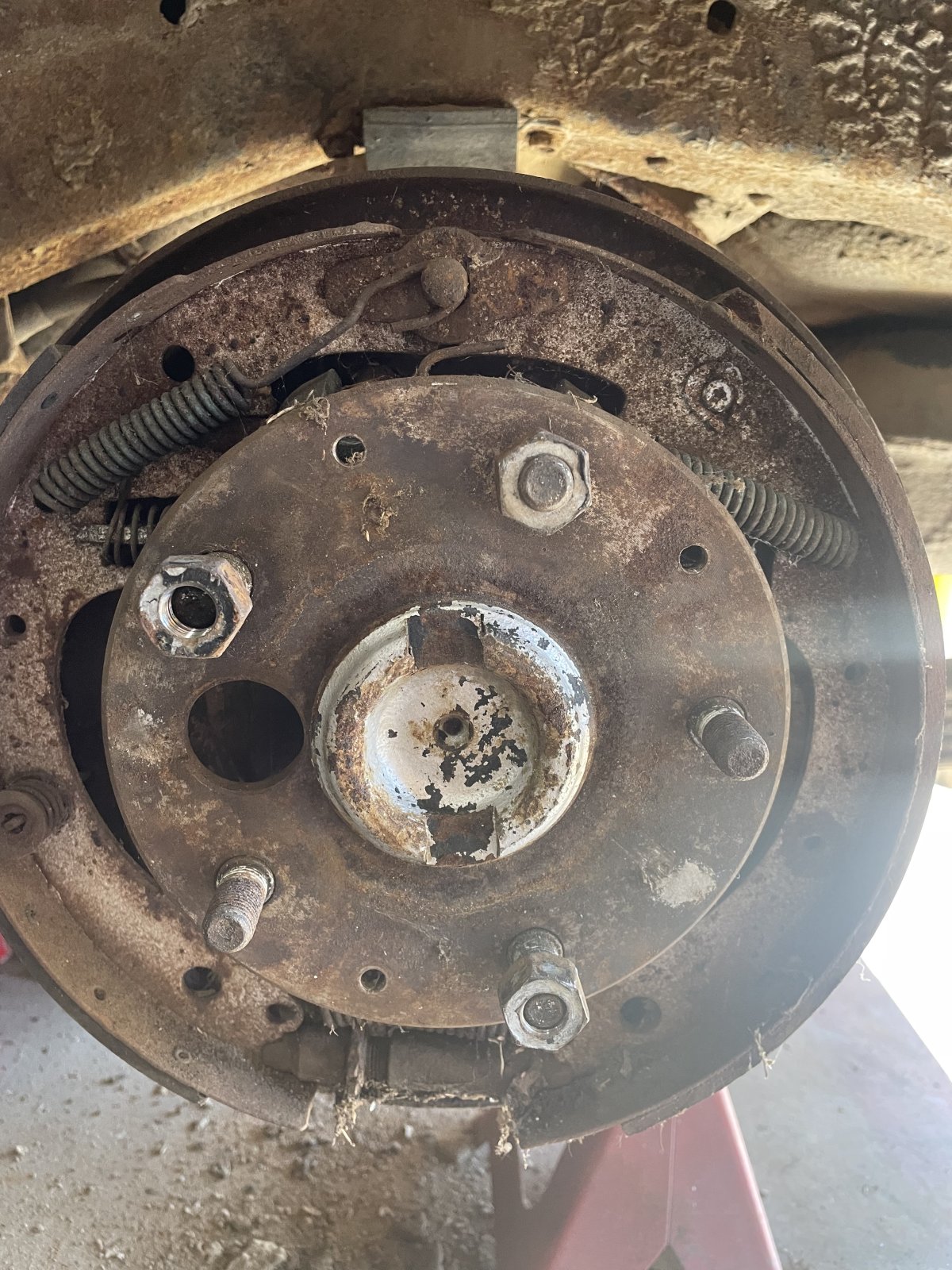

  5. Aerostar springs and homemade blocks.
    FF7E9438-B975-48E7-8091-9BEC27A530C6.jpeg 93B5C4F6-7B4A-4880-A603-A24F6706EF42.jpeg F1F823C9-5652-4E29-BB7E-5AD7A51A10CE.jpeg
  6. guthriesmith
    Joined: Aug 17, 2006
    Posts: 11,970
    guthriesmith

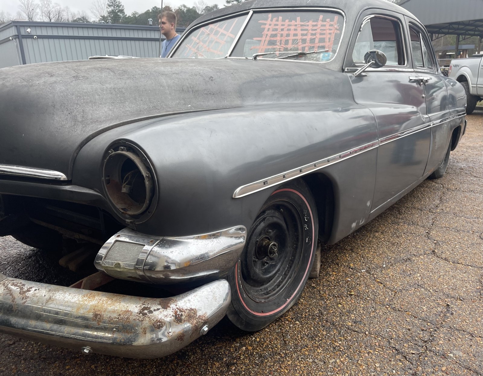

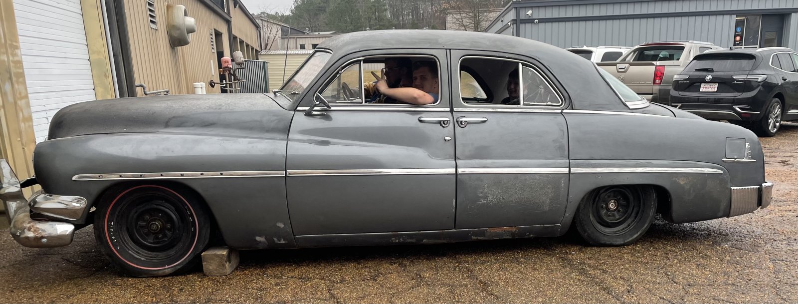

  7. It’s better. Or a good starting point.
    I can live with that while I cruise and modify
    winduptoy and guthriesmith like this.
  8. 2 inch block.
    I’ll let it settle some.
    A spring spacer and 3 inch blocks might be tried eventually.
    winduptoy and chryslerfan55 like this.

    I think it'll need the 3" block because KUSTOM. Got skirts?
  10. guthriesmith
    Posts: 11,970
    guthriesmith
    The front will likely settle some over time. I think mine likely did about an inch or so with Moog Aerostar springs. And, I am also considering 3" blocks to replace my current 2" but only because I don't have to haul four kids in the back anymore since they are driving...
    And, seems like you had one good skirt?

    As bad as some of the roads are in Walker County, 2" is probably as low as I'd go. Any lower and you might be bulldozing new holes! :eek::D:D:D

  14. That Mercury looks bigger since you lowered it. It is looking great. Taking pictures is a great idea, when we dis***emble something like a cylinder head at work, with all of the fittings and small parts, we take pictures and send them to each other if someone else has to re***emble it.

    Sits nice. Put a few miles on those coils, they'll settle out a bit more. My '52 Ford has 3" blocks in the rear and these same springs and it sits level.

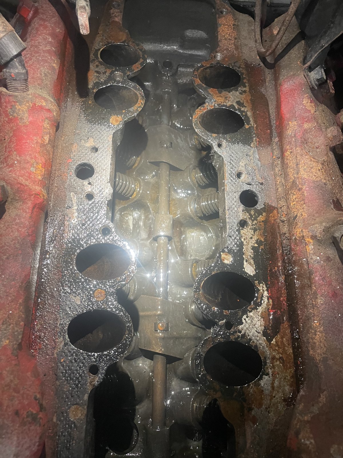

    gotta few stuck intake valves.
    Soaking
    Pulled plugs and shot some sea foam creep on the valves and in the intake ports

  19. Almost did that but the spray can stuff can reach places better.
    Engine turns freely. Will pull heads if necessary.

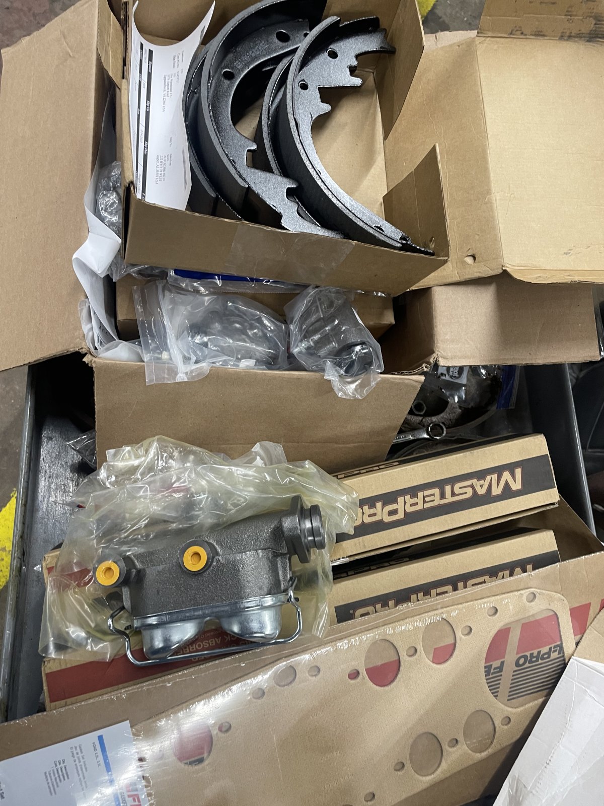

    Hope the spring kits show up soon
  21. Intake valves just needed some lubricant.
    3 exhaust valves aren’t cooperating, 2 will move but not close.
    One lifter is stuck.
    Soaking

    Sometimes the varnish that seems to expand with disuse can be tough to get cleaned up. You might try shooting some carb cleaner at the sticky ones, let that kind of soak its way through, then use some of your favorite concoction again. We had a Plymouth flathead that fought us on the same front for a couple weeks before we tried acetone on them.

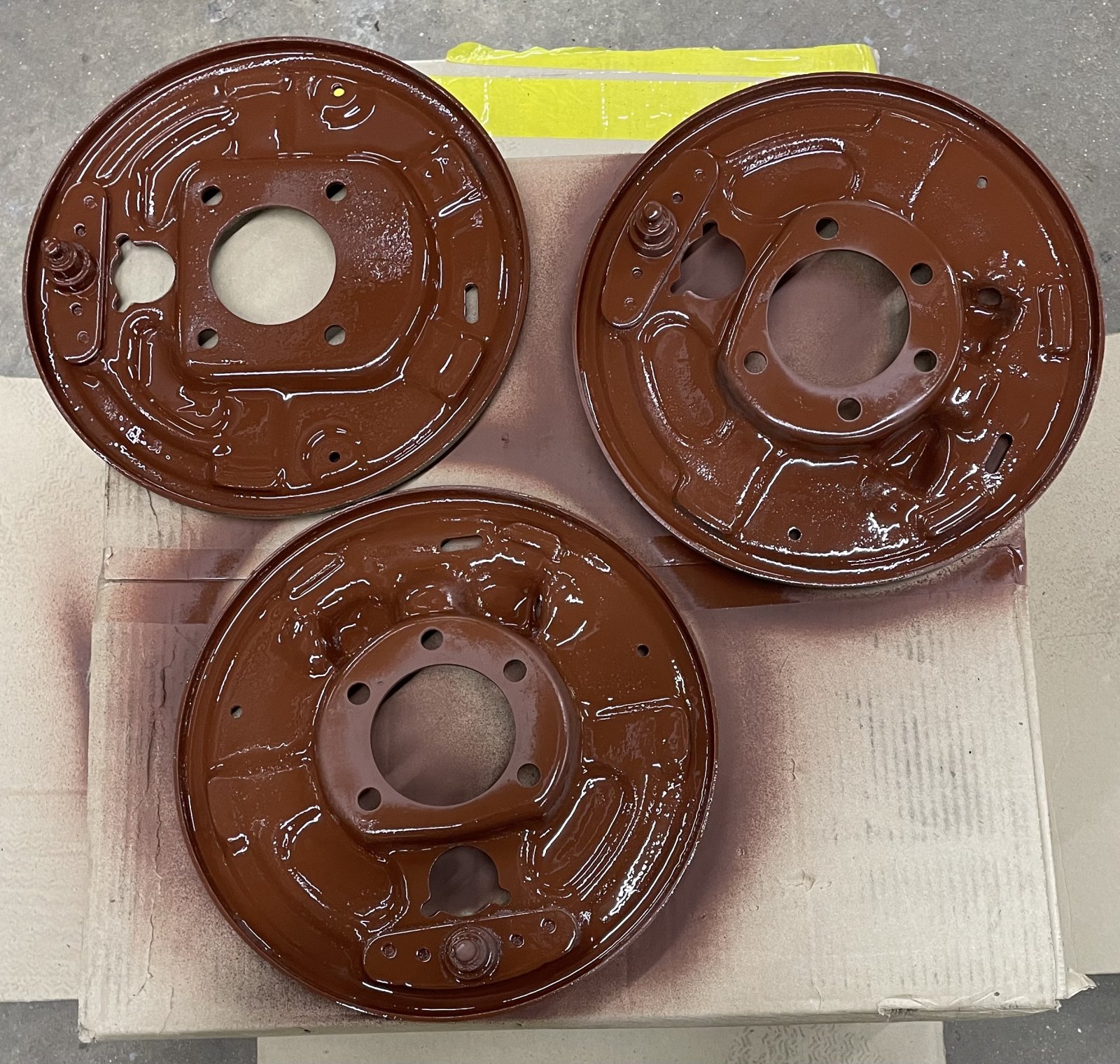

  25. Shoebox Central for the win with the front seals. Ordered Tuesday. Gottem Thursday 9EB0F7A1-FF7F-46CD-904C-D7F46020F855.jpeg
    getting backing plates ready to ***emble
    Just a clean up and prime. Not over thinking this one.

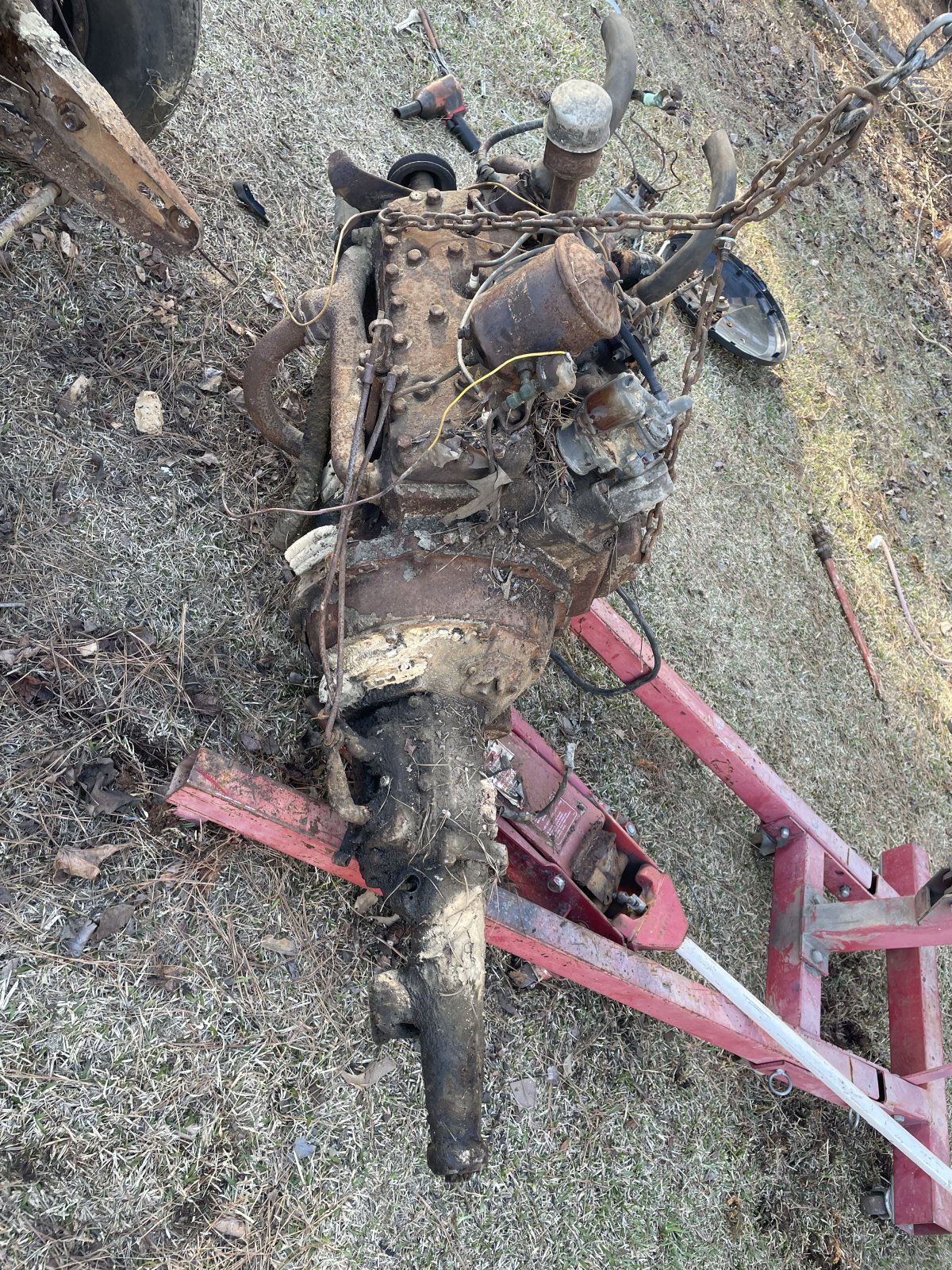

  26. The dual MC won’t work with the headers on the flatty.
    We’ll still mess with the flatty for the next week.
    I think I’ve got everything I need to do the 283.
    Gotta crawl under one of my parts cars to check out the trans. Using the older style flatty trans equals no clutch mods.

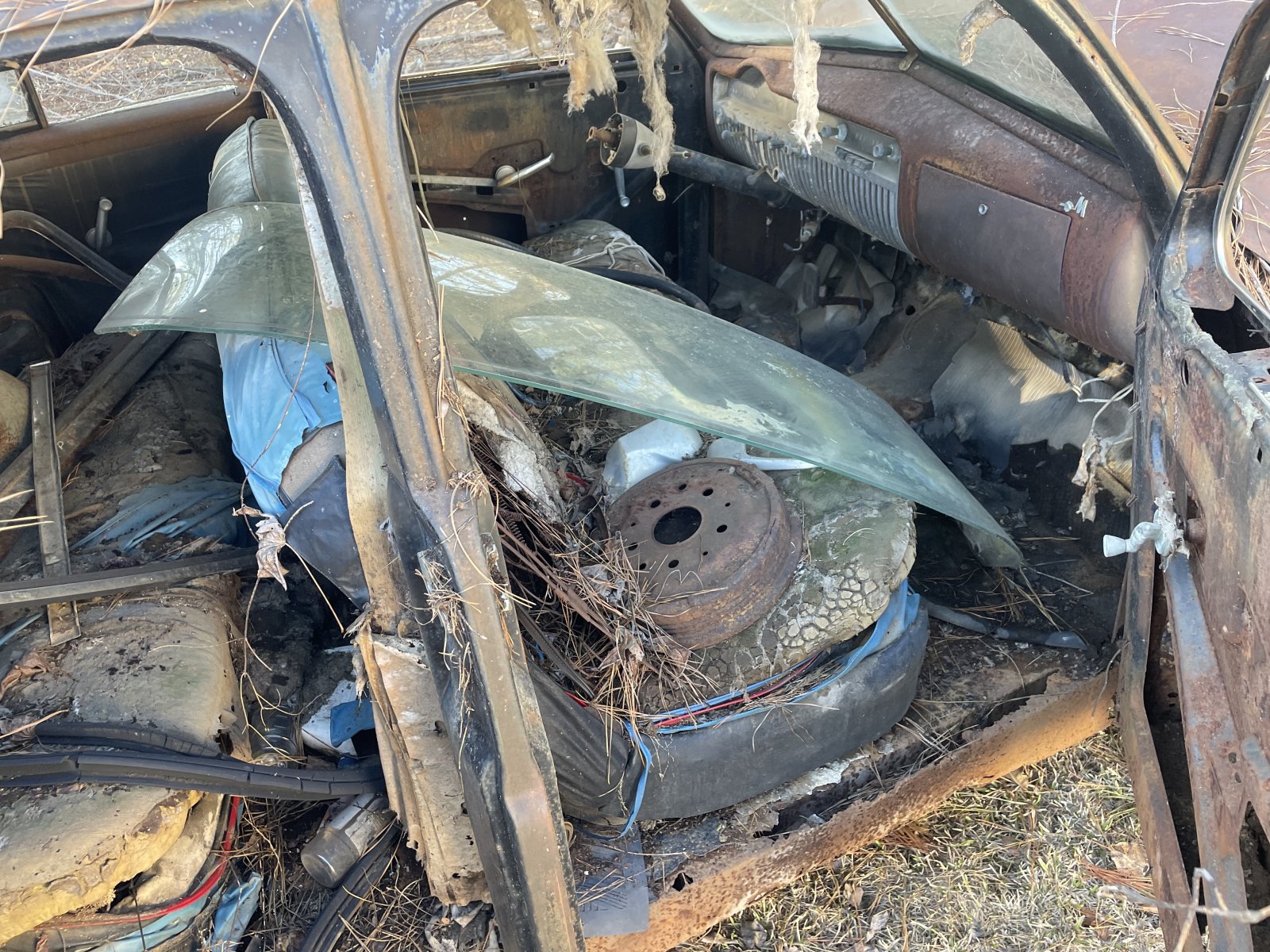

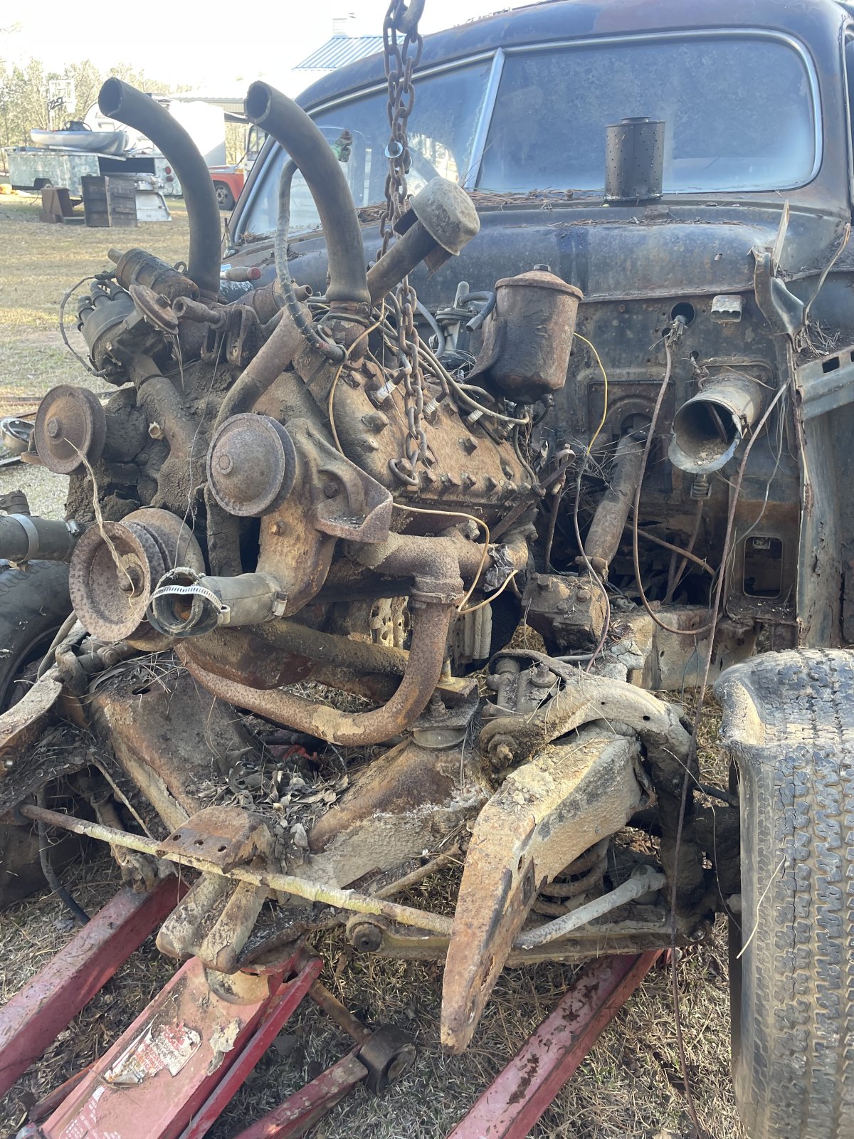

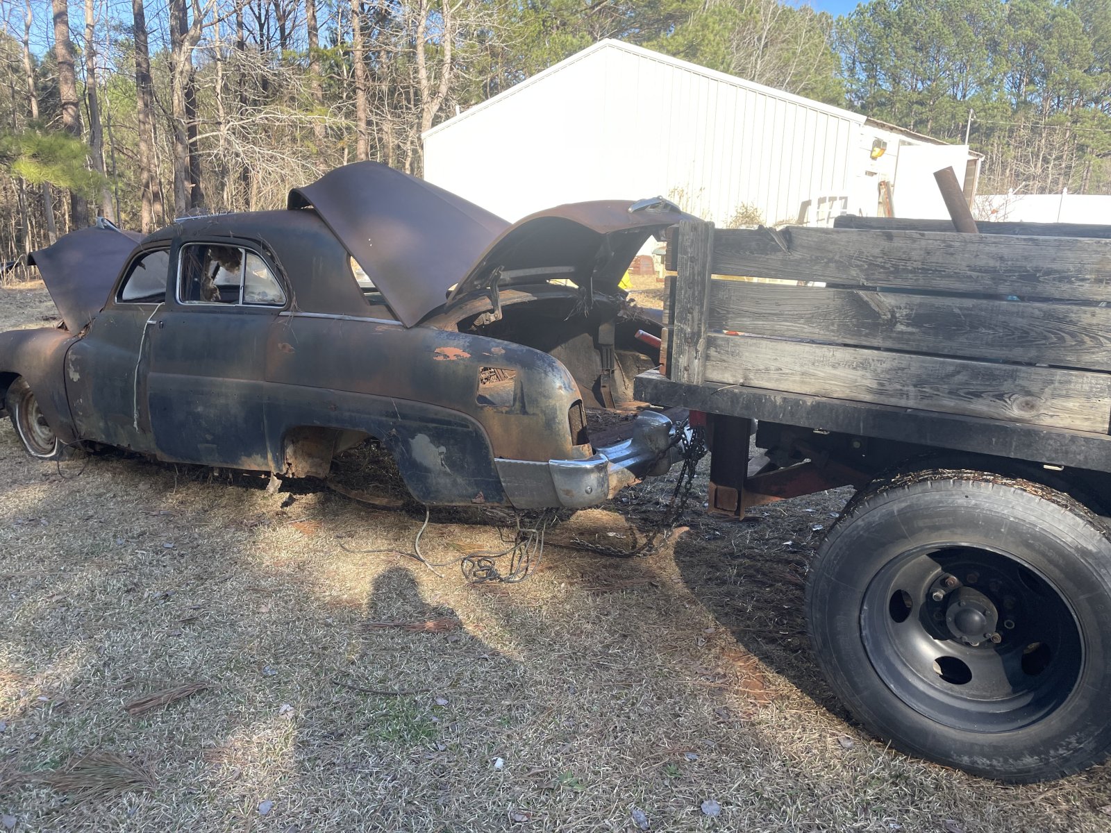

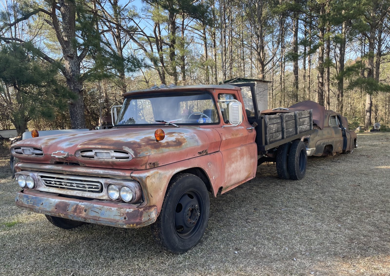

  29. What in the deliverance hillbilly **** is going on here
    628421FE-8996-4AA8-9105-957A8DA5D8B0.jpeg FA4F9BF7-D46C-499A-9D17-64A8168723EA.jpeg 4133AF01-BCEB-41F6-B48C-B12DE0CEB570.jpeg
    harvesting the good off this beater.
    Has the earlier style trans. All linkage is complete. This would work if I plan to swap the engine.
    Engine is complete.
    Could use the stock manifolds if I wanted to use the dual pot master cyl

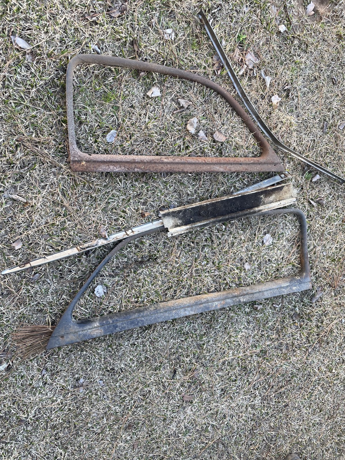

    Had a 2 door garnish molding. Well I be
