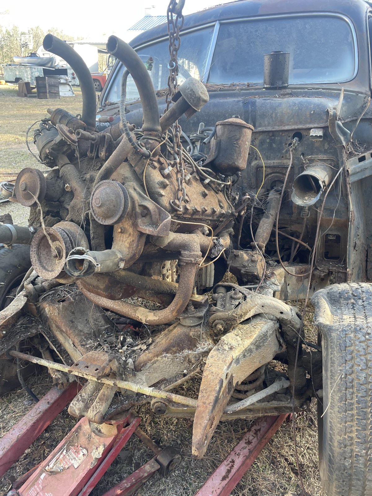

    Picked up 10 years ago for $50 at a swap. Didn’t need it. But wanted it just in case one day.
    This flatty in the parts 51 looks decent so far
    And a decent alternative bumper if I need it.
    and a clean merc carb. Not stuck.
    mvee33, williebill, Ford52PU and 12 others like this.

    Make sure you get the U shaped spacers that go between the frame and the water pump. The Merc pumps on the engine you show are narrow belts that are like wide belt truck pumps but the mounting tabs are different heights which is why you need the U shaped spacers. If the engine is toast the pumps are worth something - no one repops them. And the 1/2 bell is used when installing an earlier trans to an 8ba.

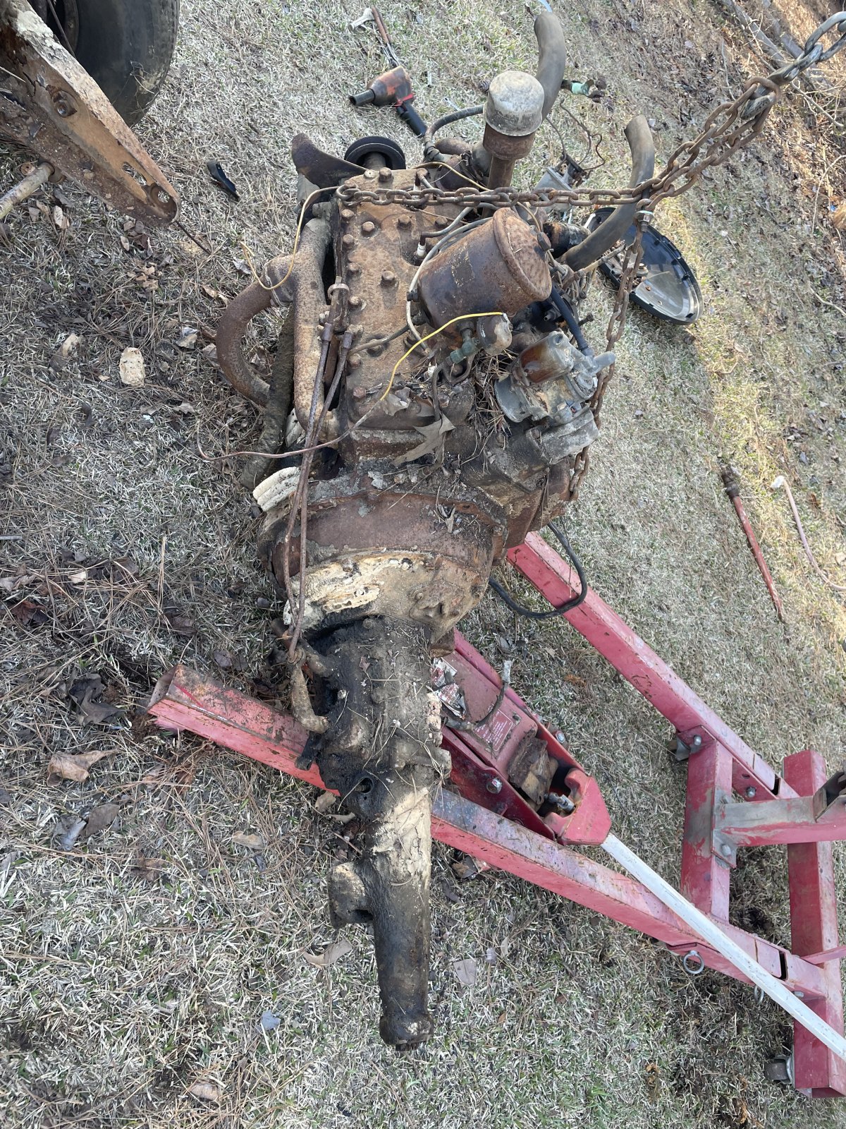

  3. I’ll hang on to all of it. And my other merc engine has the narrow belts. Pumps still turn. Should be buildable.
    block looked much better than I thought it would. It’s been sitting for at least 40 years. Cracked? Don’t know. Has 8cm heads and should have the merc crank
    I pulled a flatty out of a 48 f5. It also had the 1/2 bell

    The Merc 1/2 bell is stamped steel. Should have a 10 inch clutch. The 1/2 bell out of the f5 is cast and an 11 inch clutch will fit until like the Merc 1/2 bell which maxes out at 10 inch.

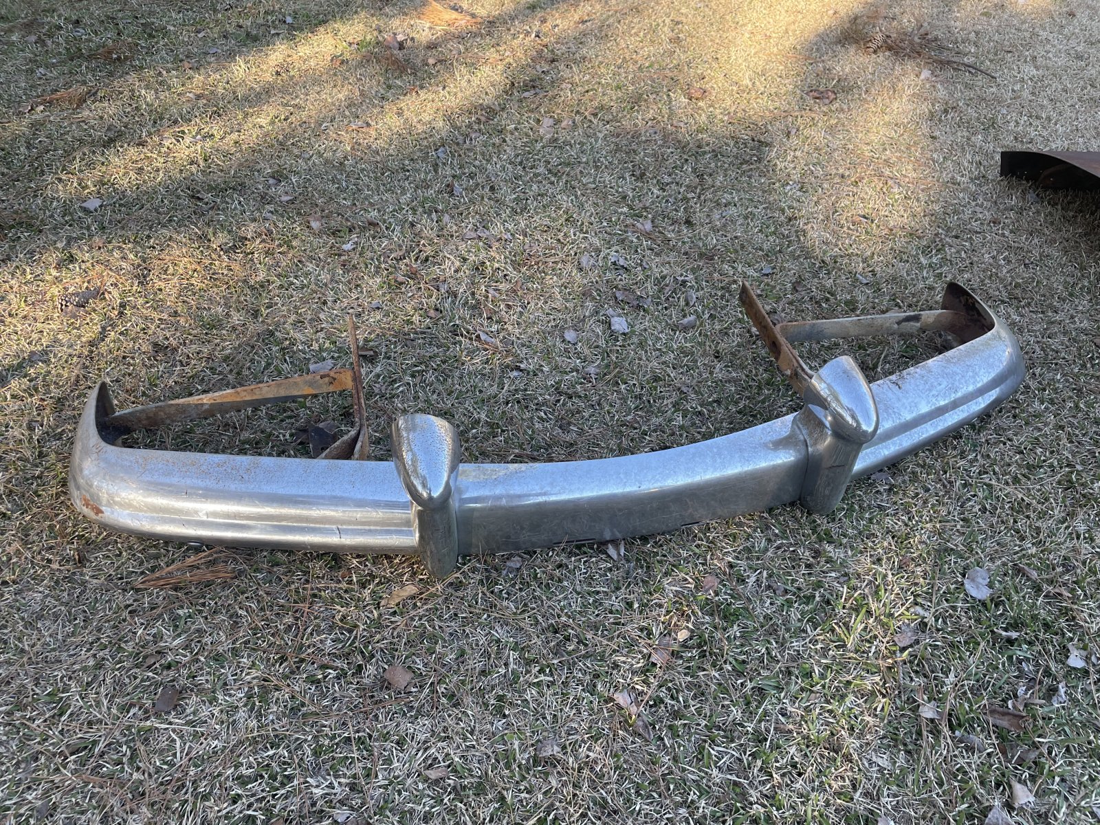

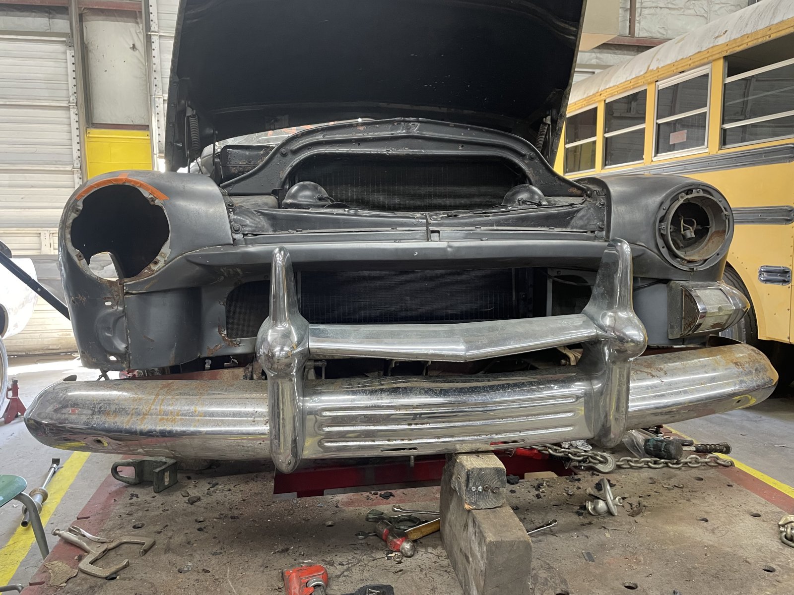

  6. Scrounging/cleaning in the shop I got a message from @Jakob H. He inquired about the bumper guards, the smaller ones for a 51. Yesterday, I decided that I’d run the bumper I pulled from the parts car. The more I looked at it, the better I liked it over the large bumper guards.
    0DE54845-8D3E-4DF5-9D27-4FFB77011A65.jpeg 082031C2-20E2-4C8A-887D-903DB84ECE73.jpeg
    If any you guys have a standard set of 51 bumper guards in driver quality, send him a PM.
    Thanks.
    Cleaning up the trans, gears look good. Super clean inside. Scrounged up the flywheel.

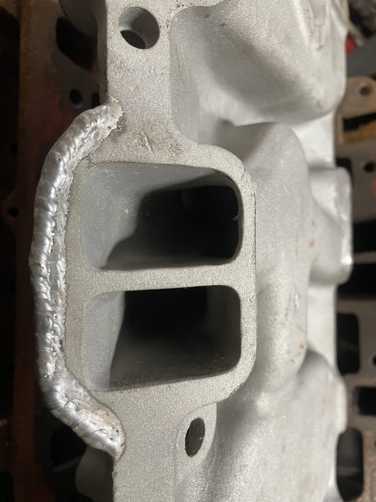

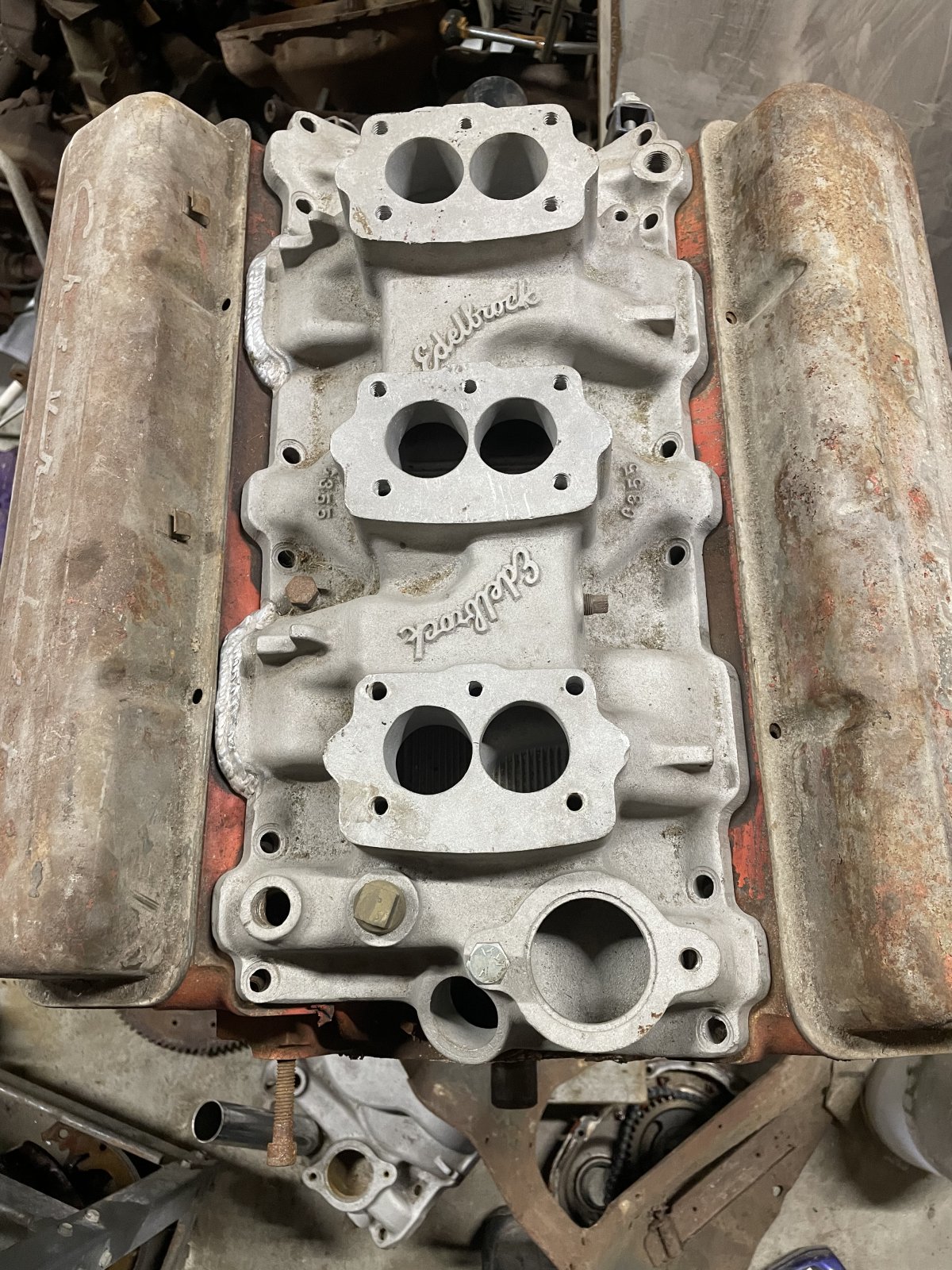

  10. Another possible dumb move. Bought this 3 deuce intake years ago. Early small port.
    BEDE9C73-AE41-4CEE-B721-8FAC327A0881.jpeg 4E460C40-2E1A-4CFC-92FD-103408B7BFAF.jpeg
    we started welding it to enlarge the ports to add gasket room to work with the larger port heads.
    Wouldn’t take much to finish.
    Good or bad idea?

  11. guthriesmith
    Joined: Aug 17, 2006
    Posts: 11,970
    guthriesmith
    For the cool factor, good idea. For a daily, I would just run a single four since 3 carburetors can be a pain at times.

  12. Ive got an early cb intake and a 4 jet carb.
    I’d like to run the 3 deuce.
    Finish working the intake ports and gasket match.
    I’ve got 3 or 4 ford 3 bolt carbs.
    I’d need a couple more 2 jets to use them.
    A friend of mine runs 3 Rochesters on a 348. Runs well. He worked with the 2 end carbs with valve compound on the ****erflys. They seal up very good. Using a progressive linkage.

  15. 38Chevy454
    Joined: Oct 19, 2001
    Posts: 6,791
    38Chevy454
    You *could* run the three carb intake on just the center carb, with non-functional dummy carbs on the ends. You would not be the first person that has done this. Especially for a SBC with the stock trans, the reduced power of one carb will still be more than the flathead had.
  16. We ain’t looking to out run anyone.
    Just cruise.
    I don’t mind getting p***ed

  17. A Boner
    Joined: Dec 25, 2004
    Posts: 8,162
    A Boner
    Three Two barrel manifold with one working carb = cool looks (if you don’t look too close), and great fuel economy. An added bonus ******* off the ****’s, that take life too seriously!

  22. bchctybob
    Joined: Sep 18, 2011
    Posts: 6,040
    bchctybob
    Welding the manifold is fine. Run what you have.
    You can do what I did, run the 3x2 setup on the center carb at first and later, when you feel like it, start working on making the end carbs work right. I found extra carburetors and worked on them while driving the car.
    Multiple carburetors rule, even with a full hood.

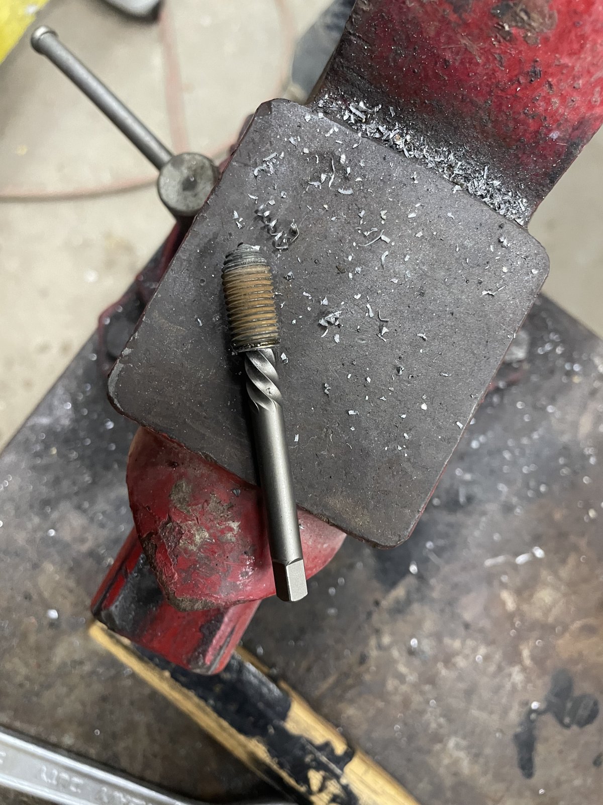

    what success looks like
  30. ClarkH
    Joined: Jul 21, 2010
    Posts: 1,571
    ClarkH
    Congratulations! Man, I know the feeling. I kept the broken stud in my toolbox as a reminder.
