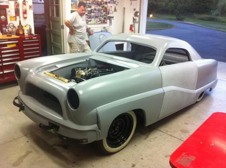

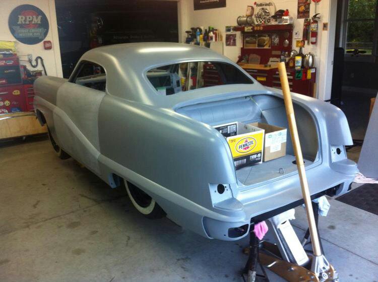

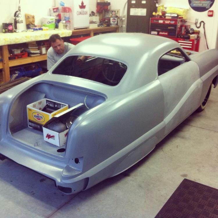

  10. This one isn't "pro-street."
    Edited to add: It seems like this one wasn't finished or is camera shy because there are no other pictures to be found on the internet. It'd be cool to see pictures of it finished. I can't tell what engine is in there. These pictures might have been taken in Canada, going by the "Canadian" sticker on the refrigerator.
    This was posted on Custom Car Chronicle a decade ago:
    https://www.customcarchronicle.com/forums/topic/metropolitan-custom/

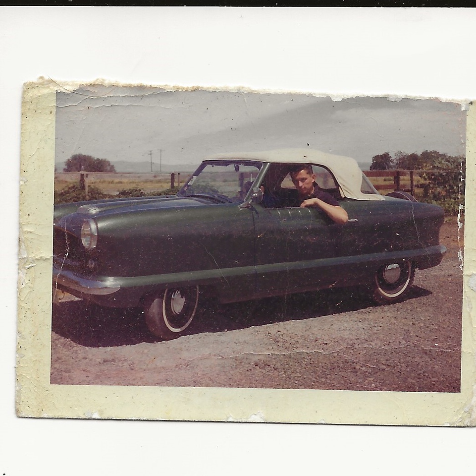

    I had one of those damned things when I was a Sr. in High School Bought it is summer of 1964 after I blew the flathead in my 51 Merc up and needed a car to drive to work.
    Stock engine and running gear are Austin in the Metro complete with a crankckshaft that is threaded to screw the oil back in the engine rather than having a rear main seal. I blew the original engine up and dad found me an Austin A 40 for it and hauled it over in the trunk of his 57 Olds Super 88 that had a J-2 Tri power in it.
    They are unibody with no frame and pretty damned flimsy. Especially the rag tops.
    Leaf springs on the rear I don't remember what the front suspension was like. The track is damned narrow though making normal suspension swaps a pain in the ****. Even a Corvair front end is going to too wide.
    If it were me I'd put a common 1200/1600 CC banger with a transmission of her choice in it. I'm not sure that a Ford 2300 or iron duke would fit without cutting. At 1800 lbs you don't a lot of power to run faster than you want to ride on that 85 inch wheelbase.
    Top photo is me in my 55 rag top in 1965. Bottom photo is one a guy I went to trade school with has for sale that is certified for 8.50 and runs a 427 and is for sale. Me in Metro (2)-X2 (1).jpg View attachment 5760485
