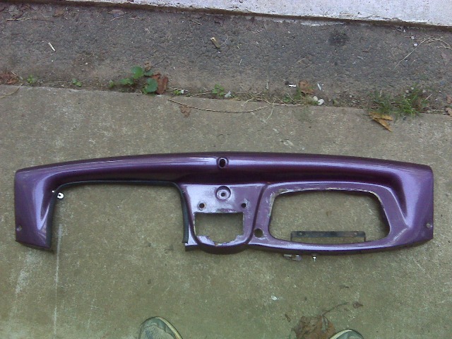

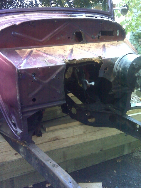

    Slow down my friend,you have my head spinning.Post some pics of your firewall,so we can see what you need.your dash is cut up pretty bad,was there a glove box door?Also post some pics of your steering box and pedals.A lot of us old scroungers on here will also be at hershey and can keep an eye out for you.if you have a cell phone with you ,it would be easy to let you know what we see.That 34 is shaping up to be a fine ride for your girl.

    Jambottle, thanks for the offer. Firewall is badly cut up, I just plan on replacing it with a Howell's recessed
    repro. Could just patch it with 16 ga. plain sheet but it wouldn't look right. I'm going to have to work on the dash some- haven't figured if an instrument cluster and a patch or 2 will work to cover the hacks, but no glovebox door (Vintage A/C was in there). I'll post pics later when I have better bandwidth. Modern gas pedal, brake is 2"x4", but needs all the attaching hardware. I'm figuring to get it rolling and in the garage before winter and then start slowly gathering the other odds and ends over winter. I'll have to see if I can make Hershey or Carlisle- might just spend time working on what I've got on hand. Gracias, amigo!

    it looks like you got yourself a real nice 34.That firewall is nice.Once you get the engine and ****** set in and find out what firewall alteration is needed,it looks like an easy repair.Replacing the complete firewall is a major deal and really weakens the structure of the car.If it was my car(wish it was) i would think about getting rid of that big brake booster and pedal and buying a nice compact brake and pedal ***embly that built to fit the 34 frame and fits under the floor.The dash is nice too and a patch panel may not be to hard to find.Again i think that you really lucked out with that car.If you take your time and weigh out all your options ,you will end up with a nice restro rod which will be the envy of all you daughter`s friends.I know i will be watching this build.

    Yep, leave your firewall as is. The butchered area will get butchered again shortly when you put your power plant in place. The dash is an easy fix. Don't sweat the little stuff. Gotta say I'm glad to hear you say the MII front end is leaving.

    Fixed worse and you can to. And as was suggested I would lose the firewall mounted m/c and put one back under the floor, much cleaner looking.

    Thanks for the positive motivation, folks. Been getting some tech advice from Mikeco and others along the way. Stripped old suspension and eng/trans out, got the body off the frame- both are in my attached garage now, out of the weather. Boxed the front and rear of the frame, installed a Posies front end kit with 4" dropped tube axle and disc brakes, traditional leaf spring. Got the front 4 link tacked in, going to get a better welder than me to do it right. Put in a 8.8", 3.42 ratio rear axle, fits up nice. Ch***is Eng rear parallel spring kit installed, still got to put in the sway bar. In work on patching the x member so the new CE trans mounting kit will fit. Cut out around the butchered firewall, welded a new 3" recessed firewall in (pieced in, didn't replace the whole thing). Just got new tires and rims a week ago, got to get some fine threaded lugnuts to fit the Posies' front. Bought a donor car last weekend for the rebuilt SBC 350/TH350, trying to save money for now over buying a crate. Got to buy and install gages, brakes and plumbing, etc. Got a Mac's edge t******* for the fabric roof insert the PO put in- not sure if that will work (interior already had the liner, trying to avoid pulling it out for now- welding in a roof would be a challenge, don't want to warp it). Progress is slow but I'm getting there....and y'all were right, everything costs more and takes more time than I planned!
