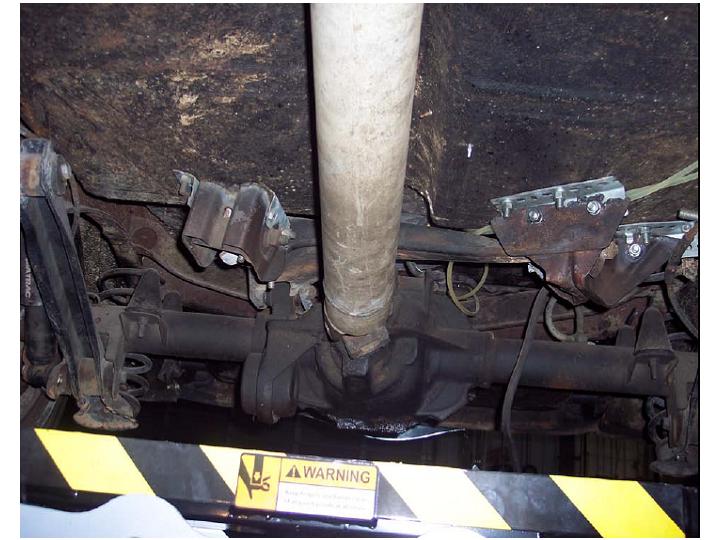

    The rear is definitely borderline criminal... springs held in with muffler clamps, upperlink bolted thru the floorpan and lower links held in place with one thru-bolt.. not much frame damage there.
    The front suspension can probably be knocked off with a 1/2# ballpeen once the the bolts are removed. I think I would consider removing the carnage and re-install some decent swapmeet pieces.... probably would be cheaper than taking the hit trying to sell it.

    Looking a little closer at the pics and the frame appears to be OK, as do the floors, front cross member is still intact, could be changed to a straight axle fairly easy.
    Rear shouldn't be a problem either, still lotsa work though.

    It would be fairly simple to fix the BS that the guy bolted to the frame,ect. Like I said before,you own it,why not make lemonade? You might even enjoy it while learning something. 1/2 the fun of owning is building and it would not take much to fix it. Use other guys take off parts which there are plenty of. You are not making a race car or show car. you want a decent driver that is safe. I am thinking for at most a couple of grand and time/hours,you will have a car that will be priceless in terms of memories,ect. Just my opinion but that was my 1st reaction when i saw the pics. there is nothing done to it that is not easily reversible. Not sure about the Aerostar engine and a new wire harness from Glenn here on the HAMB is about $150. Easier than you think,nothing overwhelming here even for one with not alot of experience.

    My advise would be to get rid of it. If you think the only problem is the ch***is you need to look again. How about the wiring, fuel line and many other things they could have F-d up scabbing this together. With the looks of the ch***is they had little skill level just enough to be dangerous and I'm betting that is what you'll find with the rest of the car.

    yeah, be glad that dumb*** didnt know how to weld at all...all that stuff can probably knocked off with a hammer, and the rest with a wrench. hellonwheels is right on about that ch***is being workable and strong. pull the body get rid of all that **** on the original ch***is. put a stock style front axle and an 8'' ford rear in it ,and drive it. it looks bad, but you can do most of this yourself. that is a very good starter project for you and your daughter. even if it take until the next summer it will be worth it. thats is a cool car when done in a traditional style. the builder watched to much monster garage, and had grand illusions that he's a fabricator. what an ***hat.

    To me that looks like a great project for you and your daughter.the body looks real solid as does the frame.If you have a guarge at you house ,you should tackle this yourself.shop rates will kill you.every bit of instruction you need is right here on the hamb.1934 fords will always be worth good money!You will be susprised how easy it is to lift that body of the frame.Do a search on here for help.If you are doing father daughter project,drag that thing home and start getting dirty togather.It makes no sence paying a shop for stuff you can do with your kid and learn as you go.A harbour freight mini grinder and jip cuts (And lots of GOOD safety gear) and you can cut all that junk off the frame in no time.You have a real diamond i the RUFF there ,GO for it.I do not think that you went to far wrong if you end up with a good 34 body and frame for $8000 + YOUR LABOUR(free)

    Thanks, folks! Oh yeah, my guardian angel was working overtime on that drive home- and when I put it on a 2 wheel car dolly to haul it to the next shop (should've used full car trailer, now that I see that rear- lucky nothing collapsed on me). Good to hear the frame can be used.
    I appreciate everyone's advice. I've got several grinders, a 220 stick welder and a 110AC mig welder- I've done some fab work, but nothing that's "life critical" like suspension. I'll have to do some more reading- getting the body off doesn't look too hard, welding up suspension mounts and fittings right will be more of a challenge for me. And y'all are right, the wiring for sure is junk (this guy is a commercial electrician but he used orange extension cord wiring to run back to taillights and maybe the fuel pump)- so I was already looking at doing a Painless wiring kit or similar. I'll check some places for stock axles and suspension. Man, I owe y'all some serious cold beer! now, just have to hope that I can sandblast or similar to the frame and underbody and don't find too many flaws in the body....

    WOW!!! its been a while since I have seen work that bad! Glad no one was injured behind the wheel of that. Its all fixable for sure, hopefully there is more people near you that can help mentor this project!

    You can do this. The frame looksgood. put the car up on jack stands,remove all junk this guy installed wihtout hurting the 34 frame. Look at what Pete&Jakes has for this car.They give you instruction on how to install everything.You have a lot experience people on the hamb that will walk you though this. Joe

    What a mess. I'd like to see who built that car to see if they are as f-ed up looking as there work. That frame could be rebuilt if you find some one with the right pieces or can fab them for you. Get a blueprint of the frame and start from there after ripping all that **** out. Or sell if you don't feel up to it. 34's bring good money if the body isn't hacked also.

    I have never seen anything like that in 30+ years of car building. Can't believe the rear end didn't rip right out.

    It's all fixable. I don't know what your skills are, so you'll have to decide what you can do vs what needs to be farmed out. The best picture by far is this one, with the "warning" sign.....

    First off, the guy who "put this car together", and I use that term LOOSELY, outta be held accountable for this ****! Pardon my language, but that's ****ing ******** and it's gonna get someone killed. If he thinks he can get away with this kind of ****, sooner or later, he's gonna off some other pile of dangerous on someone who won't be as lucky as you have or have the curiosity to even check.
    As far as fixing it, I'm with Hellonwheels here. Early fords are pretty simple machines and relatively easy to build. And don't fall into the common lie that you need to clip the frame to have a nice riding, well handling car. With some elbow-grease, good planning, patience, and a little luck you'll have a nice, safe ch***is for WELL under 10k. This site is chock full of great info, parts resources, and talented folks who are more than willing to help when you need it. Good luck! :cool:

    Take all the **** off the frame looks like it may still be usable..the front and rear cross members are still there so you should be able to throw an original styled front end on that crossmember and fix that rear end...ie correct brackets and what not.I just dont see you getting back the dough in that shape.
  28. The part I can't believe is that this thing actually drove anywhere!!!!
    Those welds are hideous. I wouldn't use a wheelbarrow if it had welds like that on it.
    All that aside ... if the frame is still good then I'd remove all that **** that has been bolted, welded, taped, or glued to it and install a parallel leaf kit in the rear and go with a Mustang II front crossmember kit (made for a 33-34) and install factory Mustang II parts (spindles, arms, brakes to keep the cost down) and get that thing back on the road. I have never EVER seen welds that bad PERIOD.
    Live and learn I guess. Anywho, parallel leafs are an easy install and so is the Mustang front crossmember. From the pics, the frame "looks" OK still.

    Yep, I'd be looking to go back to a straight front axle with a quickness. Do a rear as well and if you still feel that you want another car you can probably come out even at that point. You can do it. I'd rather see someone apprehensive about it tackle that job than someone who thinks they know it all. You'll do ok and there are plenty here to point you in the right direction. Get it in the garage and put her up on jackstands, pull off the front sheetmetal and start there...
