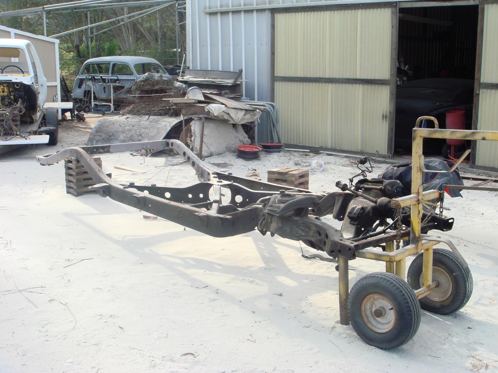

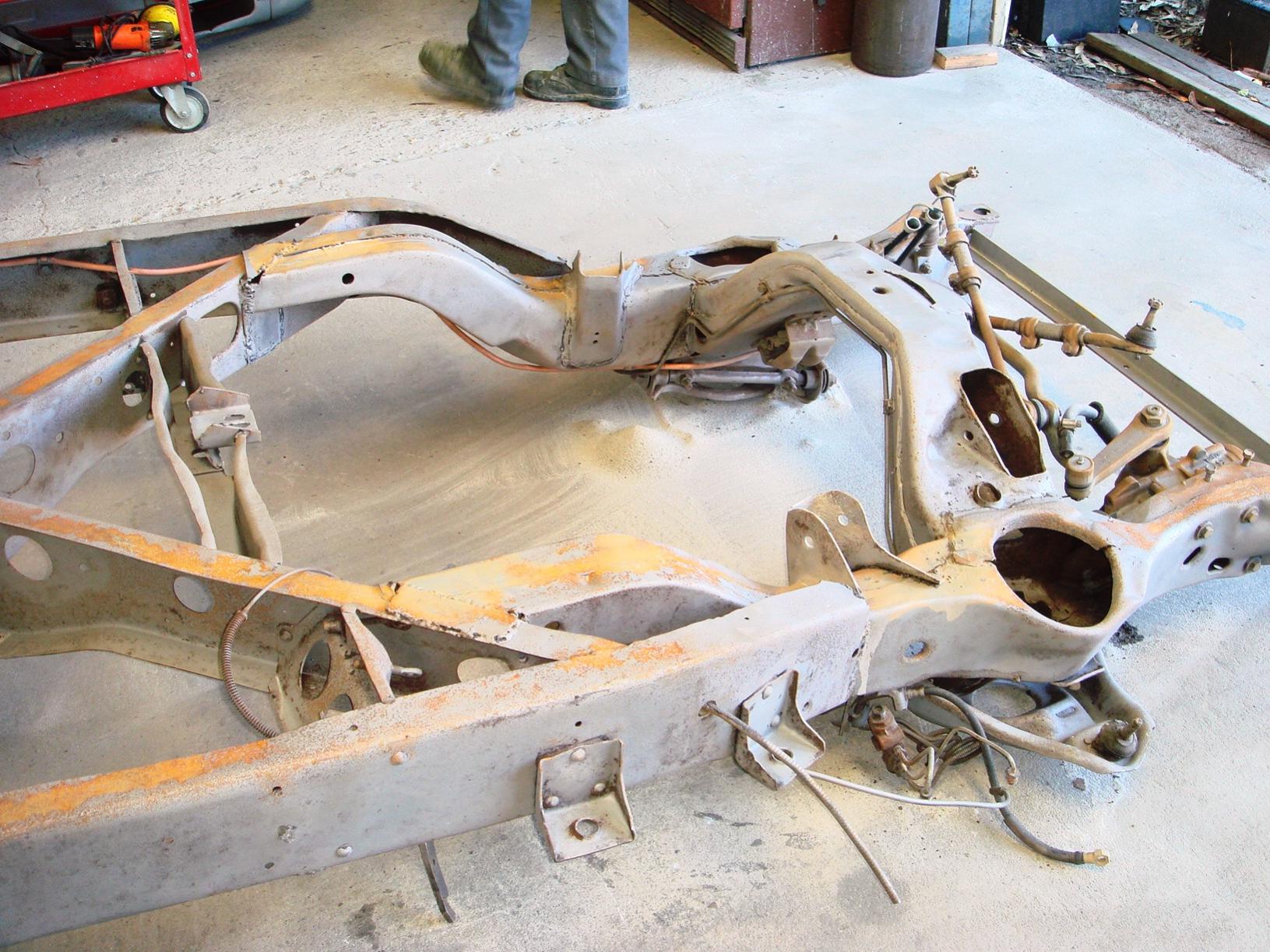

    Like others have said, you can and should fix it. It won't take that long once you get into it. You will learn alot about your car, and have gained a sence of pride for doing it yourself. I hope you fix it.

    Whats the problem?The original frame looks good. The guy did such a ****ty job that he didn't butcher it. The body looks to be in good condition judging by the fact the floor boards did not rip apart from the torque arms. I bet the jack *** left the original steering box in. So whats the problem? It doesn't take a rocket scientist to locate a used dropped straight axle and install it with hairpins. It's also pretty easy to buy and install a rear leaf spring kit for the rear axle. The engine probably needs a real set of motor and rear mounts. Not too difficult to install. Reuse the driveshaft and run the damn V6 until your ready to upgrade it. That V6 isn't the best motor but they always seemed to run forever.Then put in the wiring harness. If the new owner thinks he has the skills to install the wiring harness then he probably has the skills to handle the rest.This is not a hard job for a guy with average skills.Just a couple of weeks of reading,learning and elbow grease. If the interior and body are in good condition he will not lose any money and it will be a good project for him and his daughter. Oh, and as for the straight axle versus mustang II suspension, I have run them both on a 32/34 ford and found absolutely no difference in ride or handling. And I've driven em cross country.The real tradegy here is that he had a professional shop inspect it and they let him drive it away without warning him he was in real danger of killing himself. That and we still don't know the name of the butcher that did the work. He needs to be stopped now.

    ****, that aint bad, just don't throw money at it, work like a man with your hands , and LEARN, this is a project, build or mod another frame into something that
    car will fit on, go frome there, don't panic, it's not that bad of a job, stop looking at the cash or what was spent, that will screw you, just take it easy and think straight.
    yea you screwed up, but it aint as bad as it could be, i want to see that on the road by next year, on a frame that you built and i wan't to be safe. GET TO IT.

    yeah if you are in over your head with the skillset needed to repair it, then i'd sell it for a bona fide roller/runner, sorry about the whole "live and learn" thing-
    If you have friends that can help learn you up, then it looks like you could fix her for around 5 grand, and that includes a better engine.
    Probably not possible but if the builder was a shop, you could own them for every cent they ever make again just on liability alone...
    if you bought it from Shadetree Sam, then it's all down to a pre-purchase inspection/lack thereof.
    I wish you luck on getting a nice ride for you and your kiddo, and very glad neither of you got hurt in this thing.

    No one has talked specifics about the front end yet, so I'll start.
    If you do a stock-style suspension, the beauty of it is, HENRY FORD ALREADY DID THE HARD WORK FOR YOU. Much of it is factory bolt-on. Of course, I'm oversimplifying, you'll have to do some fab work since the stock center of the X-member was removed, so you either have to make a way to mount the wishbones (hairpins) to the center of the X-member (stock style), OR, mount them to the outside of the frame-rails (hot-rod style). Everything else, (spring and axle), takes care of itself geometry-wise because the front crossmember is still intact, if you use a 33/34 front end.
    And try to find original if you can. Many have suggested aftermarket, but OG is best in my opinion, for fit AND for re-sale value. If you try to use 35-40 Ford stuff as some suggested, your front wheels won't center up in your fenders. 33/34 is spring OVER axle, 35 and up is spring IN FRONT of axle, important distinction.
    Engine-wise, mounting a flathead would be the most simple, of course, since it will bolt in the stock location. Anything else will take some thought on making motor mounts, oil pan clearance, and getting the motor worked out between the radiator and the firewall. Not sure if the guy hacked out the fire wall for the mini-van motor, but thats a consideration too. If you kept that Aerostar 6 for now, you would just have to figure out the motor mounts.
    There are a TON of archived threads on any questions you'll have and a bunch of guys that will answer them if the threads don't. This site is the most amazing resource of knowledge, and community of experienced builders, so use it!! I have over the years and I can never repay what I have gained here.

    **** man if thats what the frame looks like I wonder whats under the paint. Boy the next time you buy a car inlist the help of a fellow HAMBer. Sorry it worked out like this.

    I'm with the rest of the guys who said take all the junk off the frame and start over. The basic frame looks good, it's all the trash the prev owner added to it. Buy the needed equipment and do it yourself. If you have to, take a welding cl*** at the local adult tech school. Buy a good used Miller or Lincoln welder and go at it. or talk the night school teacher into letting you do the frame as your project. I helped build aluminum and stainless tanks for an aluminum sail boat (another teachers project) to p*** advanced welding and metallurgy cl***. It's not majic, just a little training and then practice. Go for it! Good luck! Bob Lintner

    :eek:That builder ought to be arrested for that:eek:..
    after everyone on this board gets a chance to beat his ***..
    that is dangerous as hell.
    thank god you had a look at it before you put her behind the wheel.

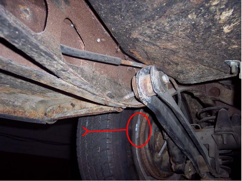

    really nice way to install a rear end, those control arms scare me, how they are attached to the frame
    well the original frame seems to look ok..its all the other **** hung on it and how he went about attaching important suspension members and a cobled up mess of things that are mostly secondary to structural integrity..
    I would get the body off, pull all the bull **** off the original frame and see what you have than..
    This is fixable, not pretty and maybe not cheap , and it depends alot on your skills and tools.
    get to the frame, and go from there.

    This was pretty common in the 60s. The frame actually looks pretty good to me once you cut all the junk off. It once was a common practice to fix stuff like this cheaply and easily. There were no aftermarket frames. The only thing tying the frame rails together in the middle was a piece of 3" channel iron bolted to the bottom rail flanges on my 34 P/U (same frame). You may not want to build a hotrod and that's fine but it can be saved by a do-it-yourselfer cheaper than buying an aftermarket frame.
    It's not drivable but very savable. You need to find a real old time hotrodder and not a modern parts ***embler that wants a 34 4dr to sell it to. I personally think it's worth what you paid for it as a project car but not as a driver.

    Ahh, **** wipes off. Strip it down, put out the word for what parts you want, you will be surprised what shows for free or really cheap. I mentioned to one of the guys that I needed a gearbox for a 53 Chevy truck and less than 2 hours later, he shows up with 2 of them. Find local rodders in your area, offer to help them with whatever skills you have, (A/C repairman, cableguy, carpentery, whatever) and trade off for their help. Your rod gets built and you make some great friends in the process. You might learn a lot and find your new calling in building hot rods. I built my own truck, which led to building a truck for a client and am finishing on the second client's truck right now. Get the daughter out there with you and teach her a thing or 2, then she won't have to rely on a guy to help her out with mechanics in the future.
