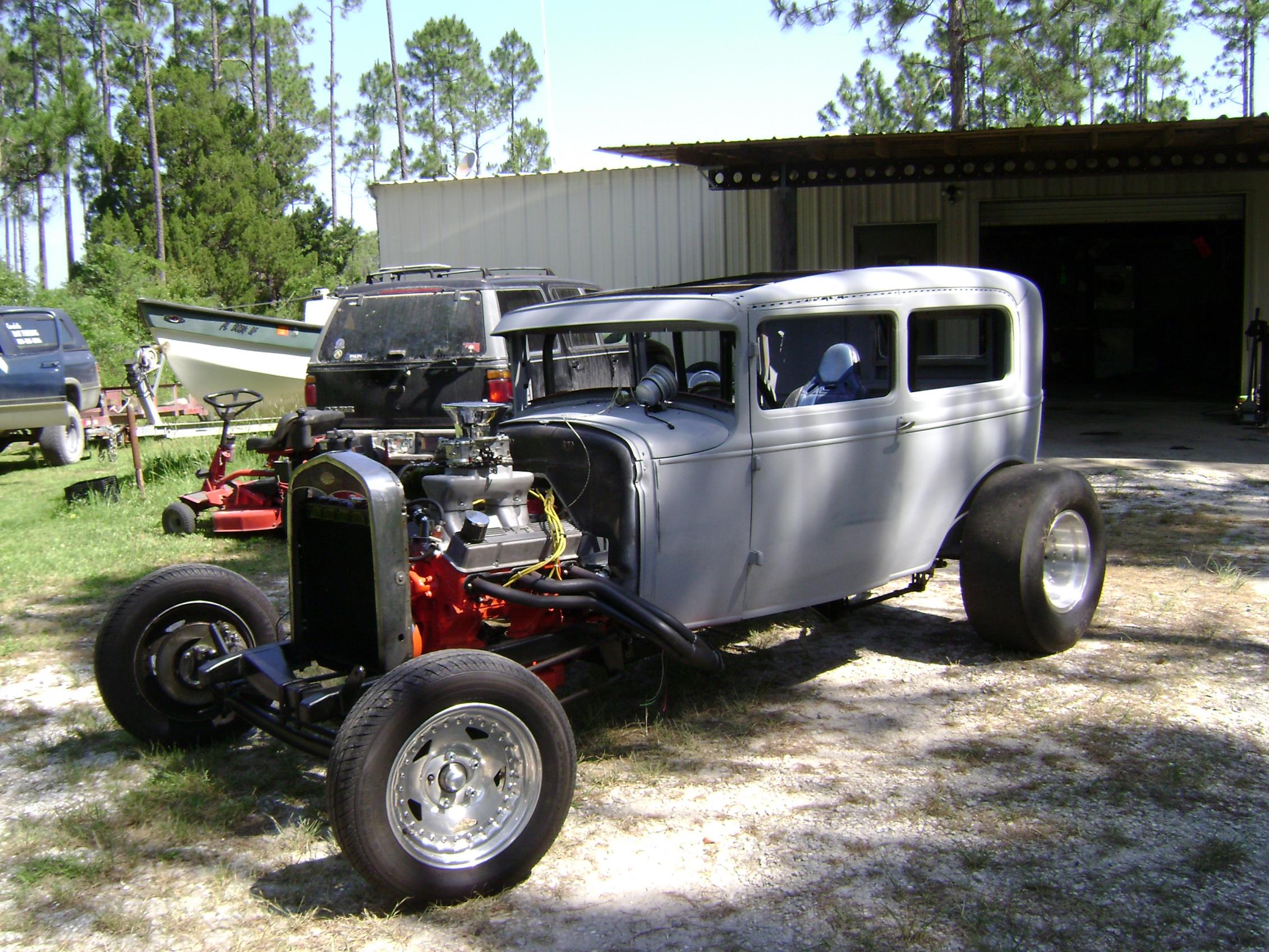

    The frame does look very solid. As said before, It is very fixable! The guy that built it should not be allowed anywhere near a car!!!! Knock all that hacked up ******** off and bolt in a straight axle. Its not hard to put in... 33,34 axles are not that expencive at the swapmeet ( Carlise and Hershy coming up soon). Have your shop set up a rear axle if your not comfortable with that??? Take your time... Ask questions and everything will be cool!!

    For the record, I never suggested taking the body off of the frame, I think that would only prolong getting the project on the road. If the body came off the frame, then you might as well strip the paint, then fix the rust, then... You get the idea, it would be starting from scratch, which was never the intention if I have read correctly. Besides, the frame and suspension can be addressed with the body on pretty easily, as has been mentioned.
    Sounds like you are going to bite it off and give it a shot. I wish you the best of luck, there is a lot of good advice here. Doing this kind of work is never easy, but ALWAYS rewarding.

    yes its a hack job from hell but it is very fixable. and if you can do the work yourself you will save a bunch of money (im sure this has been said many times already in this thread, i only read the first page)

    my mouth dropped more with every picture.... but it does look like the original frame is ok, just take out the added on stuff and put the stock suspension back in.

    After looking at the pictures, I tend to agree with the guys who are suggesting legal action against the guy who sold this "car" to you.

    There are two, distinct, schools of thought here. One is dump it and run. The other is, it is fixable. It is absolutely fixable. Many have done far better with far less to start with. If he is not a car guy, now is the time to learn. Early Fords are the most basic car ever built. You may have cut your teeth on a wrench or you may be 50 and never even seen one. It doesn't matter. Put on your grubby clothes and dive in. There are resources here and "out there". Read some magazines. Go to some shows. Ask questions. Send for every catalog available. Educate yourself. Learn some skills, you might just love the grease, blood and pain.

    Replacing the frame with another ch***is might be the easiest thing to do. However, keep in mind that the frame under your car likely has the serial numbers that match the ***le. Another frame and you're going to lose the only factory ID numbers on your car which may cause problems later. Your frame looks savable anyway.

    One more to get on the you can fix it band wagon. Leave the body on; pull the front sheetmetal and start unbolting and grinding. You will be pleasantly suprised how much better it will look. Then you can take an honest look at what you got to start with. Looks VERY good to me. Search 33-34 on the HAMB and you will see that a lotta guys have started with worse. After studying your pics, this looks like a week-end project, with a Sawzall and grinder.

    Carl La Fong is right on the money.I have seen some cars this bad,maybe not worst but just as bad.My brothers old t bucket had 2x4 wood blocks holding the rear suspenion in[no my brother did not build it] and they fell out while i was driving it.Luckly i wasnt going too fast.Another friend had an OT vega that he drove on the street that was a drag car running 9.90 The steering shaft was held in place with a Craftsman wrench that was heated and bent and then welded to the frame.He drove that car a long time on the street.What i am trying to say is everyone has a way of doing things they think is right.You car is worth the money you paid for just the body and bare frame as others have said.Fix this car with some good help and you will have the pride of knowing it was repaired the right way.

    It's not driveable now, it's not saleable now either if you have a conscience, which seems to be the case. Don't pull the body off, pull the sheet metal forward of the firewall and remove everything that's not '34 Ford. Remove the "rear suspension", and, like so many others are saying, get some early Ford running gear back under that frame. Solid axles and buggy springs. Sell the Aerostar motor/ trans/ rear end and put the procedes towards '34 parts. It can be done inexpensively. If you're not an accomplished welder, and it needs wishbone brackets or whatever welded, have someone else do it. Once it's a roller again, take a step back and reevaluate. If you still have enthusiasm for the project, continue. If not, at least it's saleable with the early Ford running gear safely under it. Good luck, I think you can do it.

    Just remember you'll get basically nothing for it should you sell it. That loss will be far greater then what it will cost to get this on the road.
    Another option to consider is to look for a late model cheap beater for your daughter and slowlyl do this over a couple of years. She'll less likely crash it and it will be an awesome project as you go.

    Don"t throw your money away into all the speedway parts,at this point the rolling ch***is is your best deal,sell the van engine and you might get a few bucks out of the frame after stripping it. You should be able to pickup a descent engine and ****** for what you get out of the van engine and bare frame.In the future dude one thing you have to remember,look at what you are buying cause this deal you basically screwed yourself,And definitly don"t forget to post this idiots name!!!!!!!!!
