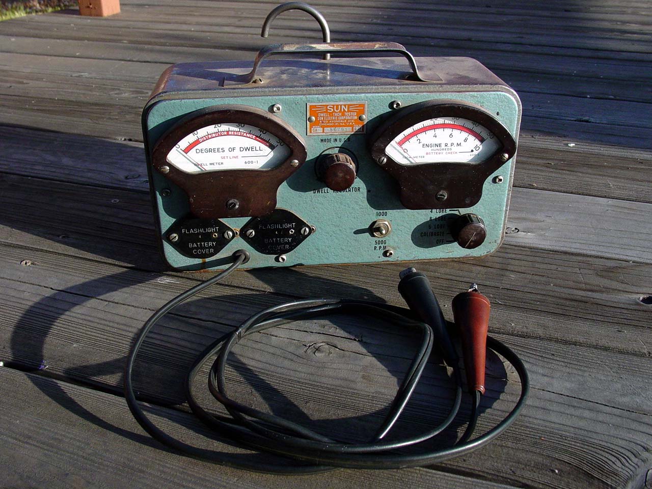

    Here is my modest Sun Dwell-Tach Tester.
    Had to replace and calibrate a couple of capacitors, but its 100% accurate and working now.
    Runs on 2x 1.5 V Size D batteries.
    I also have two Sun Tachs with senders in both my rides from 1947.
    Same battery size and also needed the capacitors calibrated and a 50 Ω resistor to convert to 12V.
