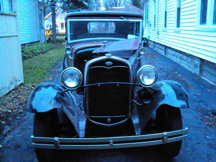

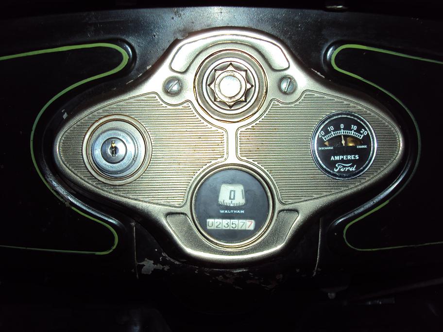

    got it home today and took some pictures. sorry they are ****py... the light was odd... anyhow, check out the miles on the odometer.... i wonder if that is correct... wishful thinking. the fenders need some work as do a few other small things. work out the bugs then get her on the road. thanks again guys for all of the info.

    sorry... here is the odometer pic

    Just now saw the updated pictures.
    The indented firewall on the car dates it to the 2nd half of 1931. The carb is technically "wrong" for that setup but will work as shown.
    Looks to be in pretty good condition, probably a 60's or 70's restoration (based on the interior). Hope you got it running and have been able to play with it.
    -Tim

    Based on the fact that the firewall and gas tank are black, I'm going to guess that was the original color. One of the five color options for a vicky was black with apple green pinstripe, it is possible that the stripe on the face of the tank is original but it looks a little too thick, originally the tank was 1/16" wide on the gas tank.
