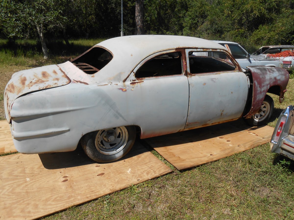

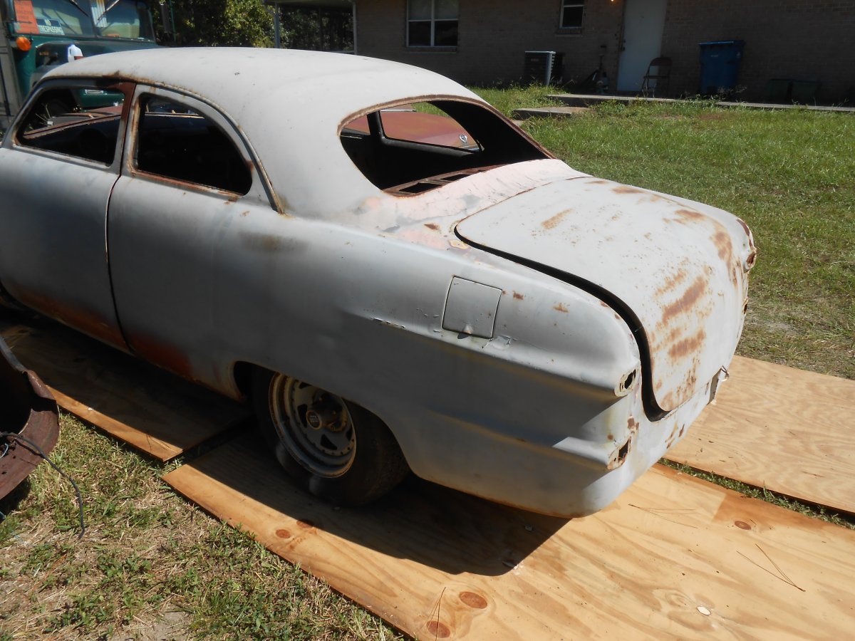

    Holy cow! it WORKED!! Thank you Ray! That is the hulk as it came off the trailer today.Here is another view.I have gotten the front clip off,cleaned the interior out and gotten all the body mount bolts out.Tomorrow I will lift the body off. DSCN0944.JPG

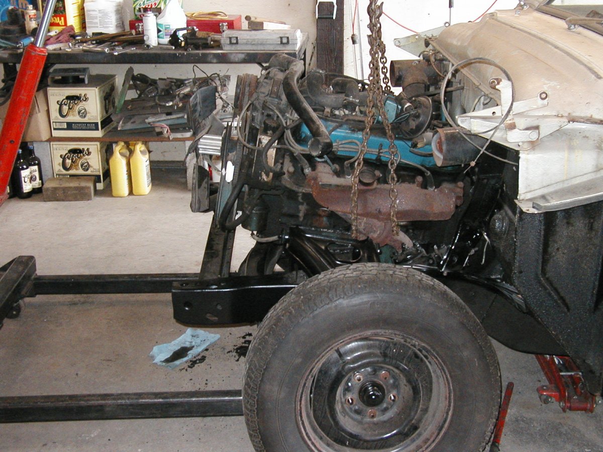

  7. I wish you better luck with your Caddy conversion than I had. Here are some photos of me trying to get a 472/turbo 400 in my 51. I didn't want to cut into my Firewall and the bottom crank pulley was ahead of my Core support mount with motor tight against the Firewall. I won't say it can't be done just that I didn't want to do that much work .

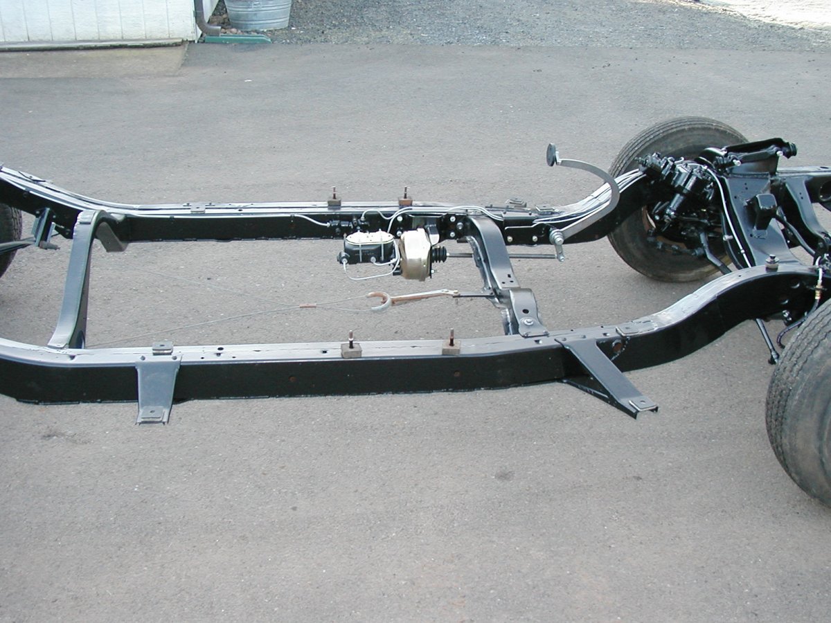

  17. 51 Project 011.jpg Not sure if you removed the front seat runners from the floor or not. On my 51 the seat bolts go into the frame not just the floor pan. Make sure you take the runners off other than that it should come up. Here is a photo of my 51 frame with the body off. Maybe it will help. Those 4 studs standing up are actually the seat mount studs and body mounts.

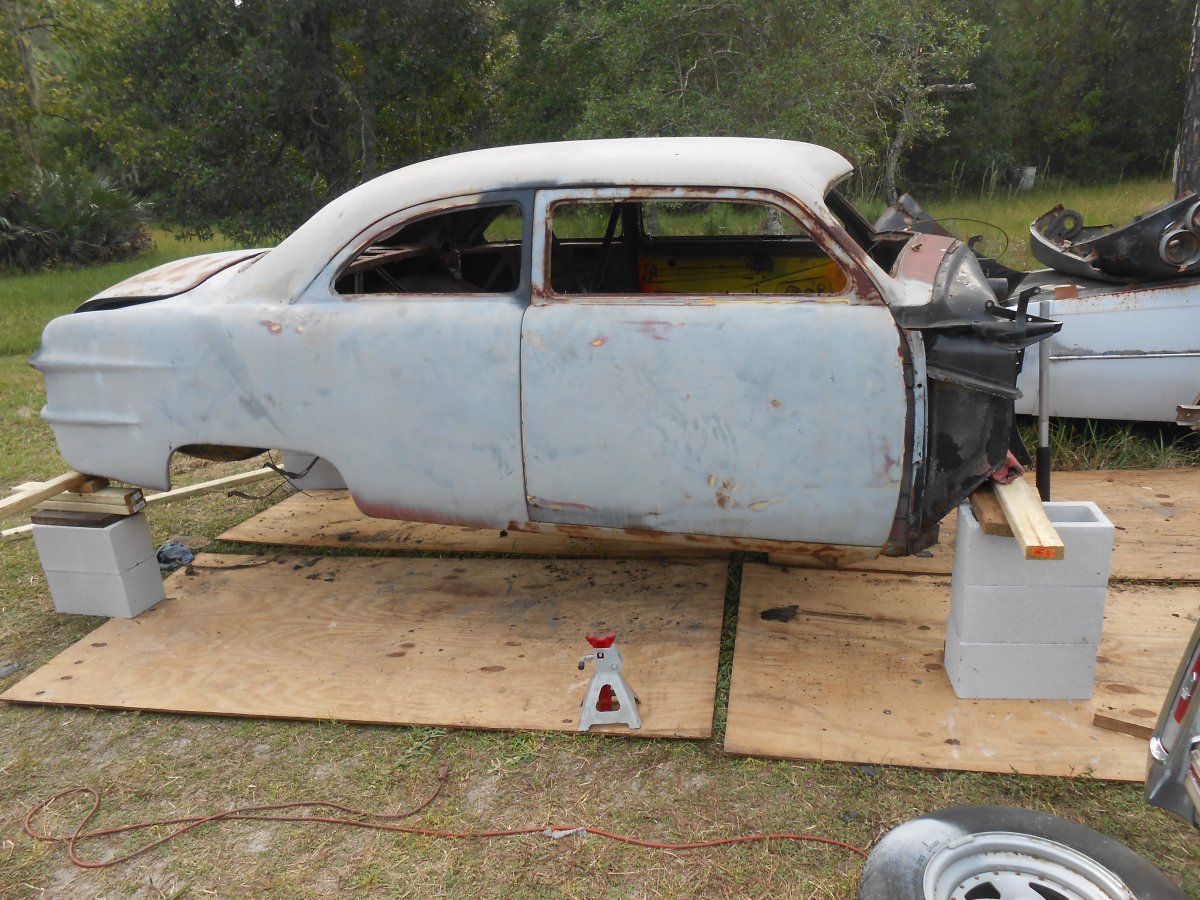

    Got the body off! Some one had welded the floorpan to the frame under an old floor repair---?? DSCN0951.JPG

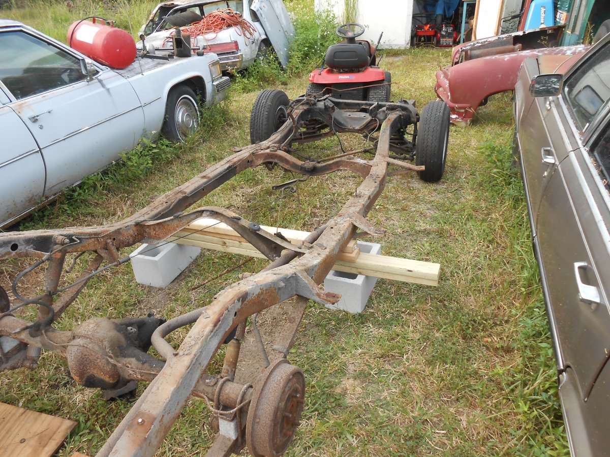

    DSCN0953.JPG And the frame.Lots of cleaning ahead!

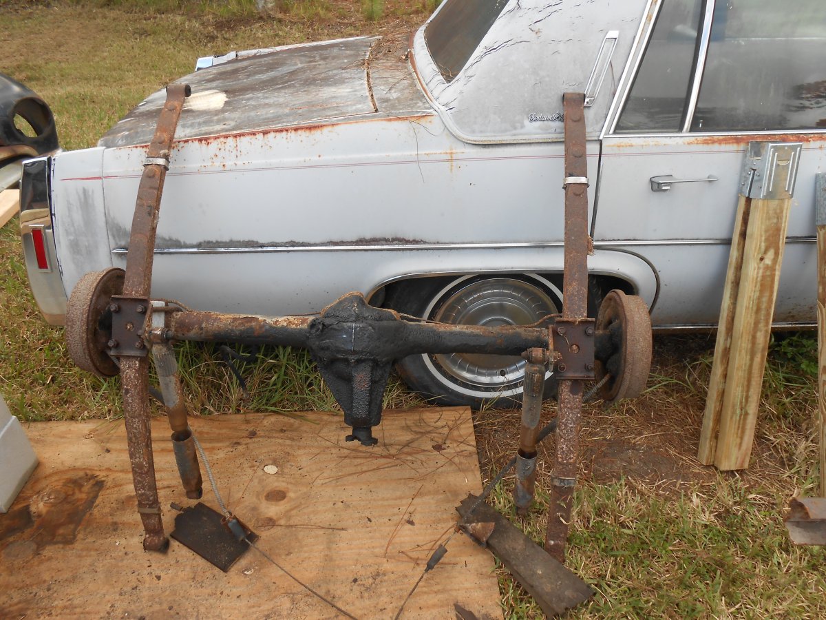

    DSCN0954.JPG Got the rear end off the frame ,then fried the portable air compressor motor.I will get the rear apart tomorrow and see if it is worth repairing.

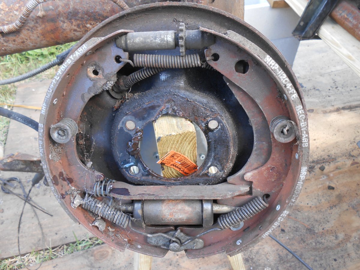

    Thanks for the info guys.I got the brakes\suspension off today and took the rear end apart.Got all the brake parts on the way.For some reason the brake shoes are new-in with the junk brake parts?? And the front wheel bearings and seals are new ,how odd.I am trying to find DSCN0956.JPG someone local who could blast the frame.I can do it by hand but it will take some long time!

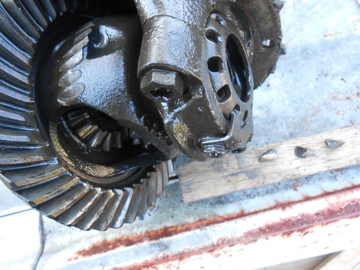

    I took the rear end the rest of the way apart today.It is a 4:10 and the ring and pinion are both bad.How anyone broke that rear end with a flathead ford 6 I don't know.I have broken a couple with slicks and heavily modified Y blocks but never with a flathead 6! Finnrodder I may well go to a different rear,I have a fresh 8.5" 10 bolt but it is a 4:11.Not sure what I am doing at this point.Spent the day cleaning,priming and painting brake and suspension parts.That is going to be going on for a LONG time.My current plan is to get the chassis finished,engine mounted and then work out the body.The bad rear will just make it take a little longer.Note broken teeth on piece of wood at bottom. DSCN0959.JPG
