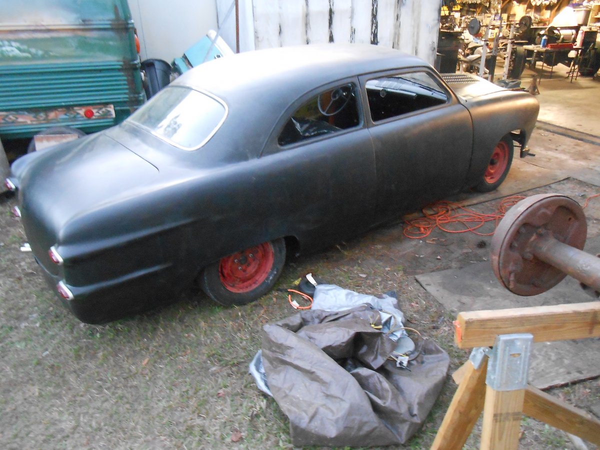

    Set the hood on and stood back and looked at the thing.It is starting to resemble a car some. DSCN1195.JPG

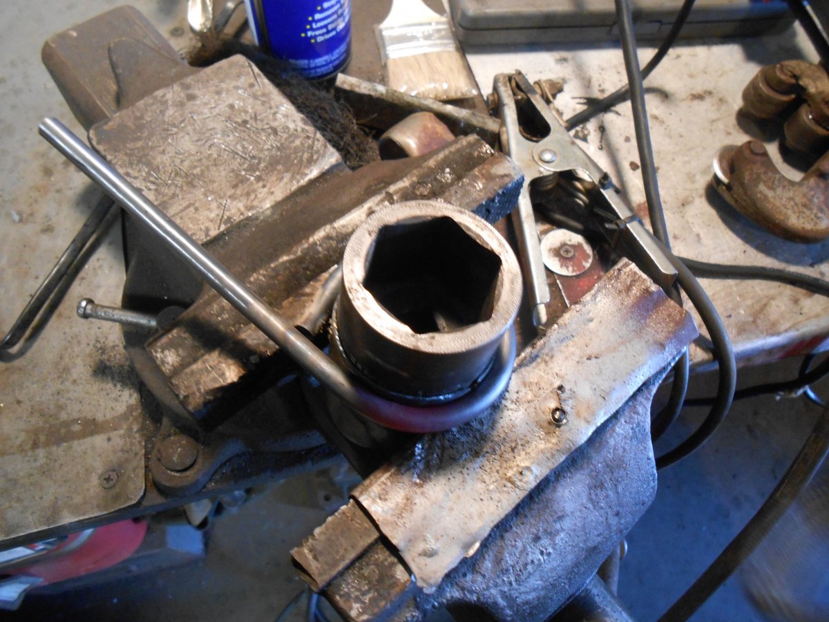

    I made a try at some bezels today.Not right,but the idea is sound.I just need to change materials.I tried a short piece of tubing that fit over the exh pipes with a piece of 1\4" round stock wrapped around it and welded to form the bezel.Problem is the steel doesnt conform easily DSCN1201.JPG DSCN1205.JPG [ATTACH= to the curve in the pan.I believe I will make another set using copper tubing.I can bend this to comform exactly and solder it to the tailpipe itself.

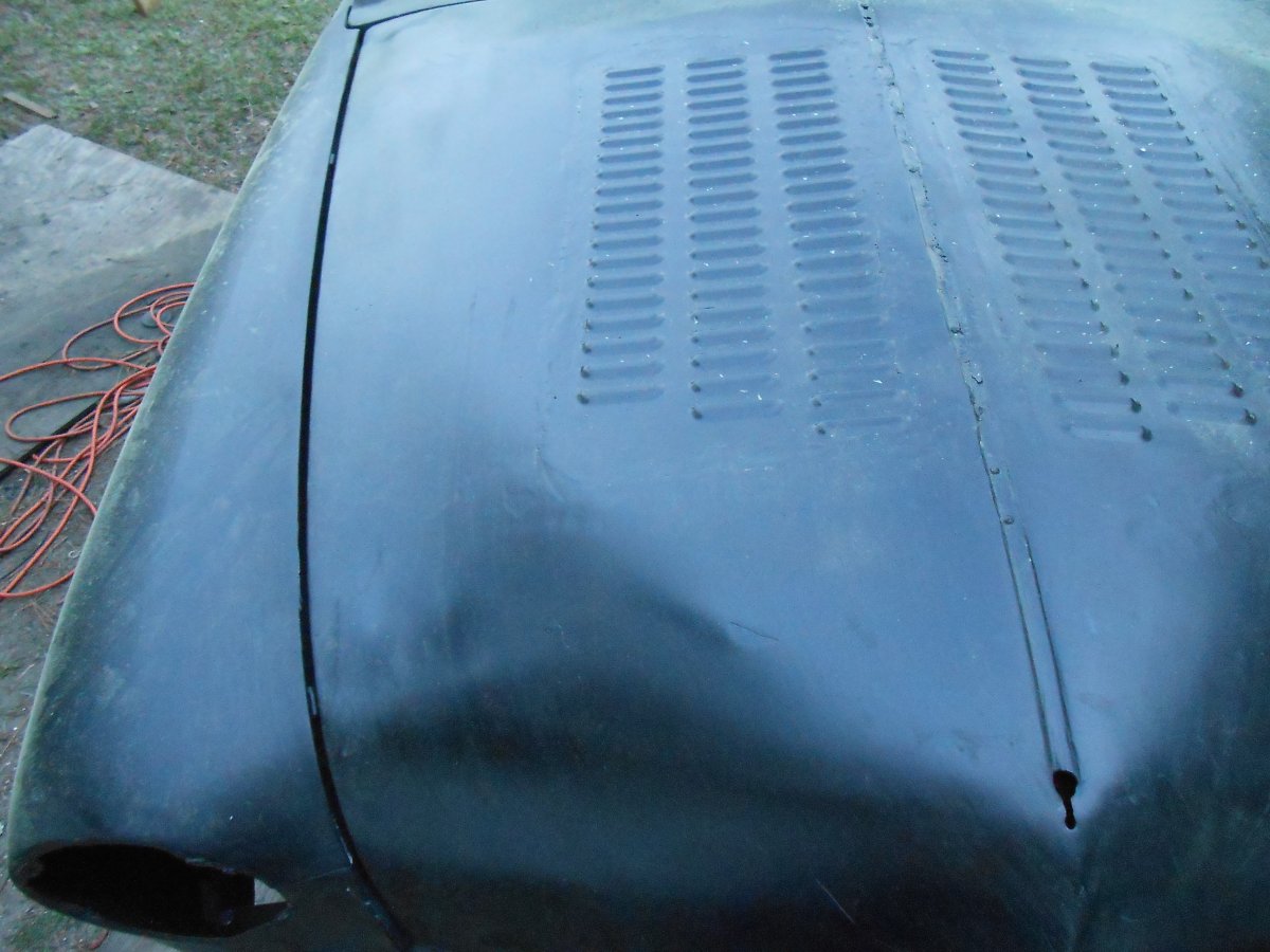

    Here are a couple of pictures of my hood problem.The hood is adjusted as far forward as it will go.Any input on how to fix this DSCN1208.JPG DSCN1209.JPG is appreciated.
  12. With all the repairs you've done on everything getting Good fit lines can be a real Challenge. First is to get Doors to Quarter gap even top to bottom (below window line). Next is go to Fender to door and set proper alignment. One thing that can happen is have good Door to Fender line and still have the Core support to low and not even know it. I know you built most of the front support system by hand. Not picking on it but as you're learning it isn't always a finger snap and move on. So back to your Hood. It is very easy with a low front fender mount to Over Close the hood. This will tuck the front hood corners back and end up behind the fender corner, it will also open the Gap between rear edge of Hood and the Cowell ridge. Lifting the Hood some will close that Gap and extend the front hood corners. If I remember correct you did a fair amount of welding on top of your hood.. Things move around and it don't take much. If everything seems to be correct your Fix may be just as easy as pulling forward on the Hood Corners and moving them into place. I'm not suggesting just yet but it's an option after everything else is adjusted the best you can. To go along with fit, the inner fender panels have a impact on hood to fender fit. That is where you open or close the front to back gap fit. It also changes the over all length of said Fender.

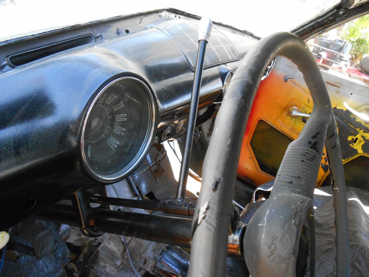

    I got my shift linkage made up and on the car.It actually was pretty simple,( DSCN1210.JPG DSCN1211.JPG I am sure something will go wrong now I have said that)Top pic is the shaft(1\2" OD heavy wall tubing) and the shift arm which is 1\4" X 1".Second pic is the shift lever on the shaft.I made the sleeve out of a piece of an old rifle barrel and drilled and tapped it for 2 10-32 set screws.The lever is another piece of 1\2" tubing.The shift knob is just made out of a piece of 1" aluminum s****.To my amazement the whole thing works just fine.Here it is in "park" position.You can see the set screw holes in the sleeve. DSCN1212.JPG

    And here is the pic of the linkage under the hood.The rod from the arm to the trans is 0-1 so even in its annealed state it is stiff enough I dont have to worry about it bending or losing is shape.All I really have left to do there is find or make a somewhat more presentable clamp for the column and bottom support bracket. DSCN1213.JPG

    Antti that is the automatic column,at least I ***ume it is.It came out of my 51 parts car which was an automatic.All it had on it was the little bracket at the top that the shift shaft fits into now.???

    Kurt,thats a manual column,but looks like someone have converted it to work with the automatic ******.I had that column too when i bought the car and that column was also converted for automatic transmission.Here is a pic of my automatic column,that i bought later:
  19. Stinage. That is a stick shift jacket your working with. The Auto jacket Finnrodder posted has a special feature that's quite necessary. It's called an Index Detent. That's what hold's the lever in the selected gear position. I know what your thinking, the Valve Body has a gear detent, I don't need any stock unit. Well you might be right 95 percent of the time. It's the other 5 percent that get's ya. What you built has weight and leverage just hanging there waiting for a good harsh dip in the road at speed or a large enough (who knows how big that is going to be) Pot Hole to make that thing shift by itself. It's really a Fu---ed up event to go into Low gear at 60 miles an hour because IF you realise what just happened you will most certainly shove it into Reverse. Take that info as you like, no Knock of your work intended however at this time I'll p*** on going for a Ride with you.

    Antti,PNB thank you both very much for the info. I didnt have anything for comparison and just ***umed that since it came out of an AT car----.I believe I will make a ball and spring detent to help hold the shifter in the "drive" position.I will post pictures of what I come up with.Thanks again,Kurt.

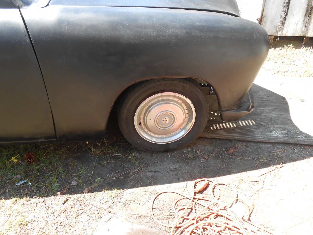

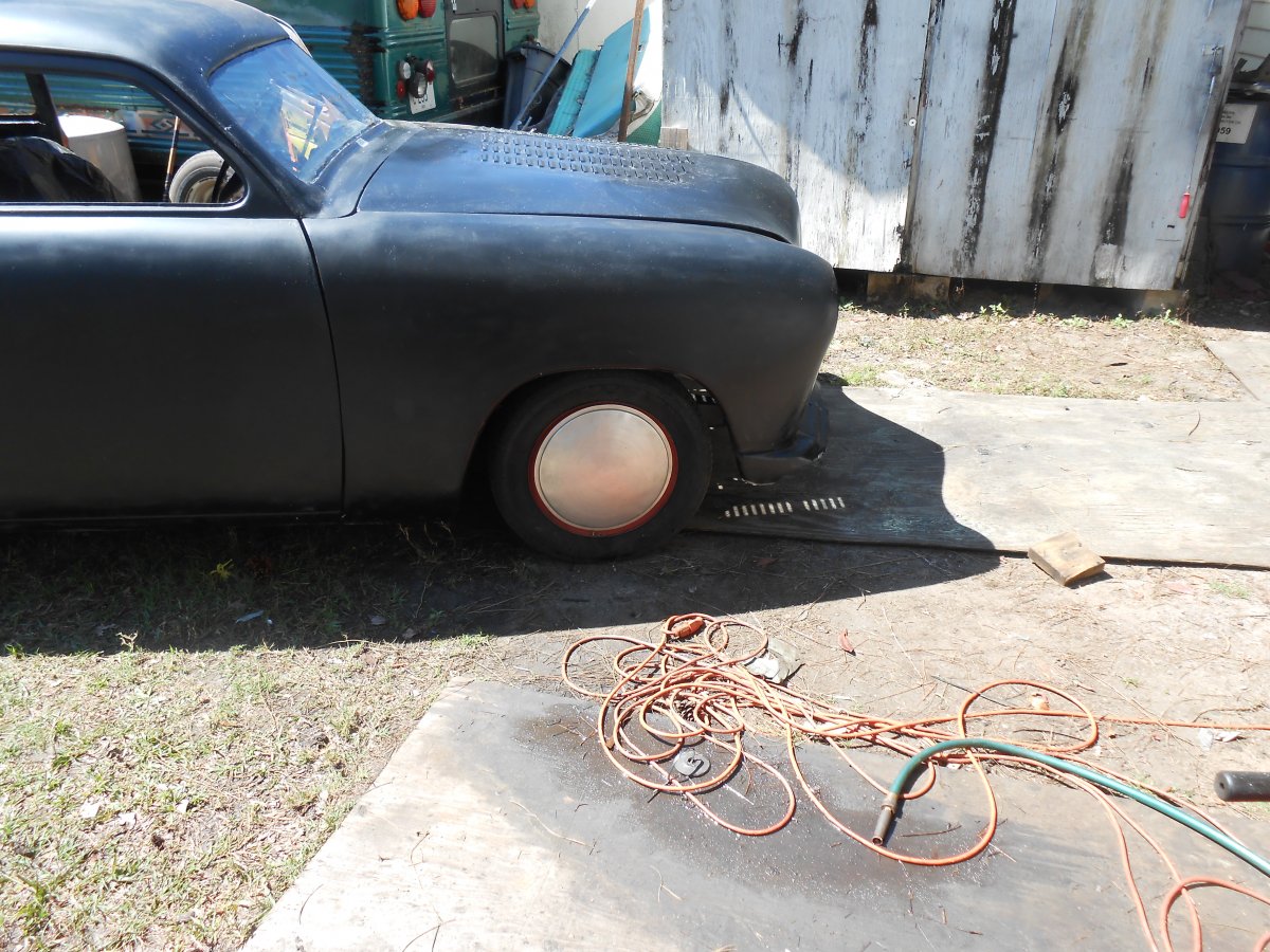

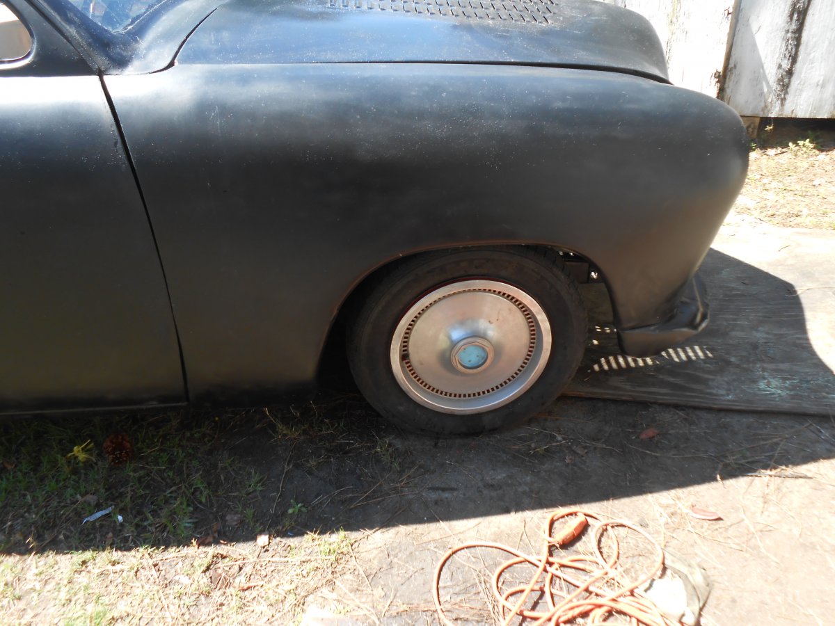

    I was fooling around today with some different hubcaps and wondered if anyone else had an opinion on what to use and why DSCN1214.JPG DSCN1215.JPG DSCN1216.JPG .I think I have more in one of the sheds ,I will look tomorrow.
  22. voodookustoms
    Joined: Aug 25, 2009
    Posts: 650
    voodookustoms
    I'm personally not a fan of any of those. Some spider caps with beauty rings would look good. Or single bar spinners? Lancer caps always look good on everything.
