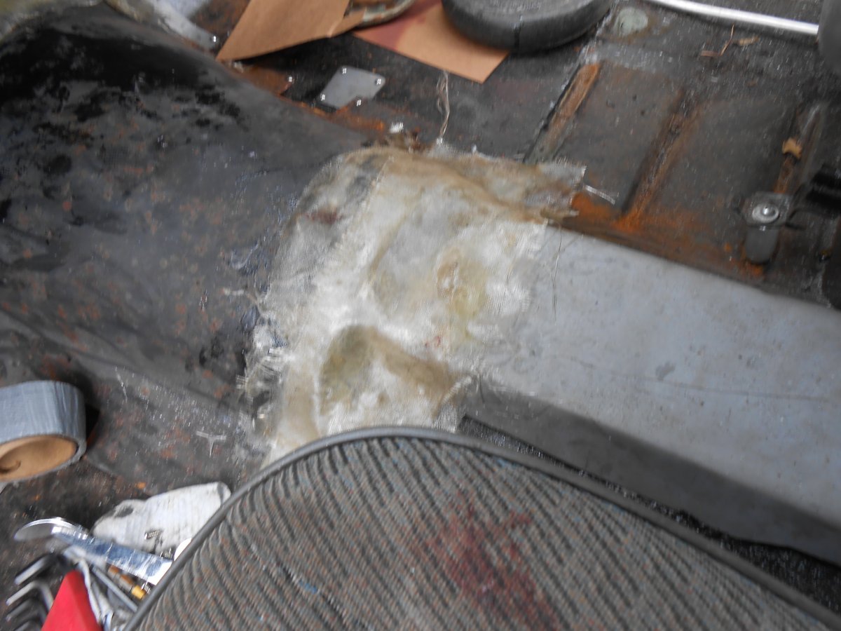

    I have been worrying over the two pieces I need to make to finish off the trans\driveshaft tunnel.If you look at the pictures you can see they are rather complex shapes.In any case WAY beyond my sheet metal skills! It occurred to me today that I can make those small panels out of fiberglass! It will all end up under the sound deadener anyhow.went and got some cloth and resin yesterday,we will see!

    Got the glass laid in today,its ugly! Fortunately it will look better when I get it trimmed up.(and better yet when covered with insulation) DSCN1322.JPG DSCN1320.JPG DSCN1320.JPG I have duct tape under it so it will lift right off.The glass is six layers thick and feels plenty rigid.I am right glad to have the floor closed up.

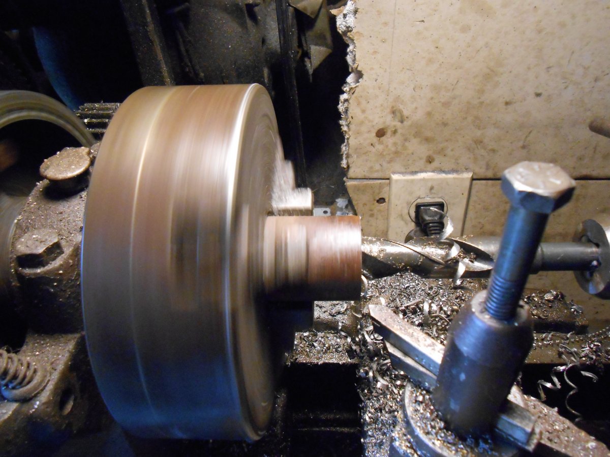

    Got up early today and worked on the Ford.I got the fiberglass pieces trimmed,cleaned and vacumned the floors and sprayed them with truck bed coating.I also made a bunch of sleeves to protect the wiring going through the firewall,painted and cleaned up a bunch of little things I had made under the hood-brackets and such.I have had an ongoing problem with the steering wheel in that car.I got the steering box,shaft and column out of my 51 parts car.The steering wheel came with the pile of stuff I got when I bought the 50 in the first place.The problem is that the shoulder on the back of the wheel that evidently should fit into the expanded end of the column is about 1\16" of an inch from the end of the column when the nut is fully tightened.Also the OD of the shoulder is 1.250" while the ID of the end of the column is 1.437".I ended up turning a piece of 1 1\2" stock to make a sort of adaptor which worked out just fine.Does anyone know what year Ford this steering wheel came from? I know it is 51 or later but thats all. DSCN1323.JPG DSCN1324.JPG 000000 DSCN1325.JPG DSCN1327.JPG DSCN1328.JPG
