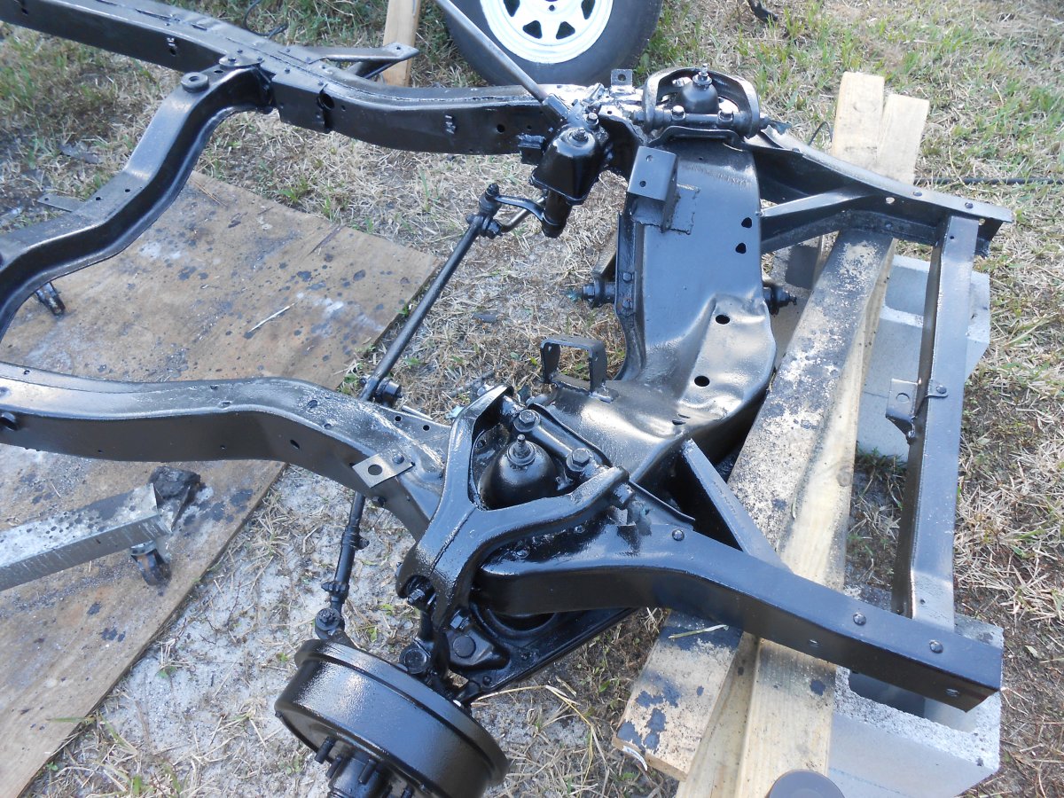

    DSCN0966.JPG Actually got the frame done today! I am glad to be done with this part.Now I can start on something more interesting.I have POR all over me,but gasoline and a brush gets it off :) I found a 3rd member,still hunting a steering box.

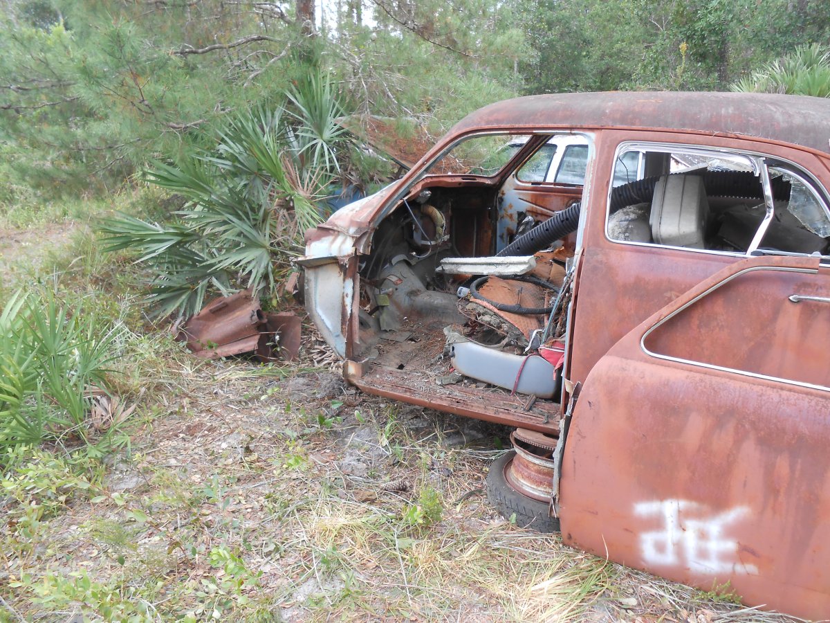

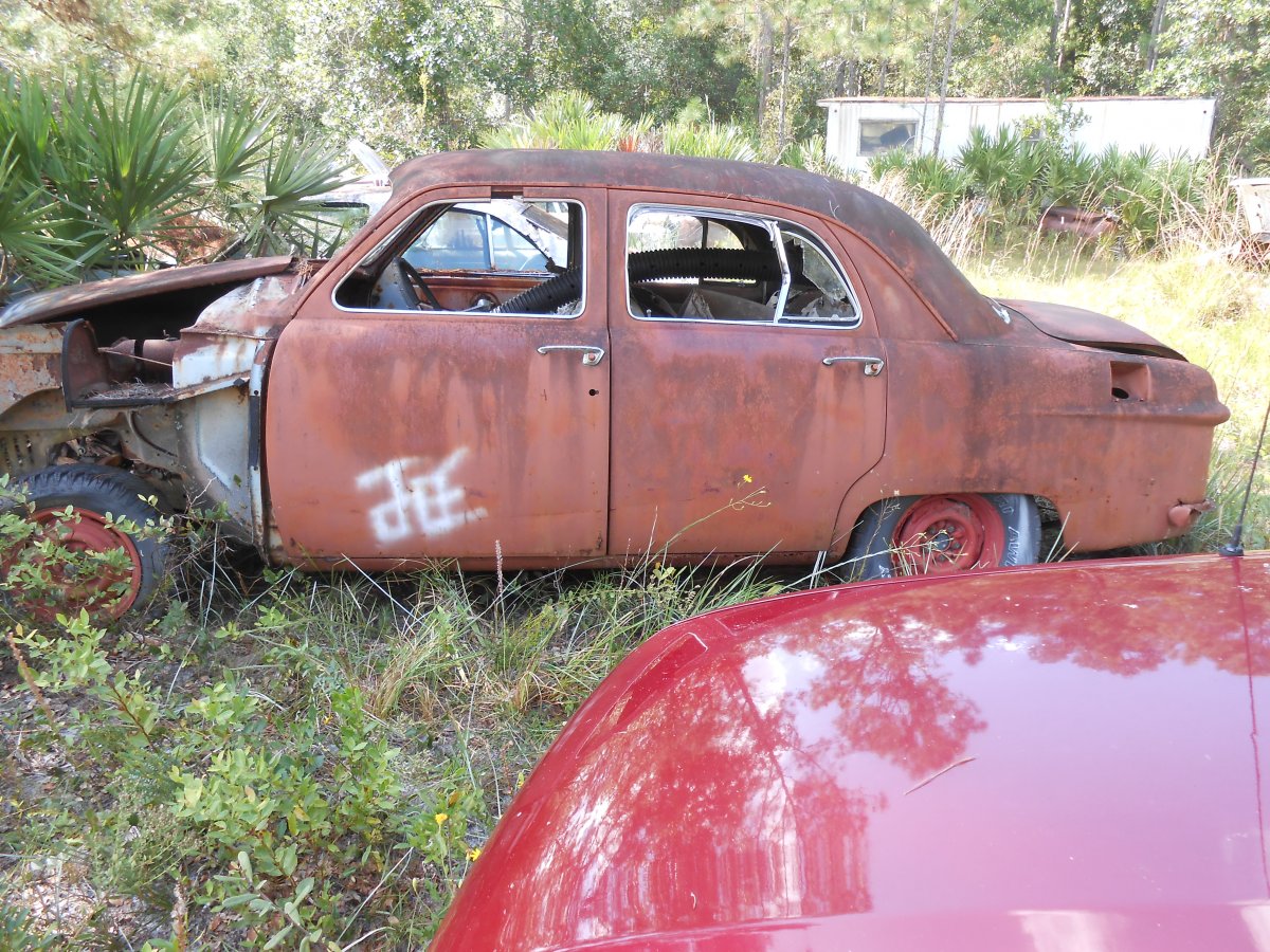

    I bought a parts car today.150 bucks for a badly rusted 51 four door.It has everything I need to get the 50 rolling and steering and a lot of other stuff besides. Good steering box,shaft and column,good rear end,complete front end(spares are good!)ETC.This should speed things up considerably.

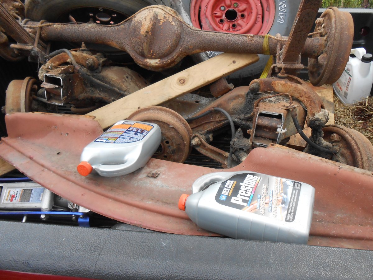

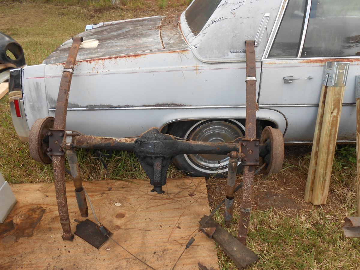

    Went over today with a generator and cutoff tools,got the front end off,rear end out and one door off.I will go back and get the rest of the sheetmetal in a few days. Long,hot day! DSCN0971.JPG

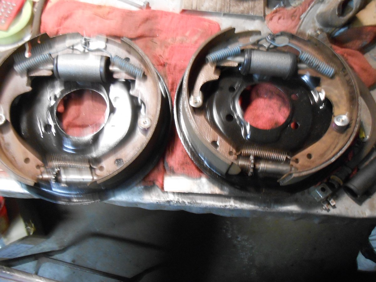

    Hot day today.I stayed in the air conditioned part of the garage and finished rebuilding the brakes and dis***embled and cleaned the new steering box.It looks real good.Tomorrow I will get the rear apart and see if it needs anything but gaskets and bearings. DSCN0977.JPG

    Worked on cleaning up the rear end from the parts car until it started raining on me.I should have taken a "before" pic.I have never seen one quite so heavily encrusted!

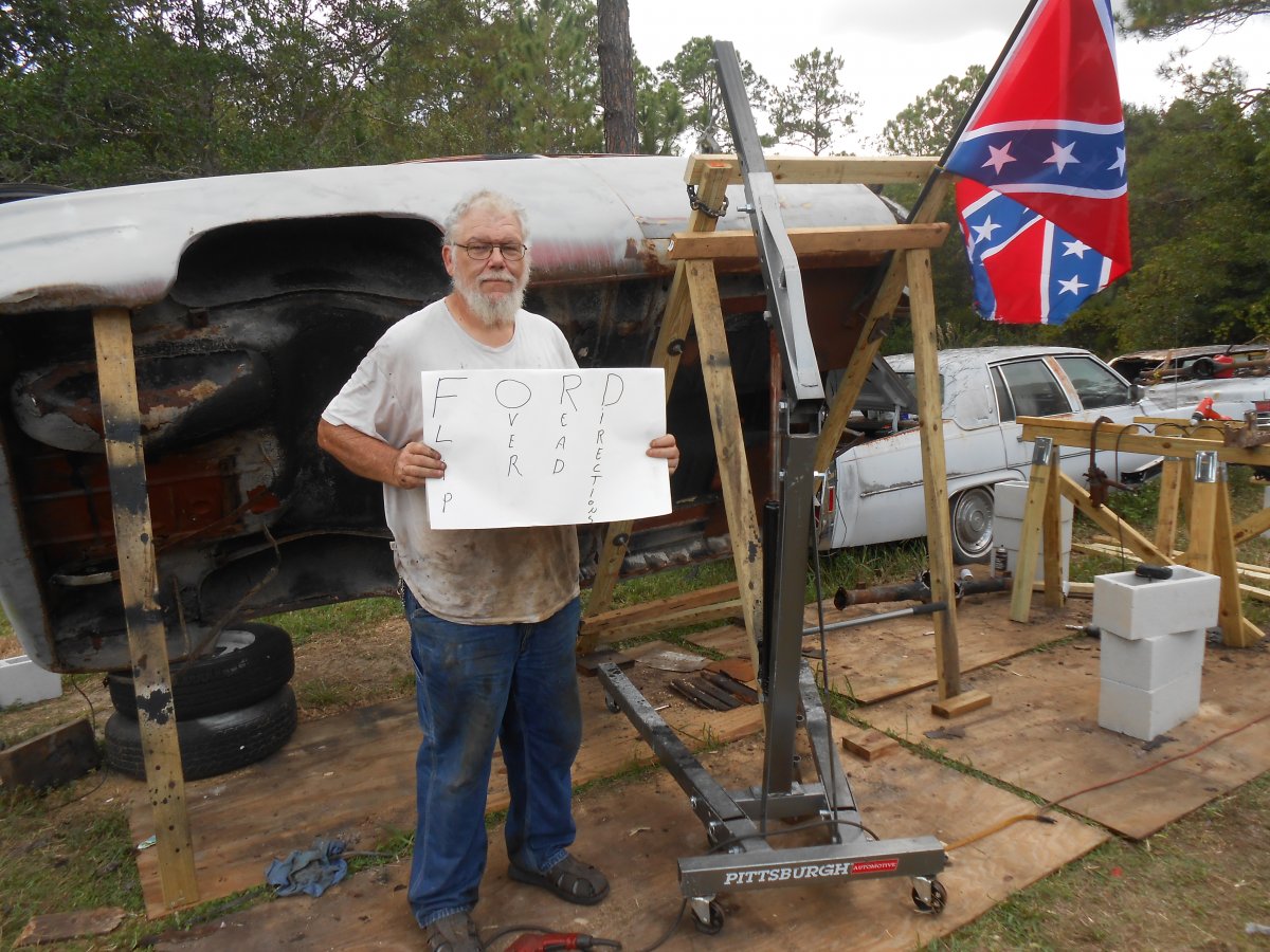

    Well,I got the body up on the redneck rotisserie today.This actually works just fine and costs 25-50 bucks depending on how many 2x4s you already had.just work down until you get to the middle,then Flip Over and Read Directions ;)Before anyone asks the body is x braced and cross braced inside. DSCN0983.JPG
  28. Finnrodder
    Joined: Oct 18, 2009
    Posts: 2,971
    Finnrodder
    from Finland
    Thats a bit cheaper than mine,i spent few hundred for the rotisserie project...
    It sure does make life easier when working with the body.Keep it up!

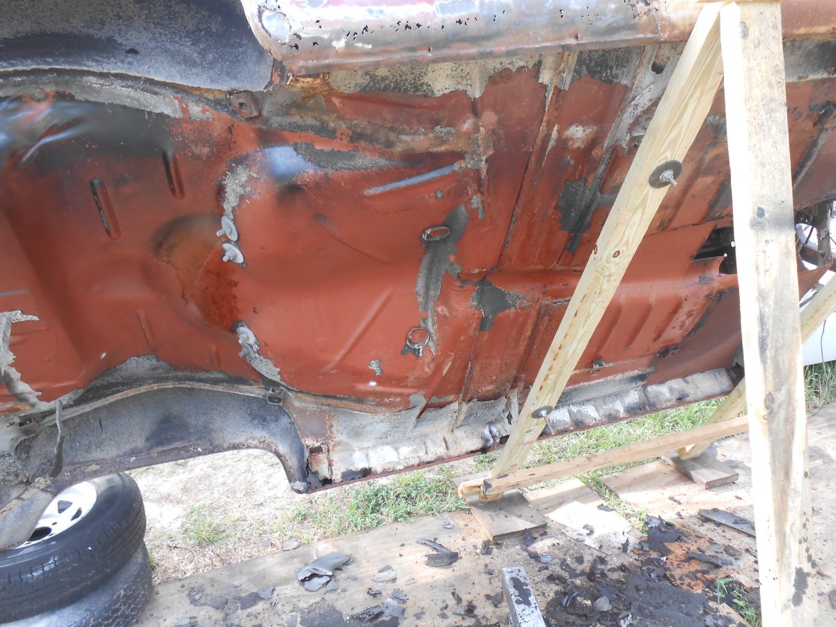

    I started s****ing undercoat today. To my utter amazement it mostly came right off!This pic is after about an hours work. DSCN0986.JPG

    Note the row of holes from the rear of the new rocker panels(PO install) to the front of the rear wheel well in the above photo.I took the whiz wheel and cut that out,lots of old bondo ,a dead window winder handle and a LOT of dirt came out of this hole.I cleaned it all out with the little sandblaster DSCN0989.JPG and coated the inside heavily with por 15.
