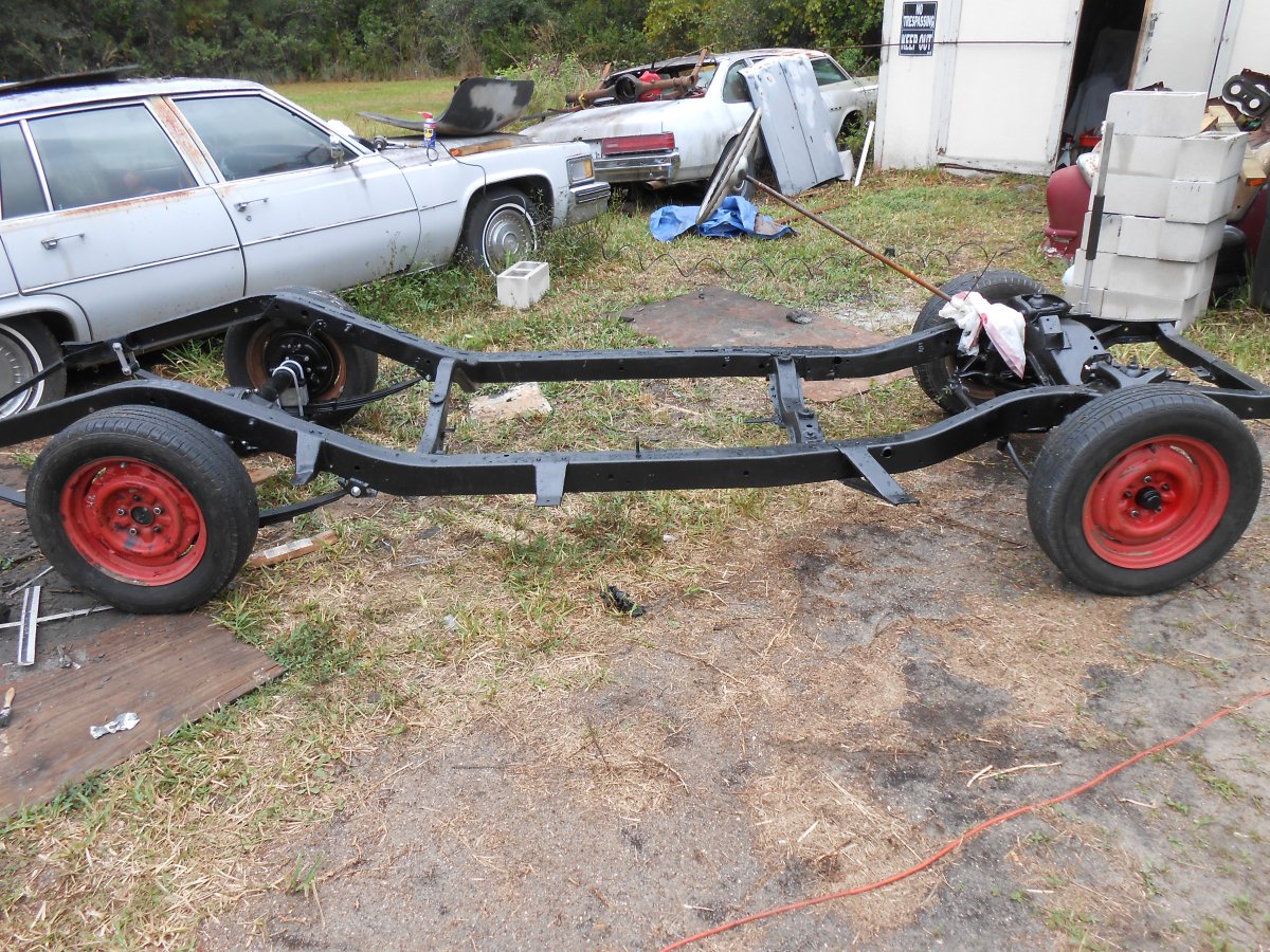

    DSCN1003.JPG DSCN1003.JPG Progress! Rear end is in.Tomorrow it will roll and steer.

  22. Rolling and steering is a big step forward. I know lowering blocks are traditional and all but with the body off and the spring mounts just begging for it. I'd have just moved them up the 3" and not messed with the blocks at all.
    The Wizzard

    Joined: Feb 28, 2014
    Posts: 1,507
    steinauge
    from 1960
    Thank you Ahshoe.I have the same full garage problem,thats why I am outside.
  25. Pist-n-Broke thanks for helping him with welding tips...thanks for hepling all of us with welding tips!
  26. Your all welcome. It's the little things that can make the biggest difference isn't it?
    The Wizzard
  27. steinauge
    Posts: 1,507
    steinauge
    from 1960
    Well,it rolls and steers.I pushed it to the garage today and after a couple hours of "strategic rearranging" actually got it in there! Tomorrow I will see about making it stop too. The mangy red wheels are off the parts car and are fitted with some used tires I had.They made it MUCH easier to push on account of having air in them.
