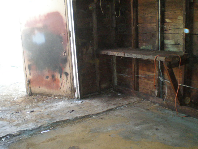

    In the sixties my garage was 12'x18' and had a flat roof. The 2"x6" rafters were all broken where others had tried to pull motors before (spell that f-a-t-h-e-r). So all motors were pulled at the door header with most of the car outside. The floor and the driveway were too bad for creepers and most of the time it was raining or snowing (seemed that way). That was SOP "back in the day". Built my avitar in that garage. The lean-to on the left was added in the 80's.

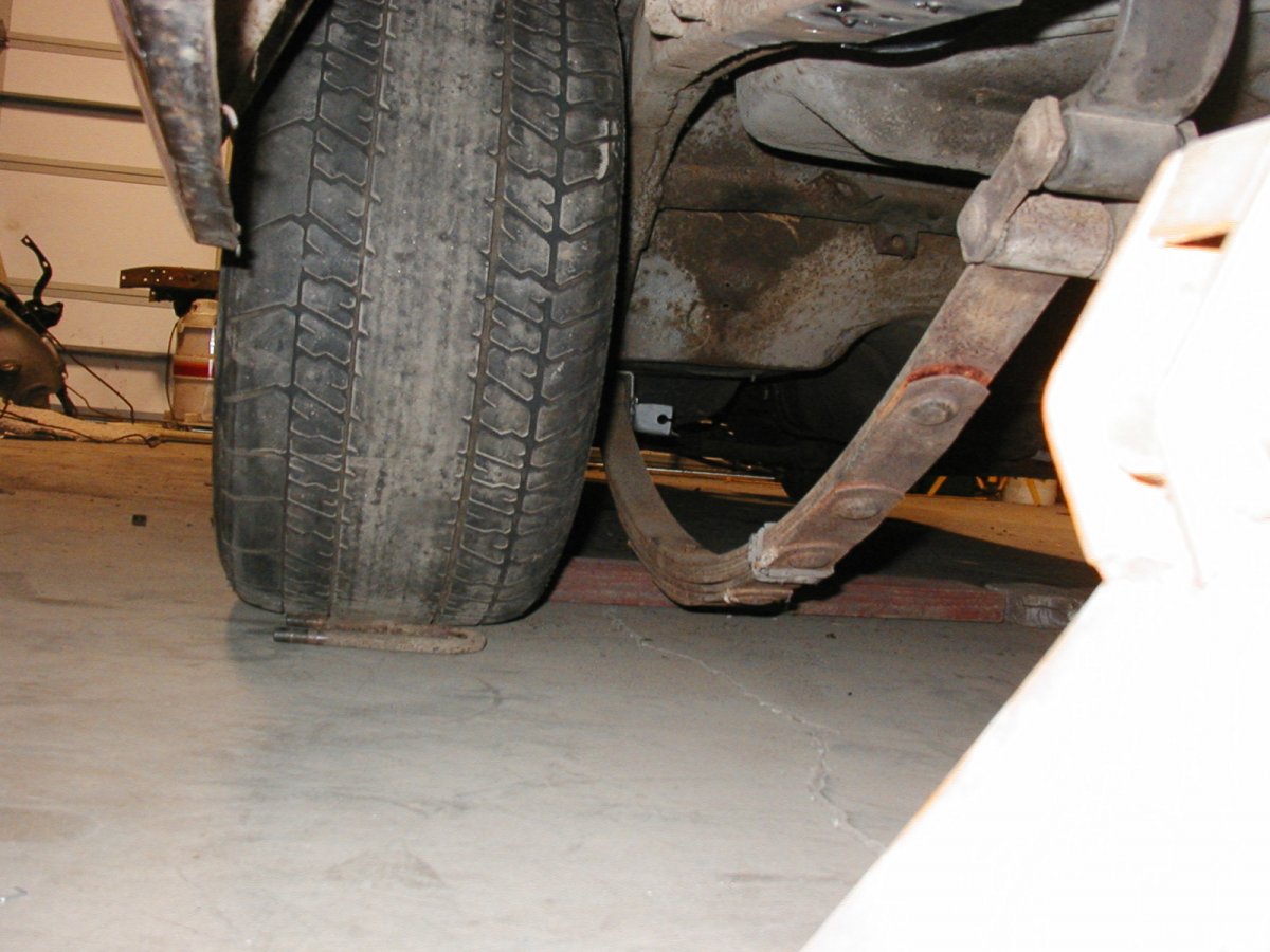

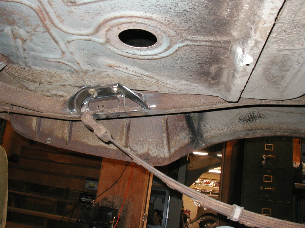

    Great car and you are doing a great job! Wizzard, Tell us about moving the spring mounts up 3" . I want to do that on 50 crestliner.jpg my Crestliner. Are you talking front mounts?
    Surfcityrocker likes this.

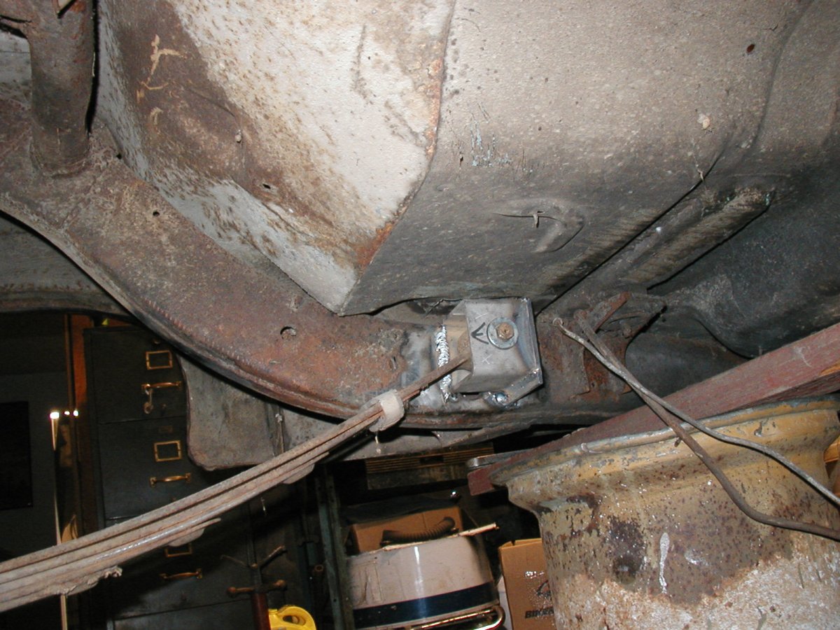

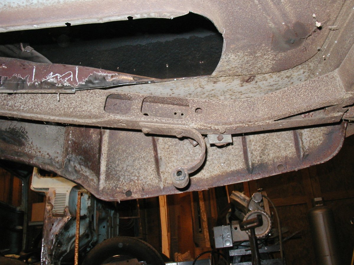

  10. manyolcars; Yes, I just re mount the spring hangers on the inside of the frame rails. That of course means moving the spring pads on the housing. These photos are of my 57 but it's pretty much the same job on the 51. To do top welds on the new mounts when the Body is on the frame I just cut a 3 sided opening in the floor and fold it back to access the top side. Notice I built a new front mount out of Sq. tube instead of carving up the old stock one. Lowering blocks add leverage to a spring and cause spring wrap. Most of my stuff gets a little extra H.P. so lowering blocks are out of the question for me. Plus I don't like U-Bolts and shocks hanging below the Scrub line. This also allowed me to run a full 11.5" of tread on the ground under my 57 without doing tubs or pinching the frame.

    Thank you for the photos! I see what you mean.

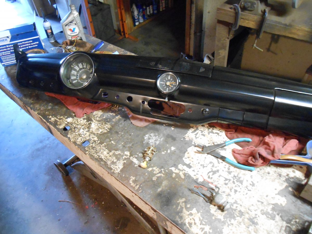

    DSCN1009.JPG Spent a few hours this morning at the turkey rod run. I think the swap meet this year was the biggest I have ever seen it.Worked on the Ford dashboard some.Not wonderful,but not bad.I need to sand it again and put another coat of paint in it. I am going to try and see how a chev 6 fits the ch***is in the morning.

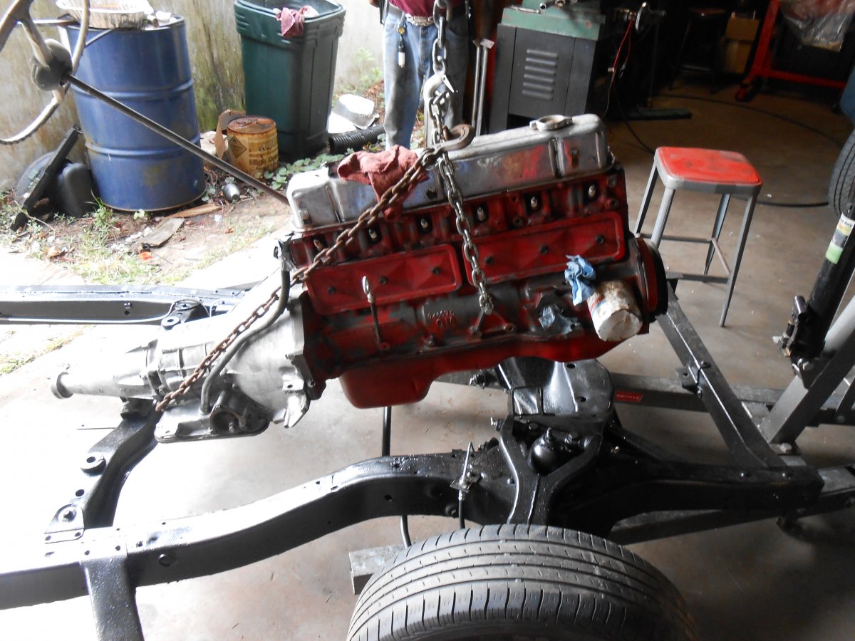

    Thank you both.I put an engine\trans in the frame today and spent several hours making motor mounts.When I bought the car the PO told me it had had a SBC in it.Maybe it did,but chevy mounts of several types do not fit the frame mounts.I got the 1\4" plate out and made a set of solid mounts for it.Sure felt good to use a stick welder again! I found after I got the mounts made up that the sump on the pan actually clears the tie rod! Not by a lot,but it does clear.I will install the real engine\trans tomorrow.Same type engine,just looks different.It was a 12 hour day today and I finally just wore out. DSCN1011.JPG

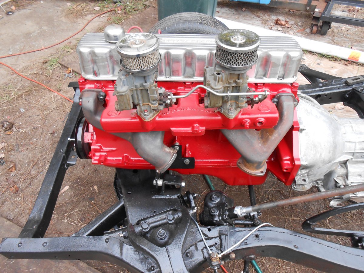

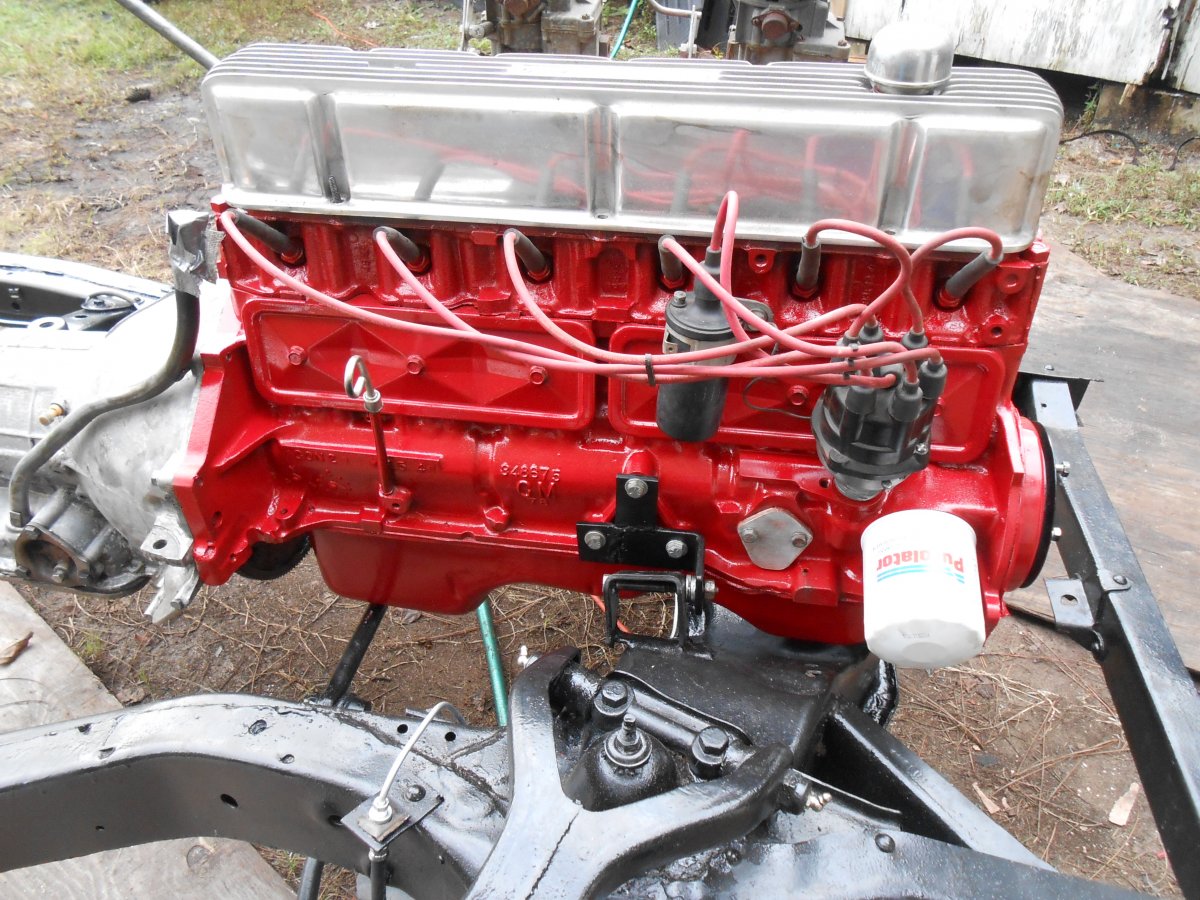

    Got the engine and trans in today.I mocked up the carbs and exh for the picture.I will have the gasket set tomorrow and will ****on all this up and get the engine ready to fire.I am enjoying this interlude,but shortly it will be back to body work. DSCN1012.JPG

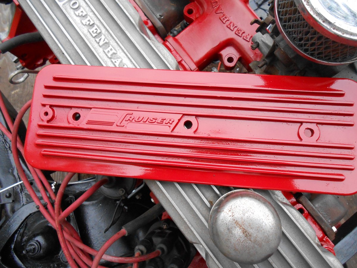

    I am going to put these on tomorrow.They were for a "Mercruiser 165"(6 cyl Chevy in a boat) and were originally so marked.I put them in the mill and removed "mer".I will clean the paint off the fin tops and lettering before installing,same with the intake manifold. DSCN1015.JPG
  21. I like your basic direction. I kind of question the single sheer single tab solid mounted motor. I hope that all works out as planned. Have you done this treatment before?
    The Wizzard
  22. Fedman
    Joined: Dec 17, 2005
    Posts: 1,163
    Fedman
    I agree looking good but I would be worried about the single sheer mounts for sure.
    Not a big deal right now to go back and make them double.
  23. steinauge
    Joined: Feb 28, 2014
    Posts: 1,507
    steinauge
    from 1960
    Thank you for your concern.I have.I had a 292 chev in a gl*** T roadster for several years with that exact setup.Never had any trouble with it.Truth is the first time I ran out of 1\4" plate late on Saturday night and figured I had the engine in and would order some monday,but it never moved and I never changed it.I have run solid engine mounts in a number of different inline cars and 1 V-8,all seemed to work fine,no vibration or breakage problems.Is there a solid mount problem you know about?
  24. I have solid mounted many race cars over the years. I've just never done it with 1 bolt on a side and always with a motor plate. See photo. Viberation at the track isn't any concern but on a nice long drive I might think differently. Also with a motor plate and 2 bolts on each side leverage doesn't twist in one central point. Looking at the length of your tab to bolt and from closest block to plate bolt I would be concerned about that tab braking off right through the block bolt hole.
