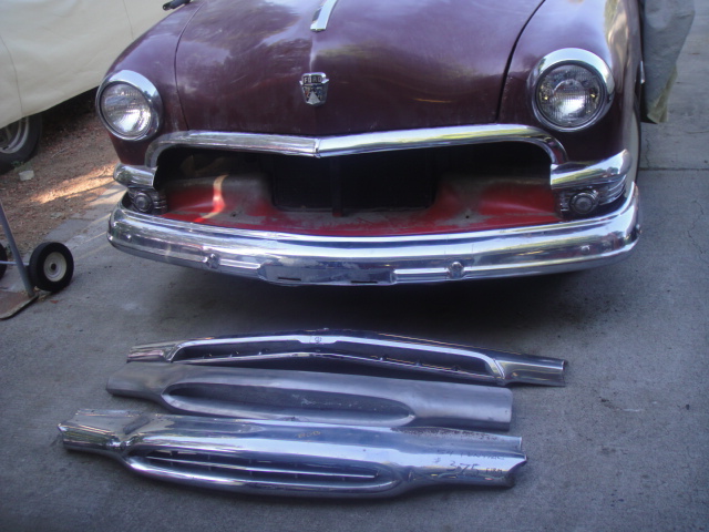

    Mister Pist-N-Broke...love your engine installation..looks really good. Heres whats going in my 51. DSC02216.JPG

    U-235 I appreciate the different grille insert pictures.Thats a mighty fine looking SBC too.The caddy engine is waiting in the wings so to speak.It is a 79 and I am hoping to stumble on to an earlier one.If not it will go in the car sometime next year once I have driven the car enough to de bug it.Pist n broke I have done a couple of mockups and it is looking to me like it would be less work to set the car up so getting the front clip off was easy if major work(like installing a caddy engine) was needed.Making a flip nose is easy enough,making a flip nose that doesn't look the part--not so much.

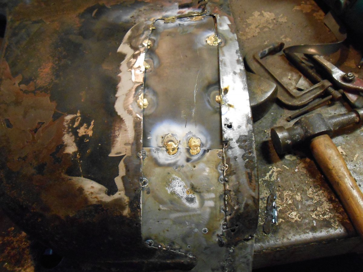

    DSCN1063.JPG DSCN1055.JPG I started working on one of these UGLY front fenders today.I had to replace some of the reinforcing channel inside the fender.Ended up doing that by making short pieces and welding them in.ugly,but seems strong enough.My welder died in the middle of this and I had to braze the outer patch panel in enough to hold it for now.I know I can buy this part of the fender as a patch panel,I just wanted to try not to spend the money.Tomorrow I will try making the missing bottom piece of the fender using the remaining part for dimensions (thats why it is still there)and,if I can fix the welder,install it.

  14. Yikes!!! I guess a little (or lot) of Body Man in a Can is in order.

    I will Road Zombi.How is your shoebox coming? Pist n broke I don't like that outer plate either, think I will remove it as soon as I can fix my welder.I think I can cut one that fits the hole more exactly so the surfaces match and weld it edge to edge. Do you think that might work better ?
  17. stinage; We all do things on different levels based on skill, importance and what is on hand at the time. That's why there's a good market for Body Man in a Can. I personally would have cut the Bottom of the fender off totally and made a new lower section with One seam and no lap joint 2-15 006.jpg 2-15 011.jpg , that's just me.

    Well,i do it by same way than Pist-N-Broke.I guess the lapwelds i do,are usually on the spots that factory has used them.

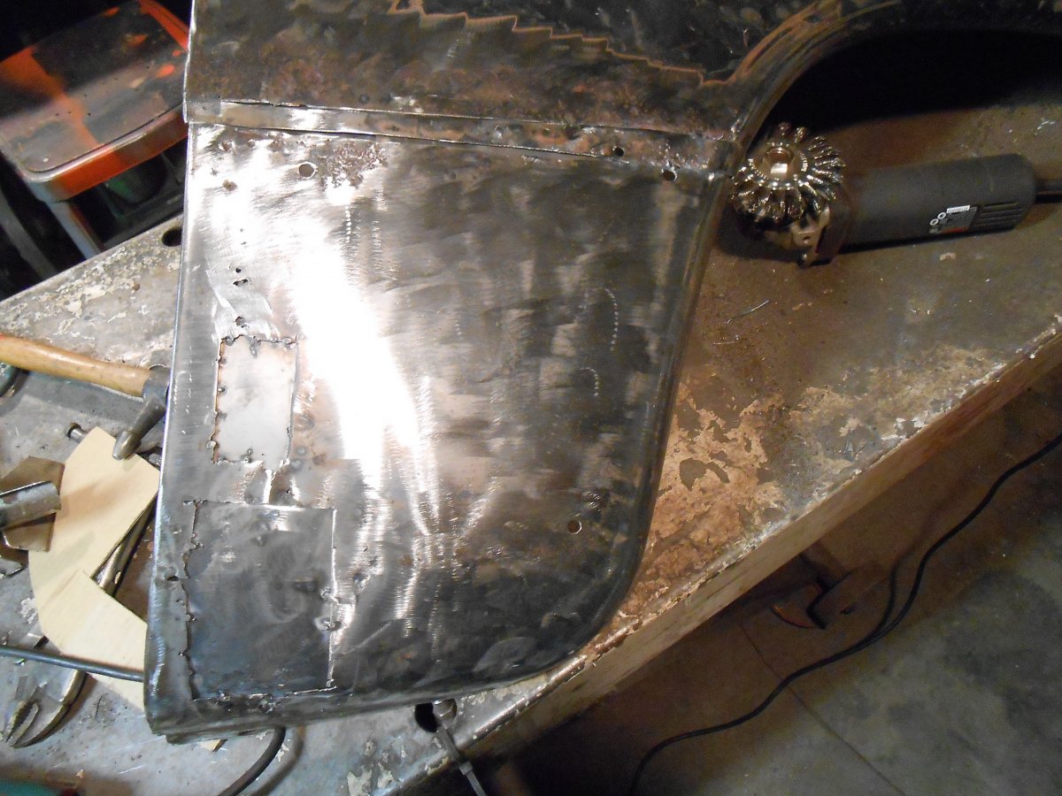

    DSCN1065.JPG DSCN1064.JPG I made a couple of better thought out pieces and got one fender roughed in today.Didnt end up needing a lot of filler(not nearly as much as I thought) to level things out.I have some areas that are deeply pitted.I reckon I will sandblast those areas clean,POR them and then use a little filler to level them out. DSCN1064.JPG
  20. A little trick I learned I'll share with ya. When wanting to Sand Blast an aria that has deep pits or is already Swiss Cheese, use a backer behind that spot. It can be just sheet metal but must be clamped pretty tight against the pitted spot. This acts as a support as well as a heat sink. It aids in not ending up with several larger holes instead of just many many pin holes.

    Thank you! I use a piece of aluminum stock for a backer when welding small holes shut in sheet metal, But I would not have thought of that when spot blasting.
  22. I think the way it really works is that if the Sand pellet cant get through the pin hole it just can't make it bigger.

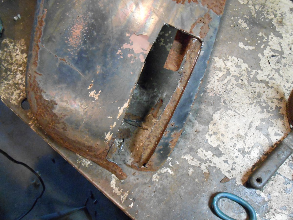

    DSCN1072.JPG DSCN1068.JPG I started on the other fender today.About 3 hours into it I realized I wasn't going to be able to fix this. DSCN1066.JPG Doesn't look too bad from here,problem is once the rust is cut out this is what you get. Fortunately? I had been given a pair of discarded fender bottoms by a local guy who is also building a shoebox.Turned out his was way better than what I had.Only needed two patches and most of the inner structure is sound.Problem was he had cut them off which led to some fitting problems,but I can work that out over the next few days.

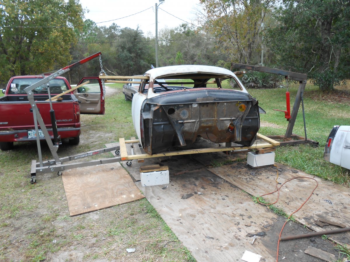

    DSCN1073.JPG I got the body down on blocks again today.I am done with the bottom and need only to finish up stripping and painting the firewall to put the body back on the frame.( THEN the fun begins-I hate bodywork)I am working alone,so I made a strange sort of gadget to allow me to raise and lower the body.It actually seems to work.

    I used the same body lifting tactic,it works pretty nicely.
