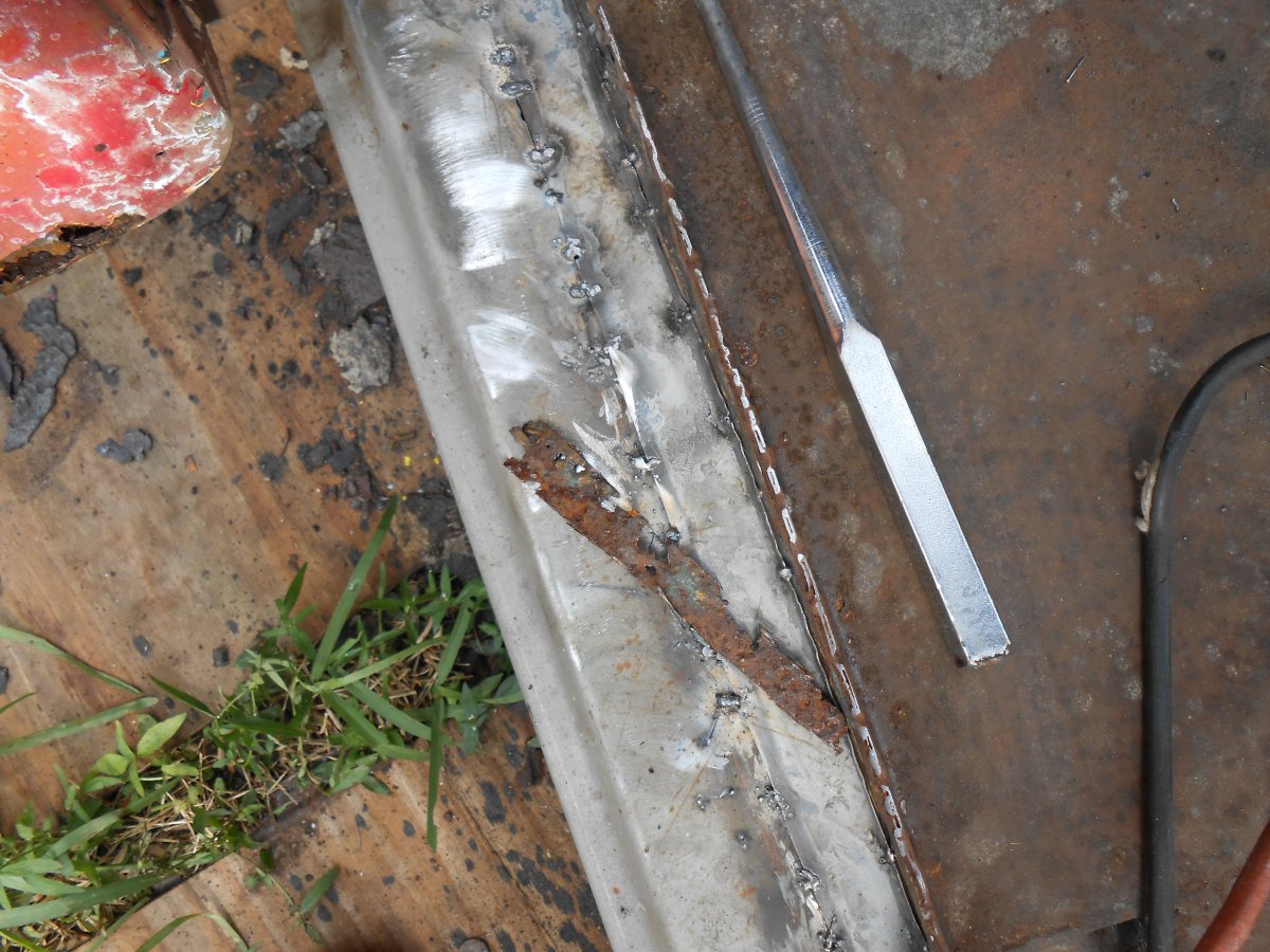

    Started working on the body today(other than the undercarriage).I discovered a 15" strip of what is best described as lace with a brand new rocker panel welded to it.The piece on top is one of the pieces I cut off the rocker panel.The lace piece is sitting on the patch that replaced it.People sure do odd things! DSCN1086.JPG 0
