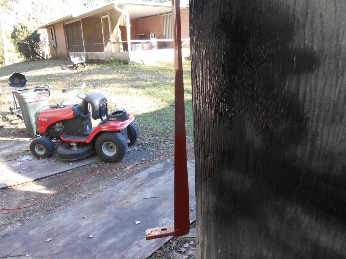

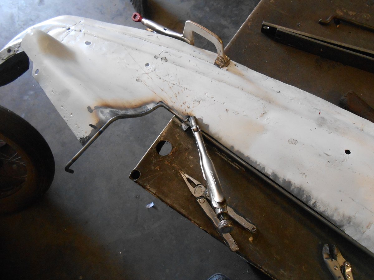

    Thank you all for your help and kind words.Thanks for the link Antti!.I worked on the apron some today.I had to cut a pretty big piece out of the middle to clear my radiator,so I thought I would edge it with some 1\4" round rod.I also made a set of fender supports that come off the frame and bolt to the center bottom hole on the apron and fender. DSCN1117.JPG Note that the last pic is not supposed to be the lawnmower,it is the fender support bracket after being ground and primed;)

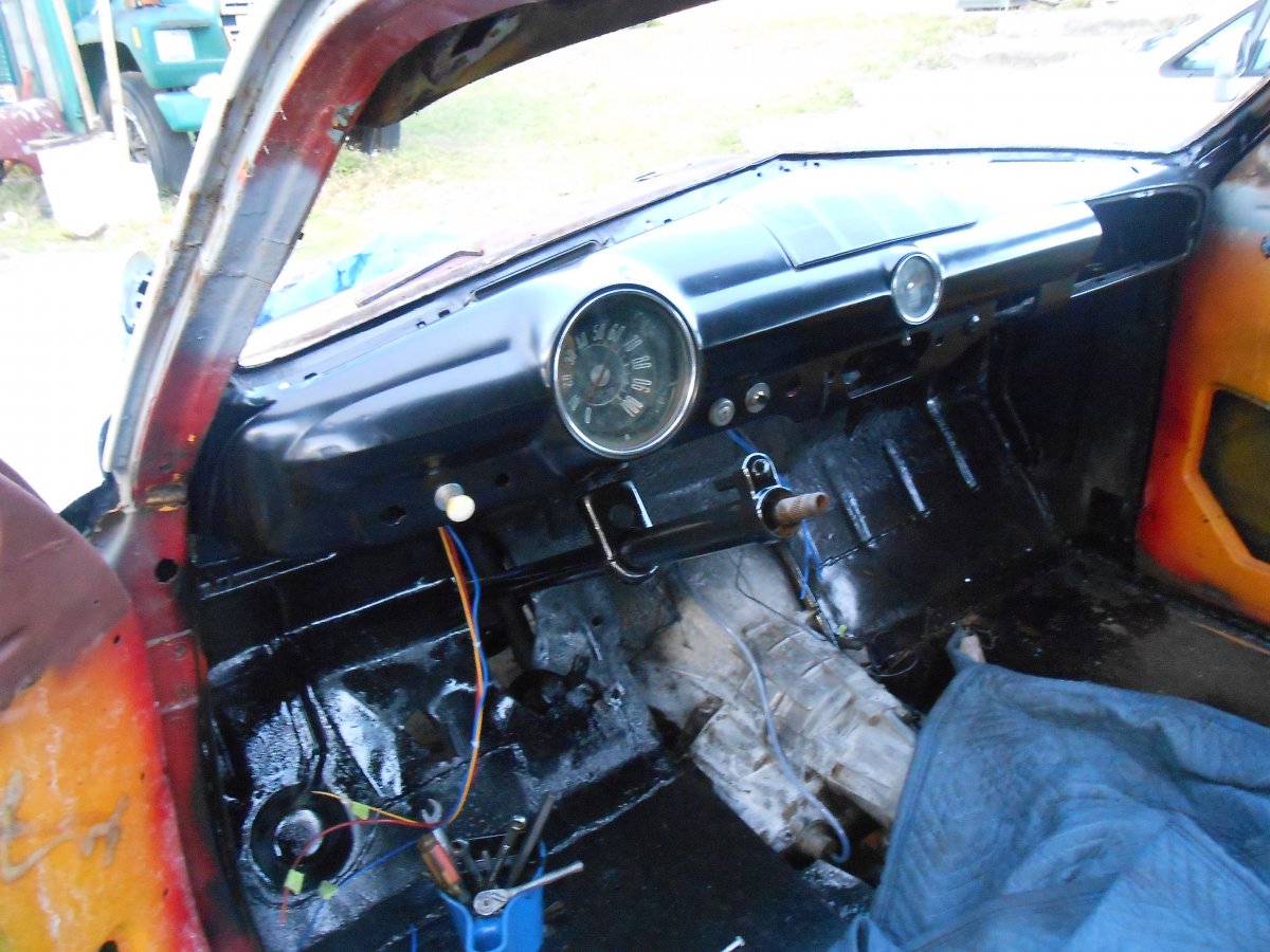

    Since I was done PORing the front half of the interior I put the dashboard in today.I made up the dash harness and installed the light switch,key switch and starter ****on,all I really need at this point.Also slid the steering column into place.I started working on the steering wheel too.That is going to take some time,its pretty rough. DSCN1132.JPG

  17. Hard to tell by the photo. It looks splined but could be tapered and keyed for the steering wheel. I have a Cherry and painted to match my 51 wheel. PM me if interestred

  18. steinauge
    Joined: Feb 28, 2014
    Posts: 1,507
    steinauge
    from 1960
    Its splined.I appreciate the offer,if I cant fix this one I will be in touch.I got the battery box in today and enough wiring to start the engine so with a little luck I will be able to move the car around under its own power in a day or two.

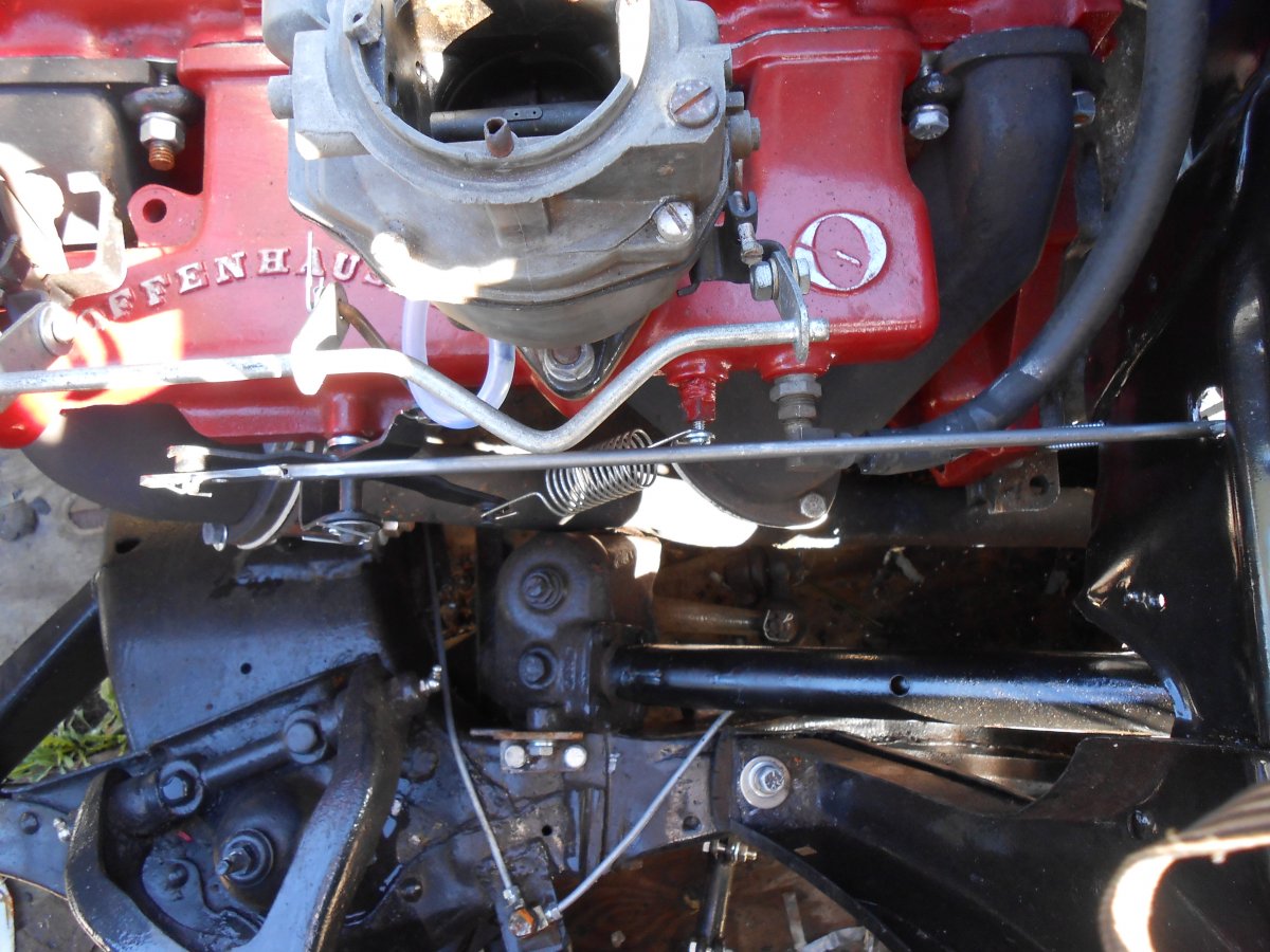

    Got a throttle pedal and linkage in the ford today.The pedal has been hanging on the wall for years and I made the linkage rod up out of some 1/4" round stock.Works fine,everything clears.I can actually sit in the car,turn on the switch and start the engine! If it had a seat I could drive it up and down the road. I have a junk van in the backyard that has two good seats in it.Not what I wanted,but I may try them temporarily. DSCN1142.JPG DSCN1143.JPG
