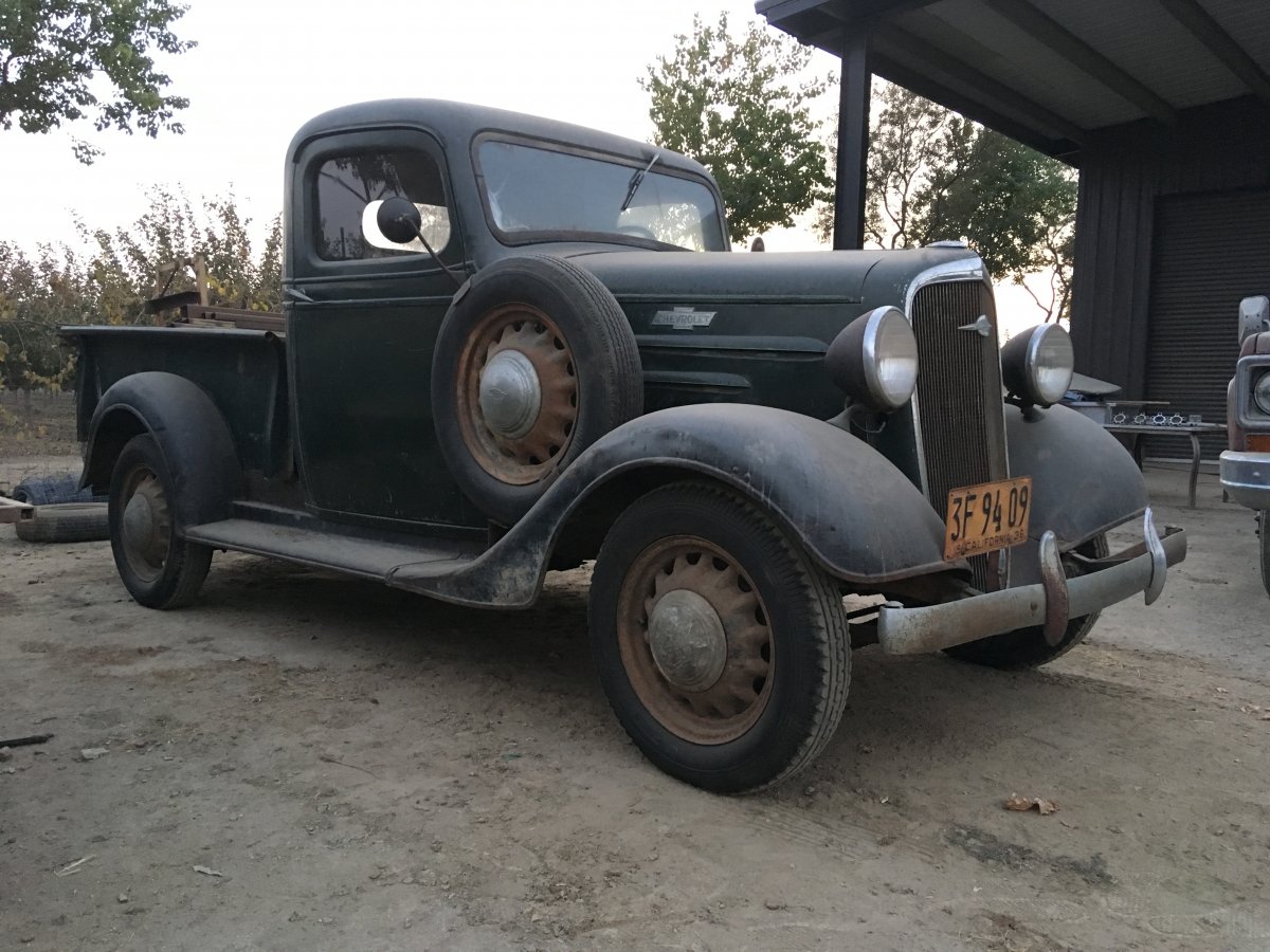

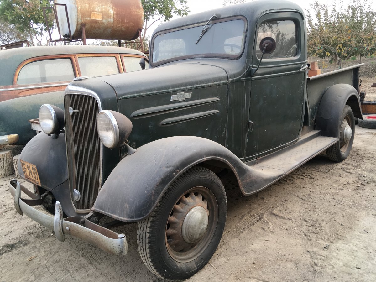

    1D8AB730-DDBB-49E9-82C2-0602083FFE21.jpeg 1936 Chevy pickup. I want to lower it a little keeping it somewhat period correct and stock looking with the same wheels and tires.
    What would it take, drop front axle and flip the rear?
    Thanks, very excited for my first pre war vehicle.

    20180113_151117.jpg I like it, that looks to be a real solid nice truck. I've had a 36 for 40 years, what ever you do,,,,,don't put a Mu____ng II type front suspension on it. Upgrade the steering box run 49 up spindles and brakes and get the axle dropped . Believe me, don't make the mistake I made. Mitch

    You should try to buff out the paint, if it is as good in real life as it looks in the picture. It may surprise you how good it comes out.

    36 Chevy trucks are the bomb!! I would clean it up and drive the hell out of it. That is a clean truck!

    Plan is to lightly buff the paint (it’s all original) and lower it a little.
    What would be the best way to lower it?

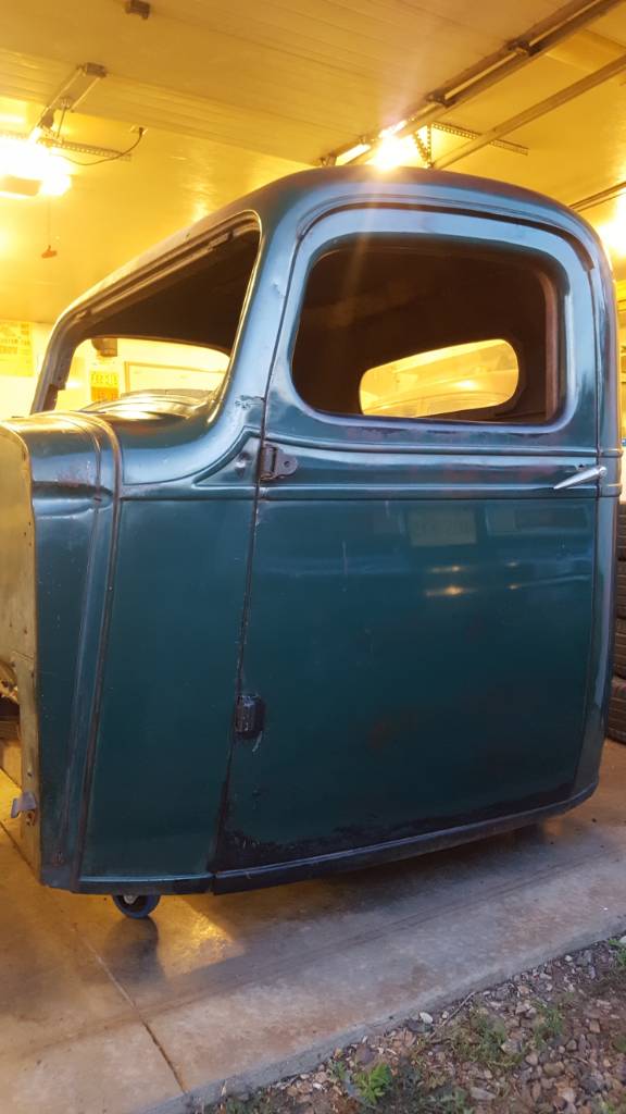

    That paint should come back really nice, I did a quick polish on the og paint on my 36, which is a lot worse for wear the your truck and it came out decent. 20180725_211953.jpeg

    DAMNnnnn, 66, that's a nice cab. Where do you guys find these nice trucks??? Mine was in a field , all apart with no engine/ trans. Course it only cost me 125, an old lawn mower and a trashed SBC short block, but that was 40 years ago.....oh hey Rat, I bought my wood kit from KC WOOD MANUFACTURING in Virginia, in case you need it. Mitch.

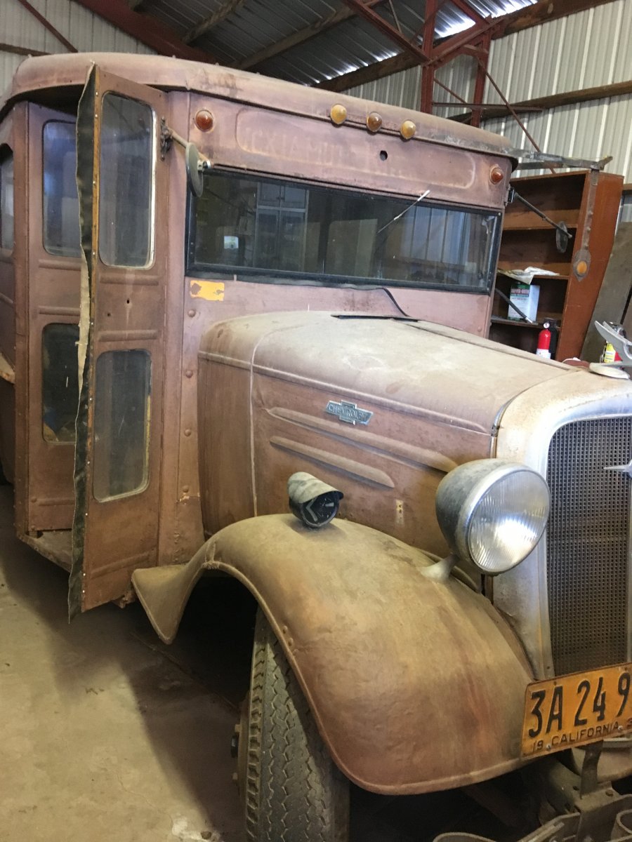

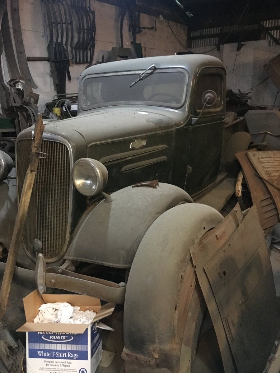

    74DFF6D9-FF9F-4DCF-85EF-2D07C768A25B.jpeg 15C051CF-F745-487B-B058-6667E14F4F85.jpeg Pic of the other side and one of how I found it.

    Jesus, that IS a NICE find. You know 36s have juice brakes and I would say that all rebuild stuff is available . Just get a drop axle from Nostalgia Sid, pull some leafs and drive her while you look for other parts for updates. I would look for a good steering box for a 37- 54, there a better design than the wimpy 36 unit. Are any of the parts around the truck in that one picture available? My friends doing a 38 and needs some stuff. Damn that's a nice truck. You must have a horse shoe up your ***!!! Mitch.

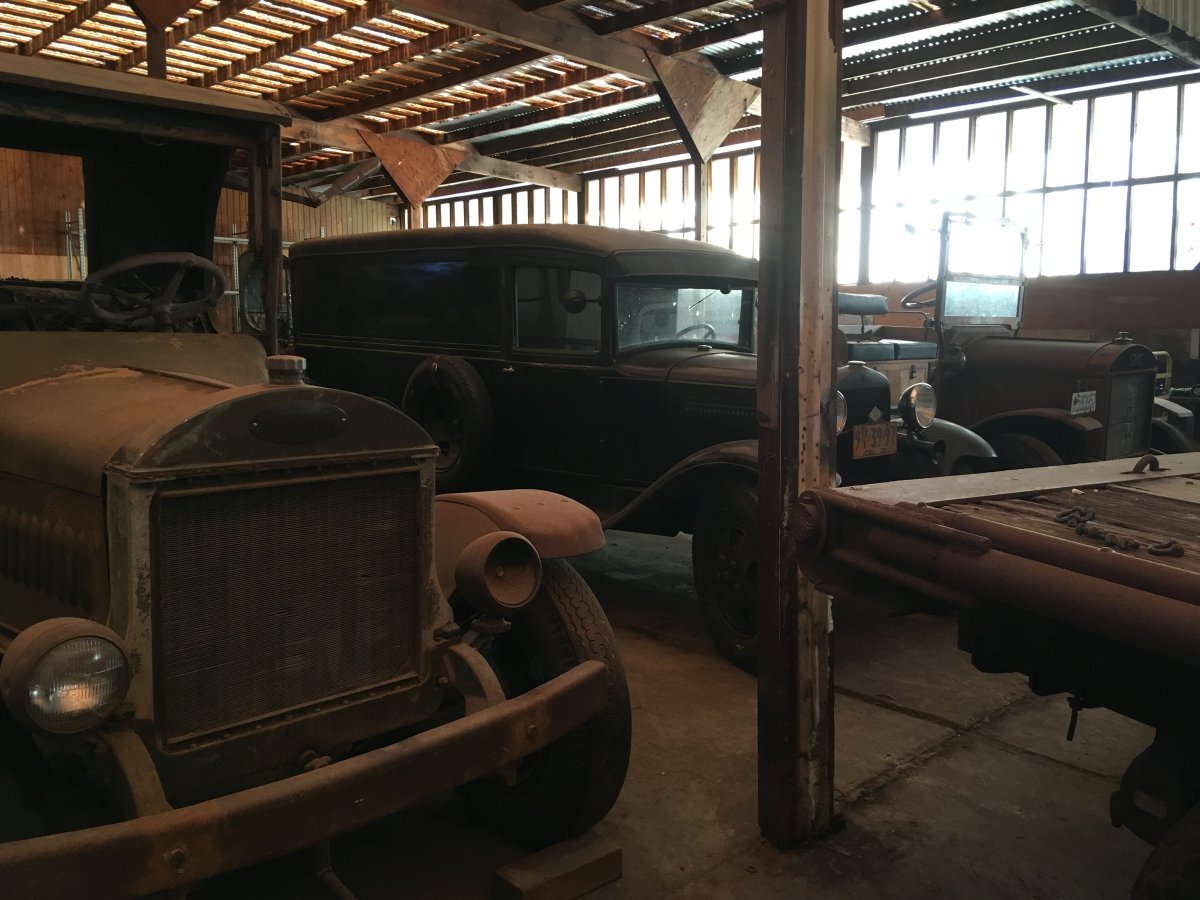

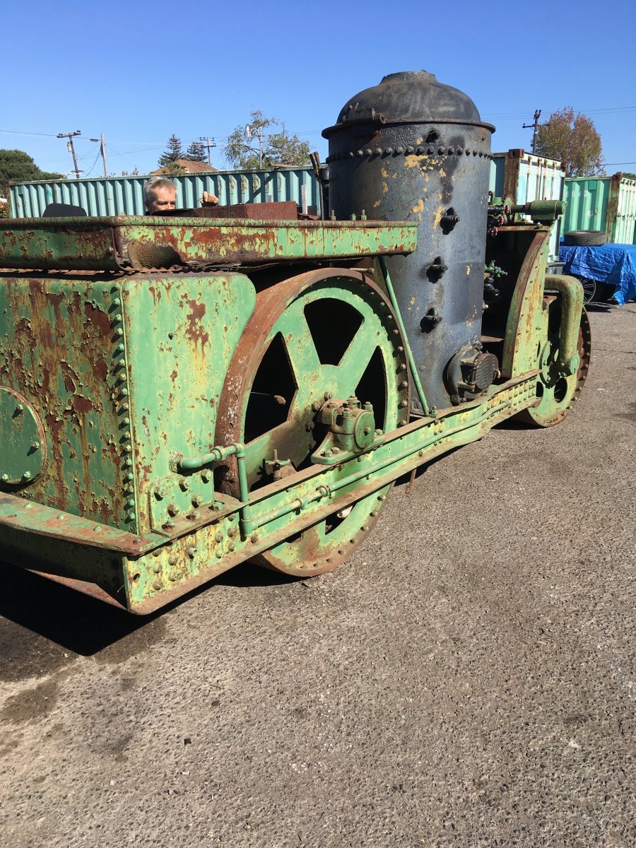

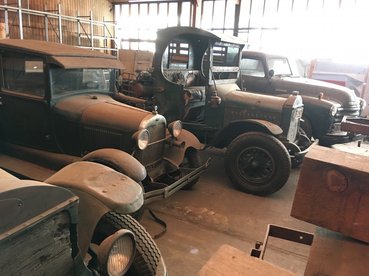

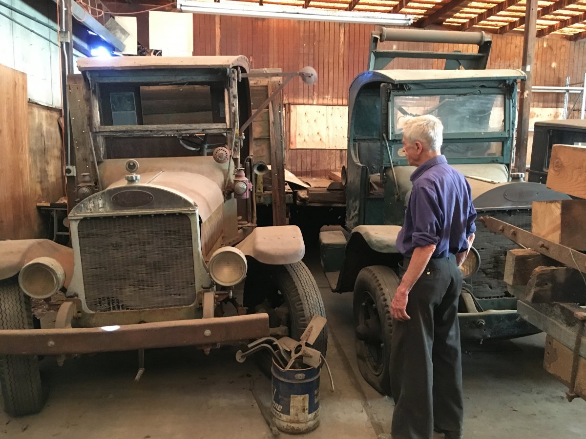

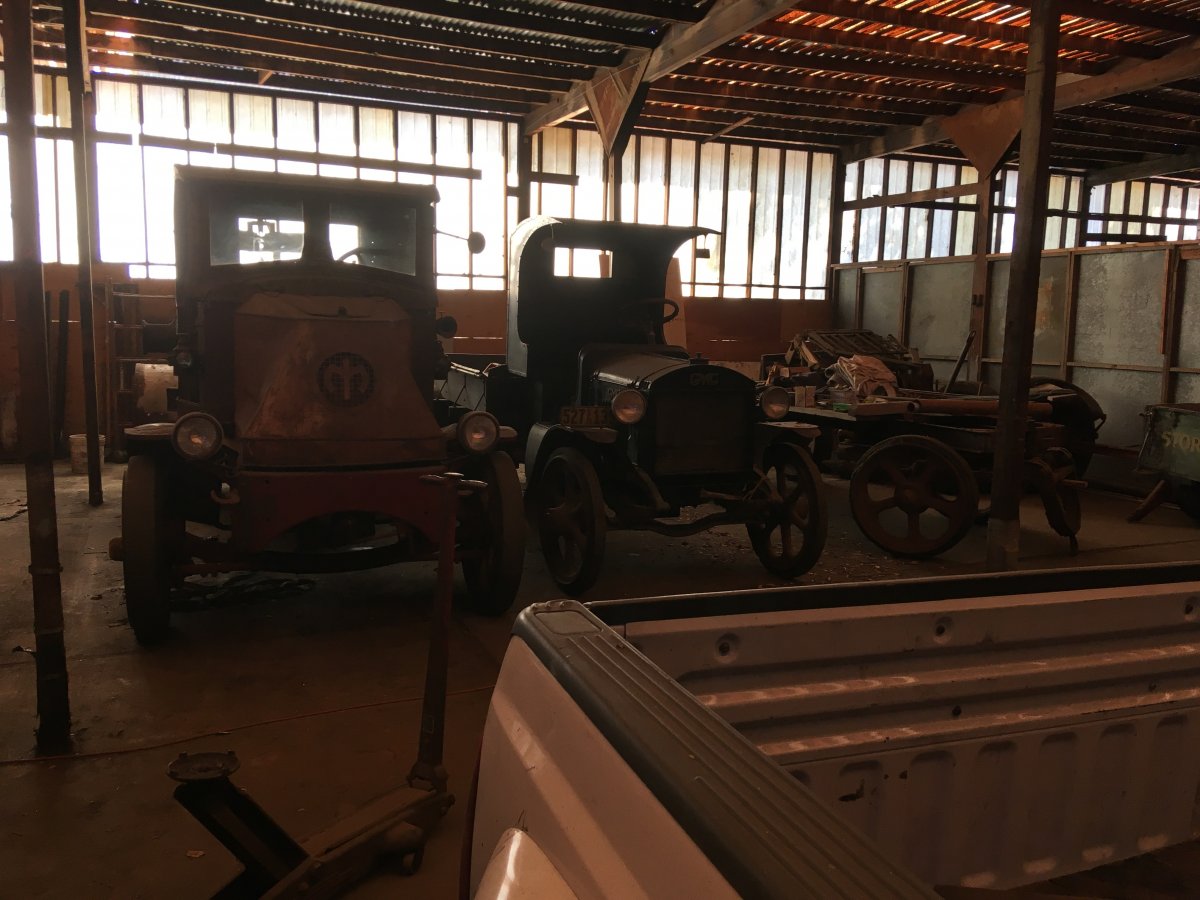

    Here’s some more pics of the guys place where I bought the truck, he doesn’t normally sell stuff I was lucky to even see his collocation and even luckier to be able to buy from him. This is maybe a 1/4 of what he has, there was 2 other buildings I didn't get any pics of. I bought the ‘36 school bus too, I have to go pick it up still.
