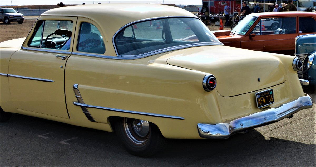

    I always liked these body styles, of these Fords from the 50's .
