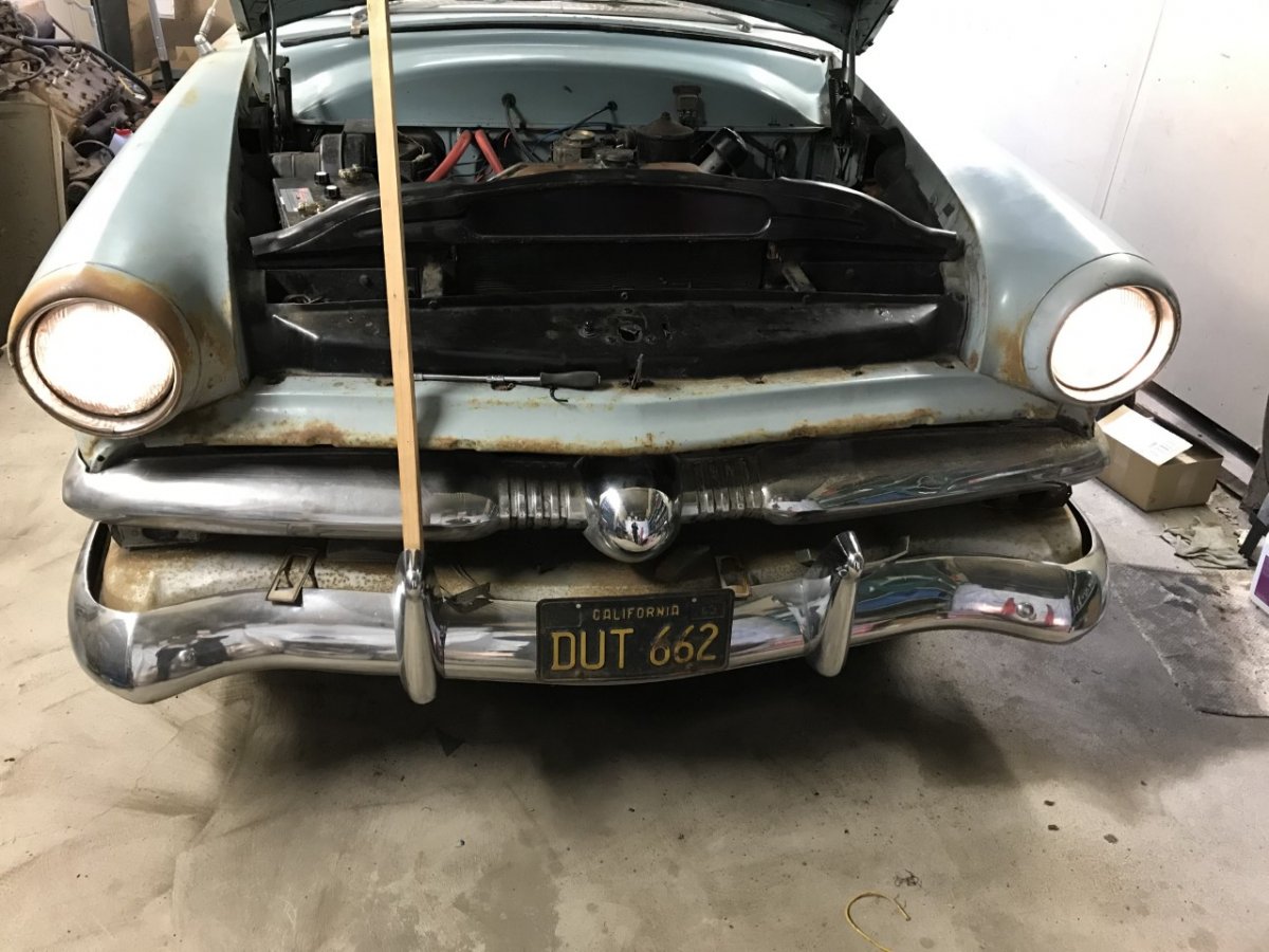

    While waiting for the fuel pressure regulator I decided to finish the headlight wiring.
    Installed the new lighting harness I got from Dennis Carpenter earlier this week and now I have headlights, tail lights and license plate light.
    Just need to get new bulbs for the front parking lights/turn signals and hopefully those will work too.
    The wooden stick holding the hood is just an extra safety device.
    The hood did slam down on its own once, luckily my head wasn't in the way.

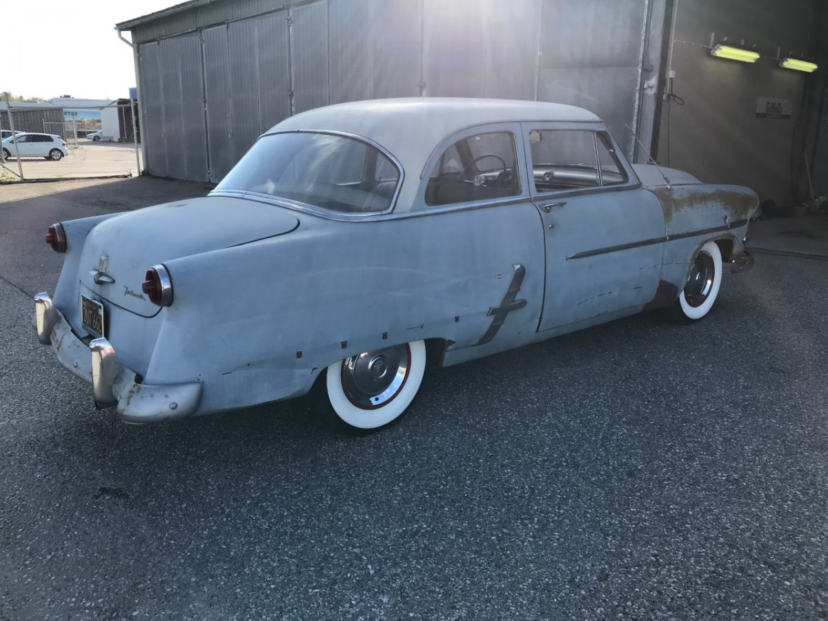

    Drove Alice out of the garage for the first time.
    Smoking from the exhaust seems to have gotten less, and the engine is so quiet.
    A few pictures just because :D
