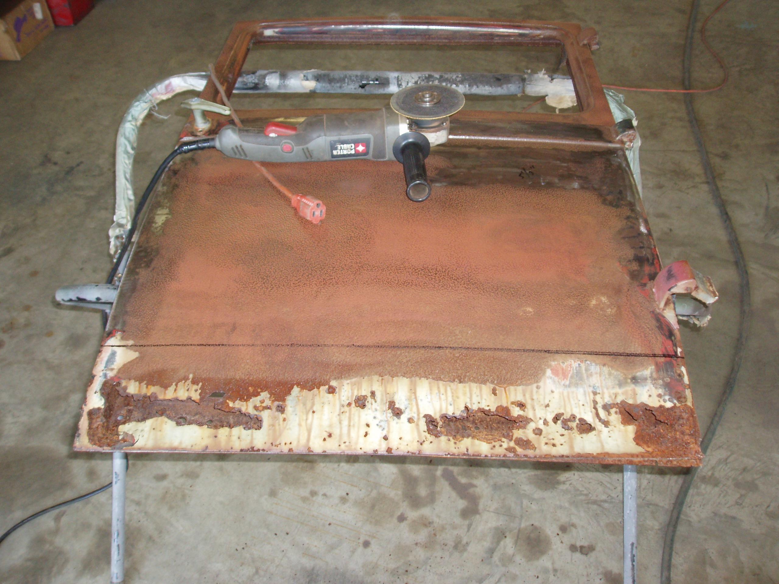

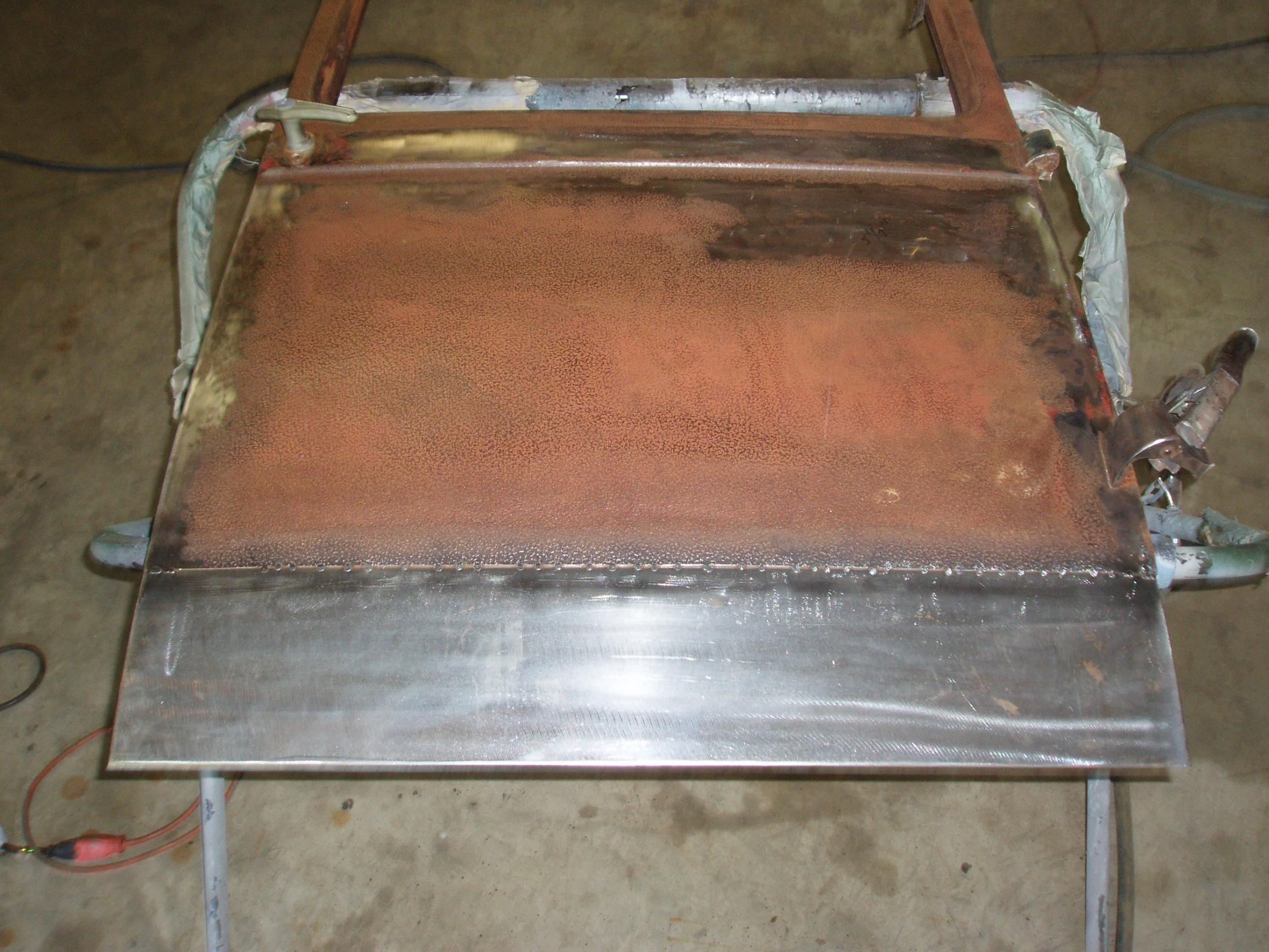

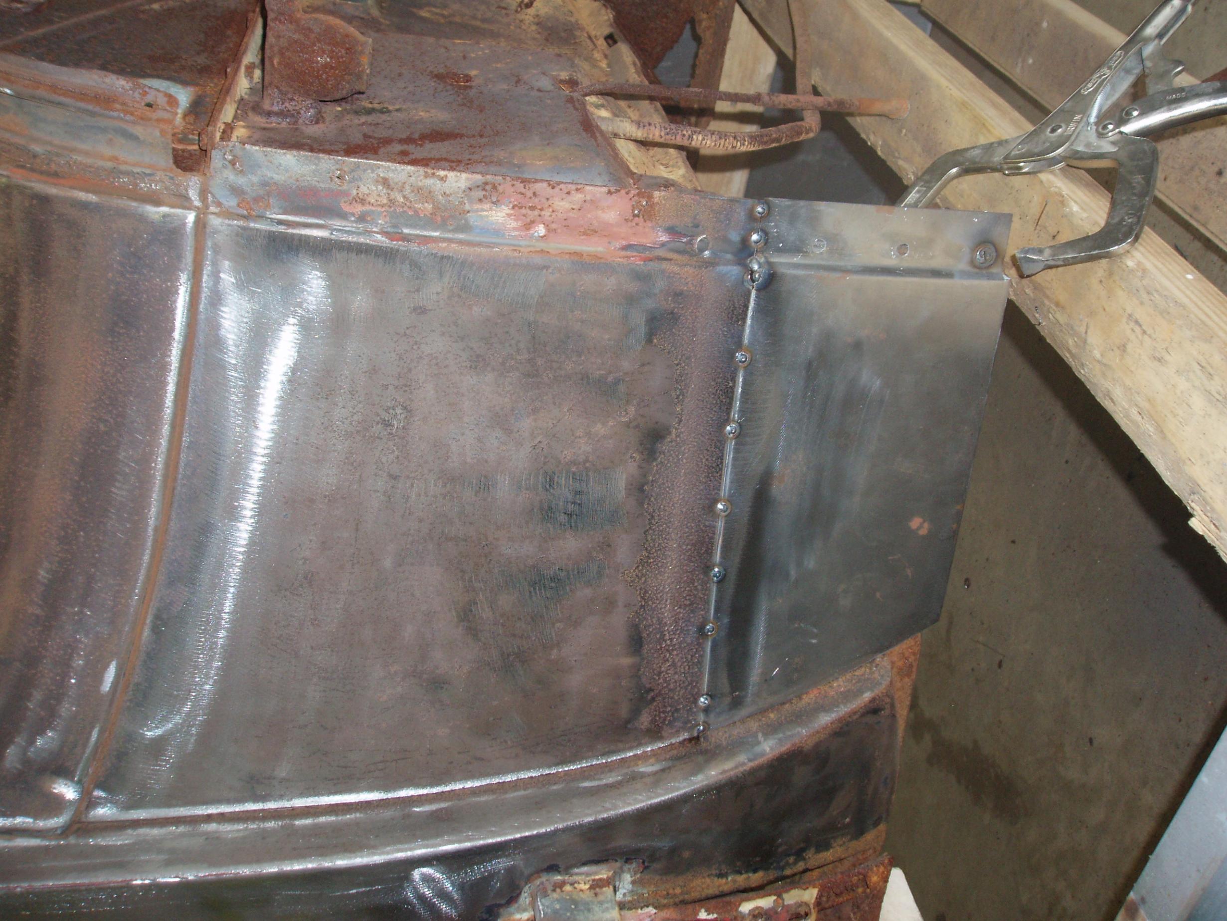

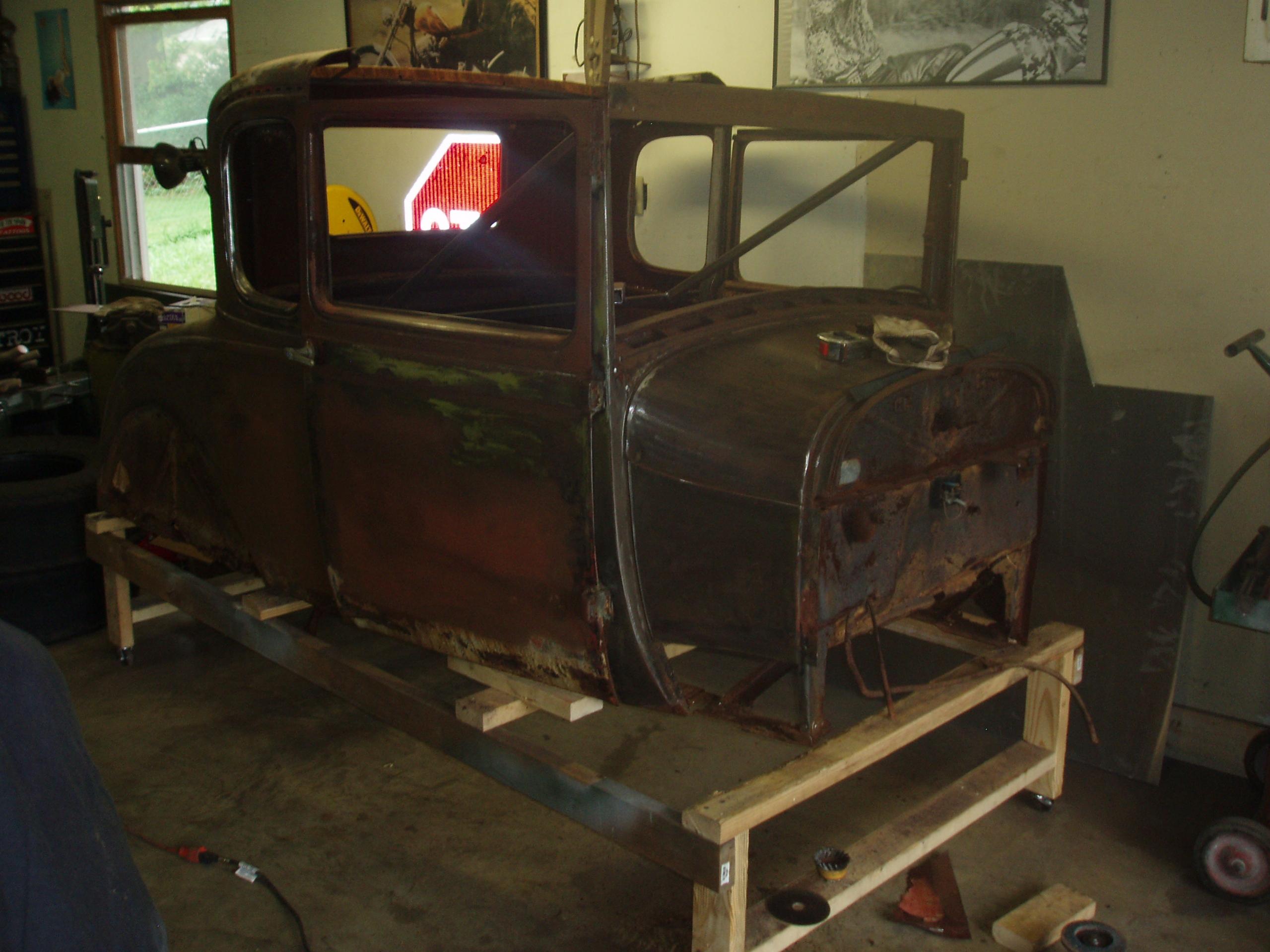

    update...i havent done a whole lot, been busy with work and still collecting parts. I am building the coupe, my buddy Mark is building the sedan. As for the coupe, the body is off, started cleaning it up, p***engers door patch is in as well as the cowl. Plan is to use a buick nailhead.
  6. Lookin' good. I'm jealous like everyone else here. Wish my sedan was in that good of shape. Do you plan on choppin' it at all?

  8. 1929Essex
    Joined: Jun 5, 2010
    Posts: 83
    1929Essex
    i plan to chop it 4 inches...gotta find those impossible to find roof sections first though. I will probably just end up making them but it will take some time.
