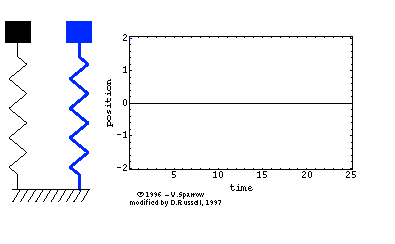

    Undamped spring m*** vs damped, you have one of these on each side;
  19. need louvers ?
    Joined: Nov 20, 2008
    Posts: 12,901
    need louvers ?
    Face palm slap...
  20. hoop98
    Joined: Jan 23, 2013
    Posts: 1,362
    hoop98
    from Texas
    The left spring is at a frequency of 1.25 CPS a normal value for a p***enger car with no damper. The right is typical if you bounce a car with dampers.
