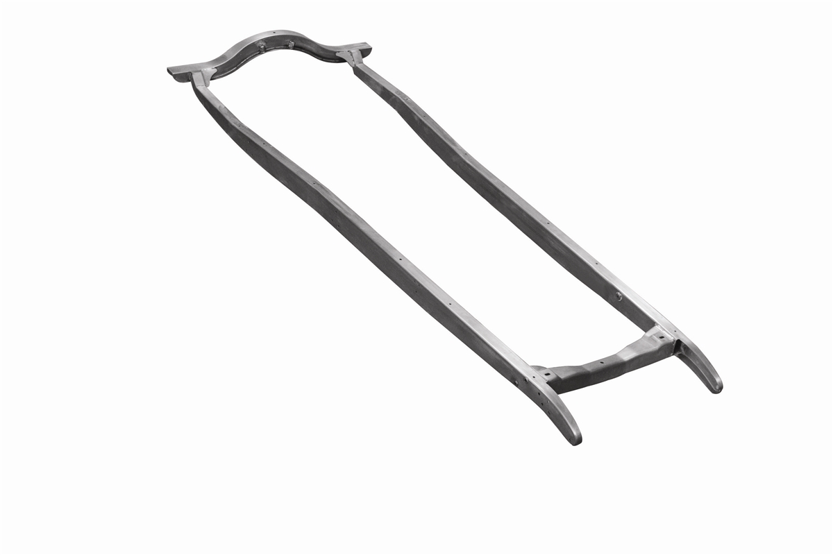

    @Dennis Rogers pictures would be helpful but it's not all that necessary. When a Model A frame is boxed, the inside face of the rail doesn't match the outside. Since it's C-channel the bends aren't as sharp as how the boxing plate sits.
    Here's an example of what the holes look like on A rails:
    Here's an aftermarket perimeter frame:
    and all loaded up for a street rod will look something like this:
