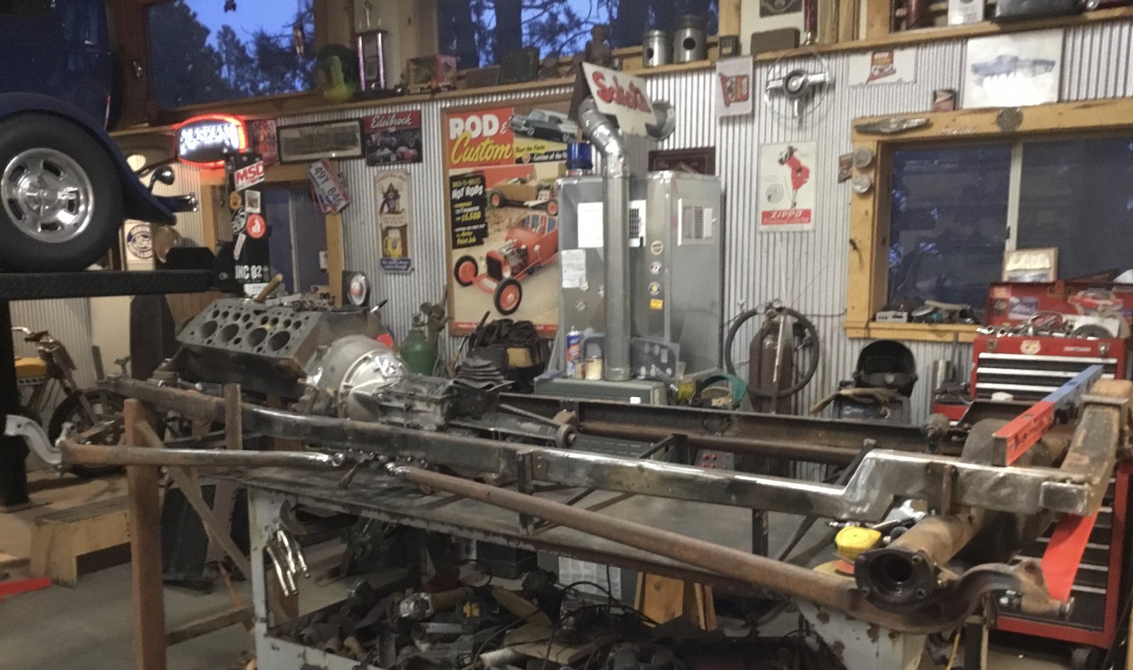

    I don’t have a jig but I do have a flat metal table that I set my frame up on. the rails are leveled side to side end to end and squared with uprights welded to the table so I can add crossmembers and box. And whoever says you don’t have to box a frame has never worked with a model T ch***is. This is the second ch***is I’ve built on this table. DD15242A-40B9-4ABF-AECC-6F4AAF0BE45C.jpeg
  16. mgtstumpy and fiftyv8 like this.
