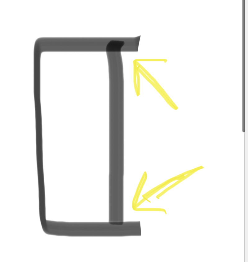

    Ive wondered if having the boxing plate laser cut similar to this would add the same/similar strength with less weight.
    Solid plating always seemed like a waste of metal to me
  15. fourspd2quad
    Joined: Jul 6, 2006
    Posts: 943
    fourspd2quad
    Anthony- I dont think you lose much if any structural integrity with a boxing plate design like that. If weight savings is the goal then I say go for it. I like the visual design of it also but if it isn't seen then that may be more work that desired. Also there have been many cars built where the boxing plates were added only where necessary to avoid frame twist. A fully boxed frame all the way to the back is not necessary for a simple SBC swap into a vintage A ch***is......for a street car/cruiser.
    anthony myrick likes this.
  16. twenty8
    Joined: Apr 8, 2021
    Posts: 3,872
    twenty8
    To get any real world advantage from m*** reduction, the concept has to be applied to the whole car. Only dedicated stripping of weight throughout the entire vehicle will give any benefit worth the effort........Big job. And you are correct, the real skill is to be lighter without sacrificing strength. If you can be lighter with more structural integrity, you have truly mastered the art...

  17. -Brent-
    Joined: Nov 20, 2006
    Posts: 7,893
    -Brent-
    I like the looks of that method. Ionia did it on my 32 ch***is and I always liked that (their frames are art!). So, that carried over to my A ch***is.
  18. Ned Ludd
    Joined: May 15, 2009
    Posts: 5,581
    Ned Ludd
    The architect in me is thinking, good: any water which manages to get in can get out again. But you'll need to paint the inside thoroughly, so you'll need a process which will get at the back of that plate. Powder-coating will in theory, but not always in practice. Hot-dip galvanizing certainly will, but your frame might come out of the bath twice as heavy and shaped like a pretzel. You might also get coc****s and wasp nests inside your rails, which might be OK on some builds and not on others.
    chessterd5 and anthony myrick like this.
  19. twenty8

  20. Ned Ludd
    Posts: 5,581
    Ned Ludd
    Thinking like an architect again: you'd need to block capillary wicking of water through the unwelded portions, with some kind of stable filler. That should go on thin enough to wick in instead.

  22. Russco
    Joined: Nov 27, 2005
    Posts: 4,397
    Russco
    from Central IL
    This method is how I prefer to do mine. I also have a 4 x 8 steel table I tack the frame to before I weld in the plates and they will still have a bit of movement when I cut it loose when I’m done.
    dana barlow and anthony myrick like this.
  23. No wasps or co****s when ya drive em a lot.
    The inside can be treated easily with a 360* nozzle on a flexible wand.
    Ned Ludd likes this.
