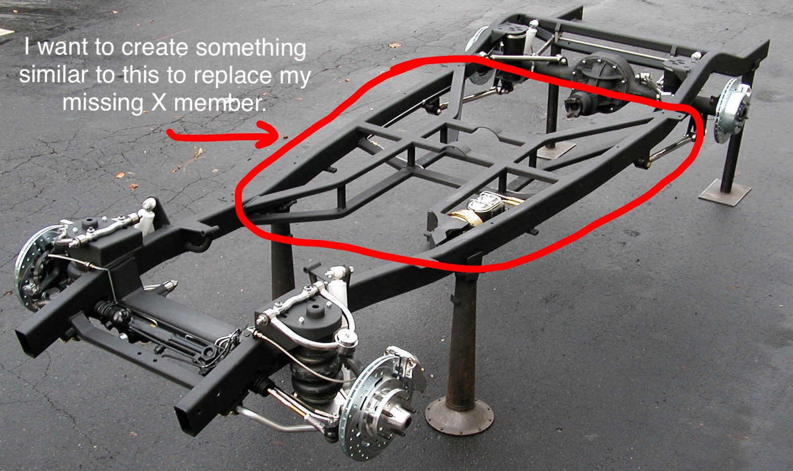

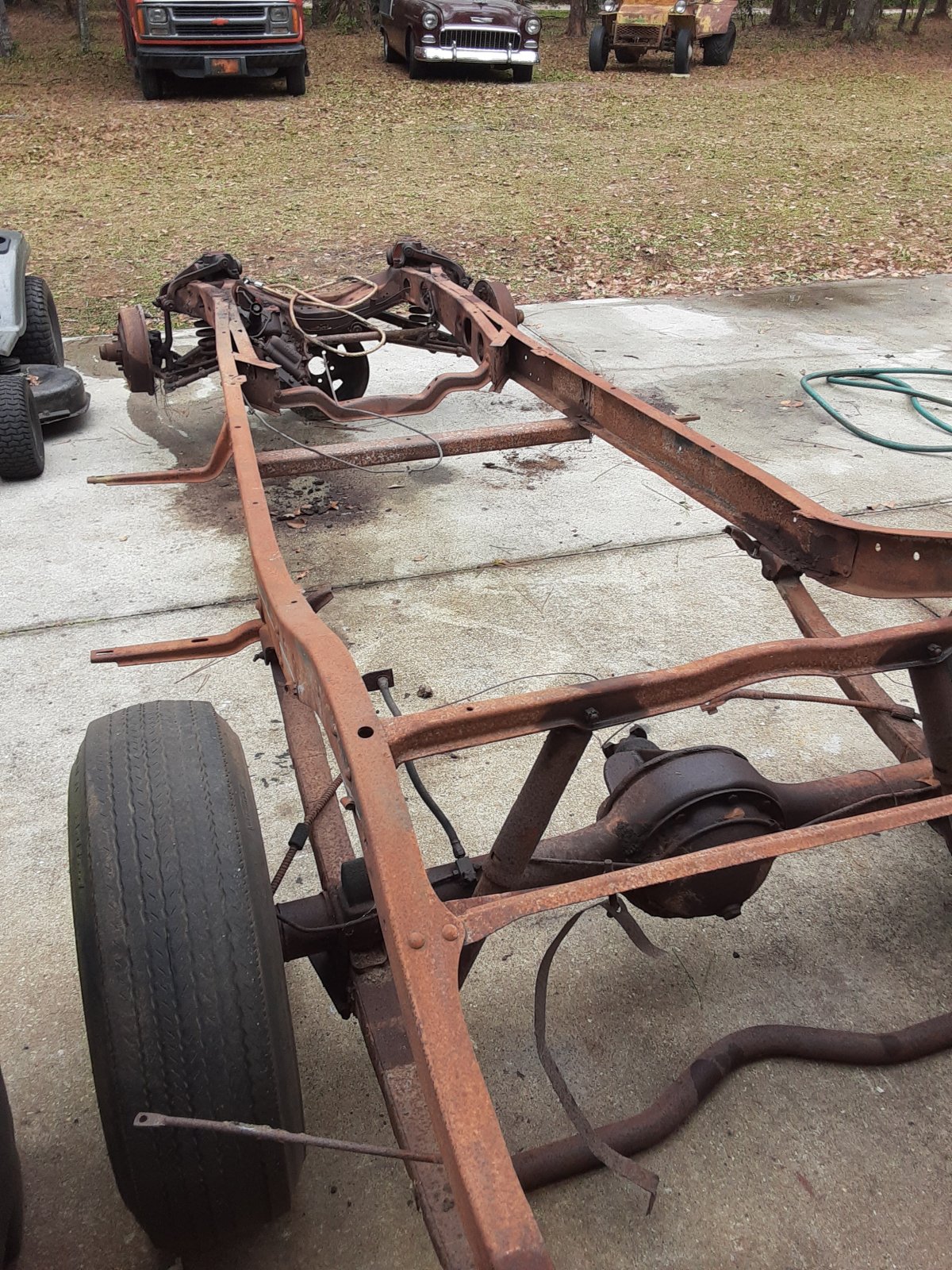

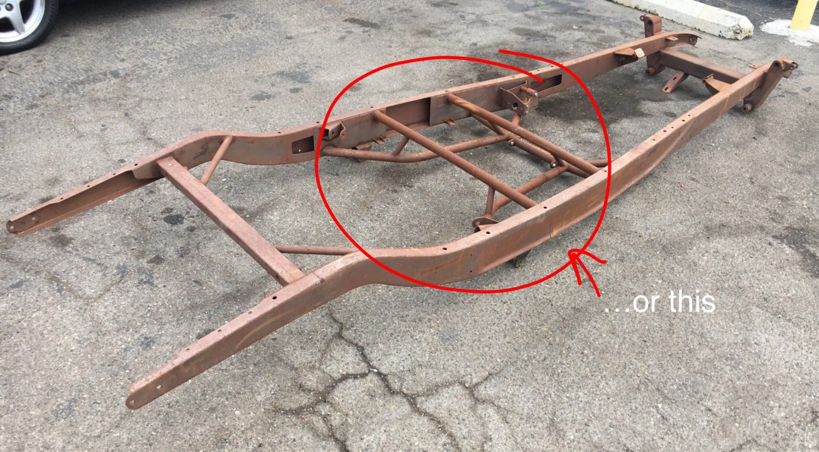

    I just read every entry on this thread and now have zero clue on how to proceed with my problem. I have a 39 Pontiac frame. It appears to be pretty solid except a PO cut out the X member from the middle. I was planning on boxing the frame and building a new X member similar to the attached pic. After reading this, I’m concerned I’ll end up trashing the frame due to warpage. I’m an amateur welder and do not have any type of jig, large *** table of any other way to tie the frame down.
    This car will not see a tremendous amount of HP. Should be around 250 HP SBC.
    Can I skip boxing this frame, build my cross member basically off the frame and weld it in? Would this alleviate the warpage concern? Maybe add in a few strategic box areas?
    Thoughts?
    ekimneirbo likes this.
  28. For 250 hp I’d rebuild a X-brace set up that works with the engine/trans being used.
    But that’s just me.
    Friends 33 Plymouth only reworked the x members to fit the trans he used behind a 354 hemi. No issues.
    He had metal bent to resemble the OE center X brace. Even with similar holes to help with exhaust.
    Atwater Mike likes this.
