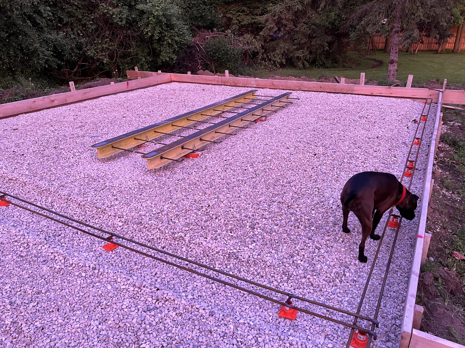

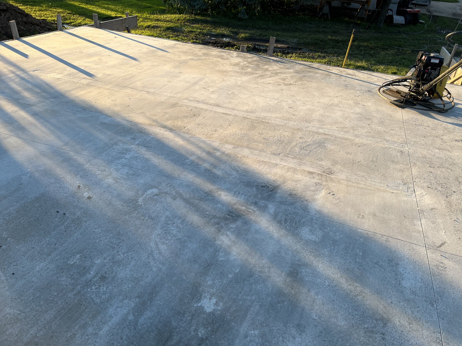

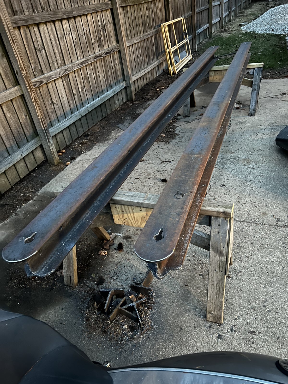

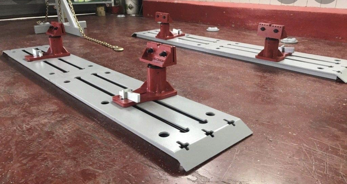

  2. Was discussing this today. I’ve seen rail road track set up like this.
    I’ve got 18-20 floor pots for hooking chains for frame repair.
    Used to do lots of ch***is repairs.
    We were talking about having a flush mounted structure to mount structural steel for ch***is building or frame repair. Then store the ch***is stands out of the way when not in use.
    Something like this but flush with the floor
    B1E98394-831E-4215-A3D1-156EE65718CD.jpeg D10516B5-423F-4CC8-9A60-76F43CB9B23C.jpeg

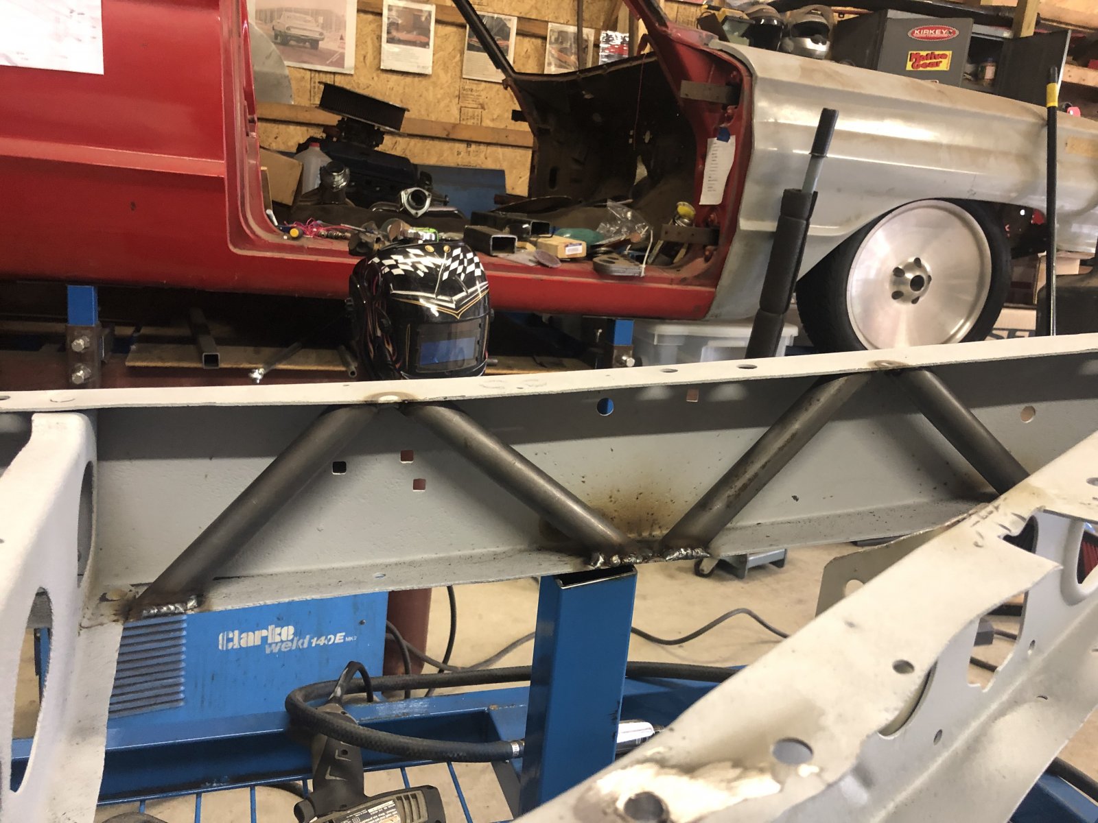

  3. BFXJason
    Joined: Jan 2, 2018
    Posts: 89
    BFXJason
    Here was my solution to boxing....and I could still get to all the mounting holes. IMG_6293.JPG
    Budget36, Ned Ludd and AGELE55 like this.

  6. gimpyshotrods
    Joined: May 20, 2009
    Posts: 24,636
    gimpyshotrods
    That's unlikely to stop twist.
    05snopro440 and clem like this.
  7. BFXJason
    Joined: Jan 2, 2018
    Posts: 89
    BFXJason
    Possibly - I should probably rephrase. Not necessarily the solution to boxing, but an improvement over stock. There seems to be a debate whether it is needed or not? I'm only in the 375 - 400 HP range with an automatic transmission, so decided to go this route. Figured it would not hurt?
    ekimneirbo and AGELE55 like this.
  8. Hemi Joel
    Joined: May 4, 2007
    Posts: 1,682
    Hemi Joel
    from Minnesota
    That is very interesting, I've never seen it done that way. Rather than boxing, you are converting the inner part of the frame rail to a truss. Trusses are known to be pretty strong.
    SS327 likes this.

  10. gimpyshotrods
    Posts: 24,636
    gimpyshotrods
    Trusses can hold an immense load, vertically.
    Take an entire house worth of trusses, lay them on their side, and leave 1/2 of the length hanging off of a flatbed, and they will curve to touch the earth.
    Trusses twist just fine.
    1oldtimer and 05snopro440 like this.
  11. twenty8
    Joined: Apr 8, 2021
    Posts: 4,240
    twenty8
    What you have done adds strength to the frame rail mostly in the vertical plane. It will have very little benefit in resisting any twist of the rail (torsional load). Early frames (post model T) are already reasonably strong in a load carrying capacity, but respond well with a little help, such as boxing. Twist is another matter. Early unboxed frames twist far too much for what we expect them to do in a hot rod situation. We add heaps more power (torque twist), and we hang our modern suspension expectations off them. Boxing is a real improvement in this respect, and improves twist resistance immensely. Your truss design is not anywhere near as effective for twist as boxing.
    05snopro440 likes this.
  12. Ned Ludd
    Joined: May 15, 2009
    Posts: 5,756
    Ned Ludd
    Flat plate, as used for boxing rails, also twists just fine — on its own.
    It isn't the additional torsional stiffness of a second flat plate which makes a boxed rail torsionally stiffer, but that the rails become closed boxes whose walls are stressed membranes which counteract torsional loads by their resistance to lozenging. A truss derives its beam strength from each bay's resistance to lozenging (whether the arrangement of bays is obvious or not) through compression or tension of the diagonal member crossing the bay. Stressed membranes and trusses are in principle structurally equivalent.
    The efficacy of a closed box in resisting torsion depends on the distance between opposite walls — or trusses, as the case may be. Being more about beam strength, early frames tended to be tall and narrow. When race car designers became aware of frame torsional effects (arguably as a result of lower roll centres ***ociated with independent suspension) their first move was to shallower but wider rails, with circular-section rails becoming the norm in the years surrounding WWII. That went first to space frames, effectively much larger rails in which all the walls are replaced by trusses, allowing stuff to be packaged inside the closed boxes; and subsequently to monocoques, which went back to stressed membranes; and hence, with the addition of detailing to accommodate bending moments at the corners of openings, to the modern OEM unibody.
    @BFXJason's design has merit, especially as he appears to have taken care to place the truss's neutral axis in plan as close to the open side of the rail as he could. Smaller-diameter or oval tubing might be better, as that would enable an even greater distance from the vertical wall of the rail. I suspect that the tubing as arranged might be more resistant to lozenging than the alternative 3mm-odd-thick flat plate, so there might well be scope for reduction. Point loads on the rail flanges shouldn't be an issue, as alternate compressive and tensile inputs should cancel out.
    But as the aforementioned race car designers found, there is only so much you can do with a rail of reasonable dimensions anyway. Sooner or later you'll want more width and height — or smaller torsional loads, which is another story entirely.
    Hemi Joel likes this.

  14. gimpyshotrods
    Posts: 24,636
    gimpyshotrods
    I would contend that as his diagonals are not in contact with each other, and this not welded to each other, that an area of focus stress will be produced in the rail flange in the gap between where they touch down. Cracking could originate there.
    Also, it appears that they are only welded on the very edges of the rail flange. While this might be an early in the process photo, physicality will prevent perimeter welding. This could result in tear-out.
    twenty8 and Ned Ludd like this.
  15. ekimneirbo
    Joined: Apr 29, 2017
    Posts: 4,218
    ekimneirbo
    An interesting solution. It should help I would think. If I was doing that, I think I would have used some box tubing. Larger 1 1/2" could **** against the side and be tacked there as well............or more and smaller pieces, say 1/2" square in a lattice design. Then road debris would be easy to rinse out. Good to see some innovative thinking. Not every solution has to be something thats the same as everyone elses solution.;)
  16. alanp561
    Joined: Oct 1, 2017
    Posts: 5,994
    alanp561
    Round tubing would be stronger. That's why they make roll cages out of it. The welds on the round tube that the fellow made the truss bracing from need to be welded all the way around. Leaving one side open leaves the weld susceptible to cracking as the frame works.

  18. BFXJason
    Joined: Jan 2, 2018
    Posts: 89
    BFXJason
    Thanks for all the feedback.
    BTW - the picture shown above is in the preliminary stages. I was able to complete the welds around the tube.
    With all the debate over boxing or not, I just decided to go with "something" better than stock. It also allowed access to running board bolts, and fluid lines.
    I did however box and brace the front and rear portion. Missing is the extra bracing in the middle of the "X" brace. IMG_8593.JPG
  19. ekimneirbo
    Posts: 4,218
    ekimneirbo
    Looks pretty good. Just as an aside, if you think about it, thats how the old tube and fabric airplanes were built and they were strong and light.:)

  21. Ned Ludd
    Posts: 5,756
    Ned Ludd
    Would it?
    It's one of those things everybody knows, but nobody bothers to verify. But looking at the actual data for a few sizes of tubing commonly required by rulebooks for roll cages, square tubes of similar linear weight and wall thickness are about 15% stronger in bending — much more so about the diagonal axis, by definition identical in tension, and pretty much the same as regards compression/buckling. The round tubes are about 10-15% stronger in torsion, though.
    Roll cages are typically partially triangulated portal frame structures, so beam strength is very much an issue. Theoretically, square tube would make for a stronger roll cage, if it were detailed correctly. I submit that the reason rulebooks require round tubing for cages is that tubing junction details for square tubing are relatively complex to get right and extremely easy to get wrong. In a scrutineering situation it would not be practical to ****yse each and every junction detail. With round tubing there is less to look out for.
    While I'm pretending, hopefully with a modi*** of conviction, to be a structural engineer, it is perhaps time to ask what we're hoping to achieve by boxing frame rails. I've been following the off-again, on-again debate around this ever since that notorious TV episode, and I don't recall once encountering any figures in all these years about how much torsional stiffness boxing a rail adds. I've mentioned above that it isn't a mere case of adding the torsional stiffness of another flat plate, so it must be more than double. How much torsionally stiffer is a boxed rail than an unboxed rail? As much as 10 times? More than 10 times?
    Try around 400 times, depending on the exact dimensions.
    The torsional stiffness of a pair of boxed Model A rails on their own should be in the order of 500 lb.ft/deg. Unboxed they are barely 1 lb.ft/deg. I couldn't believe it either. Now a pair of rails isn't a frame: the overall torsional stiffness will depend on crossmembers and X-members and K-members, and especially the details where those join to the rails. Stiff rails are no good if they can simply rotate relative to one another in the pitch plane. I wonder if a good conventional hot rod frame will achieve 400 lb.ft/degree.
    If we're only worried about engine torque multiplied by the lowest gear ratio, we are looking at the part of the frame between the engine mountings and where the rear suspension attaches to the frame (or in the case of IRS or a DeDion axle, where the final drive unit attaches to the frame.) The salient thing is that the conventional tripod mounting with an engine mounting either side and a single gearbox mounting in the middle doesn't make a lot of sense for our present purpose. Doing it the other way around, with two mountings far apart at the back of the gearbox and a single mounting under the crank pulley would mean that we'd only need to box the 30"-40" between the back of the gearbox and the rear crossmember. That — or a four-point mounting — is completely doable, given a crossmember bolted rigidly to the back of the gearbox, with a rubber mounting at each end. It'd be a lot of stiffness for very little weight.
    In fact some gearboxes of the '20s and '30s were designed with "wings" cast into their cases for that exact purpose. Another way is the way Porsche tied the transaxle to the engine in the 924/944/968/etc. and 928 by means of a torque tube.
    With modern unibodies, dealing with multiplied engine torque is the least of the designer's concerns. It is all about suspension tuning, given a commitment to a dynamic paradigm which takes ample torsional stiffness for granted. I won't elaborate on my ****ysis of how that came about, as it is complex and necessarily deals with political economy. The upshot is m***-produced unibodies that do 24000 lb.ft/degree or stiffer. As we'd be lucky to reach 2% of that it would be stupid to buy into that dynamic paradigm. Alternatives are possible.
    A word on X-members: the way to understand them is to consider the left and right halves of them as part of the respective frame rails. Imagine the tops and bottoms of the resulting triangles boxed with horizontal flat plate, so that that part of each rail becomes a wide boxed rail, roughly triangular in plan, and plenty stiff in torsion. Now, replace the upper and lower plates with trusses in the horizontal plane — easy as the triangulation is right there — and we're back to an X-member as we know it.
    ekimneirbo, rod1 and Elcohaulic like this.

  30. 05snopro440
    Joined: Mar 15, 2011
    Posts: 3,501
    05snopro440
    I ran across this thread and needed to chime in on some of the speculation.
    I'm a materials engineer (steels, plastics, welding, etc.), and in my line of work I regularly look at failures in RV and trailer frames, which are often manufactured similarly to our boxed hot rod frames. By not continuously welding the frame, you are creating a stress concentration at the end of each weld. Say if you weld 4" lengths with 4" gaps throughout the frame. In the unwelded areas the frame and plate can flex a bit, and then it's more rigid where the weld is. This makes the end of each weld a possible spot for crack initiation. If the entire length is welded (***uming a good quality weld with no defects), your stress concentrations are each end of the weld which are typically near the crossmembers and therefore should have less flex and less chance of cracks starting there.
    More disconnected welds = more chances of failure.
    I've seen this in trailers where pieces aren't continuously welded or where a boxing plate stops. Those are the areas where the fracture starts.
    Strength-wise, what you describe is probably adequate. However from a failure prevention perspective it's not a good practice. As described above, the reduction in stress concentrations is best for longevity of the system.
    That design is actually likely to create more severe stress concentrations. The solid boxing plate isn't necessary. Boxing plates with "lightening" holes are fine, because large radiuses reduce stress concentrations. The design you have makes nearly a 90° corner at the end of every weld, which is a stress concentration and you also have less material in those areas, so more chance of flex.
    3/16" is used so that it can be tapped, as you said below. It's not necessary, but it makes things easier for the fabricator.
    The amount of elastic movement (twist, as you've described), that a metal can withstand depends on a number of factors, but basically that twist needs to stay in the elastic range of the material, and not be permanent. If you look at marketing for modern pickup frames, they talk about rigidity. Automakers limit twist as much as they can in order to improve handling and road manners and reduce the chance of failures, but they also need to keep weight down for economy purposes so there is a balance.
    Not really a performance improvement, but there's good reason for it.
