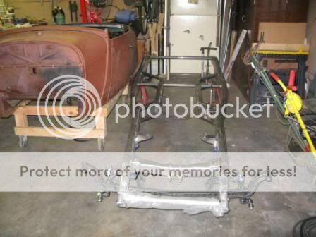

    The story: This is my first build, but have grew up building cars with my dad...My first car was a 70 SS chevelle buolt by my dad and myself. (still wish I had that car). At any rate I decided it was time that I build my self a hot rod and I have always liked model a roadsters Highboys. The opportunity came for my to purchase a '29 roadster body and '32 frame rails so I pulled the trigger...the Mrs. was not to thrilled.
    What I have done so far:
    1. I had the frame pinched by the guys at Kiwi konnection
    2. After pinching the frame rails I boxed them.
    3. Installed front and rear cross members, After fitting the body to the rails several times and bobbed the frame.
    4. built the center cross member
    5. Mocked up motor and trans., tacking in the motor mounts.
    6. Set up front suspension,
    7. Narrowed the rear end to 59 1/2"
    8. Set rear 4 bar suspension. Made this fully adjustible by using tubing that is threaded on both ends. One end is a left hand thread, the other end is a right had thread. This allows me to move the rear axle with out having to take the linkage apart.
    9. Started mounting the body. Removed some of the rear sub frame on the body so the body would go over the '32 rails kick up in the rear.
    10. Pie cut the front cowl to eliminate the gap between the body and the frame.

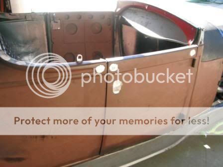

    A lot more fitting and welding has taken place since I last posted... The body has been bolted to the frame, rear sub rails cut out and re-shaped to match the up -kick of the '32 rails, rear corners patched, and the front cowls have been "pie cut" so the body would sit flat on the '32 rails. Radiator, grille shell and hood and latches installed...hood sides to follow later this week. Here are some current pictures:

    I Spent the afternoon fitting the hood sides and the hood. Here are some pictures today's work/progress...
    I'm still have a ways to go before the hood and sides is done,but I think that they are shaping up very nicely.

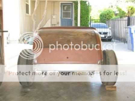

    It's been awhile since I've posted...so here is an update. I was able to take advantage of spring break last week and get some stuff done.
    Installed the trunk latch in the inner curved panel ( I plan on shaving the trunk handle)
    Installed the rear roll pan
    Took apart the front sheet metal on the car and fit the motor and transmission.
    I will have to trim the bottom of the firewall due the transmission just barely hitting it.
    Since I had the motor in the car, I installed the front shock mounts
    Set my seat in the car to see how it fit (the seat came from Bengels, and I could not be happier with the quality, fit, and his customer service.)
    Started filling in the holes around the car ( I still have to do the fender wells and trunk lid.

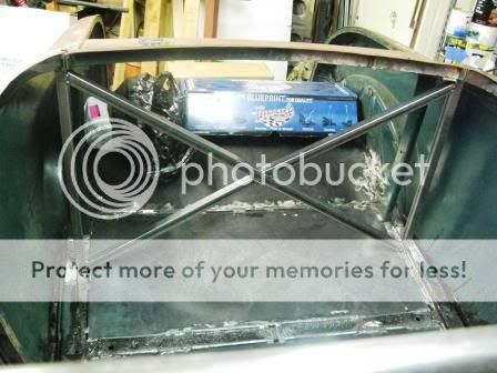

  28. bp1971
    Joined: Apr 11, 2010
    Posts: 520
    bp1971
    from Fresno, CA
    I spent some time this evening making the cross brace behind the seat. The plan is to attach the bulk head that will separate the driver form the gas tank. The brace really stiffened the car up.
