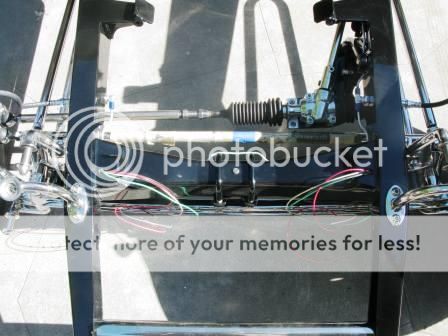

    Progress update...Since I last posted I have done a few things. I have installed the lime works steering column and mocked up the steering (need to do some minor adjustments, but everything clears and works well).

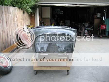

    Over the past few weeks, I stripped the body down to bare metal and finished filling in the holes on the fire wall. Today the body, grille shell, hood sides and other misc. parts went to the body guy. He was happy to see that I stripped the car for him... Very excited to see the finised product.

    I stopped by the body guys house today to check on the the progress... the body work is off to a great start!!!!

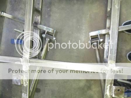

    After a long break, I 've decided to change directions a bit with the rear suspension... I removed the parallel 4-bar set up with exception of the brackets on the axle and went with a ladder bar/coil over set up using the coil over brackets on the axle. I figured now was the time to do this while my body is still in body work. I think they came out great!!!

  16. I really like the way you did your trailing arms. I'm soaking up ideas off the HAMB for when I start the re-do on the ch***is for the grease*******.
  17. bp1971
    Joined: Apr 11, 2010
    Posts: 520
    bp1971
    from Fresno, CA
    Thanks Mike. It took a bit of planning, but I think the ladder bars came out great too. If you need better pictures I would be glad to send them to you.

    Update: I finally got around to painting the motor and transmission and getting them mounted back into the frame. This past week I installed my drive-line, the exhaust up to the mufflers, transmission cooloing lines and solid fuel line. I will be getting the body back from the painter next weekend, so I hope to have the brakes bled, vac. lines hooked up, and the trans mission lines completed. We'll see...
