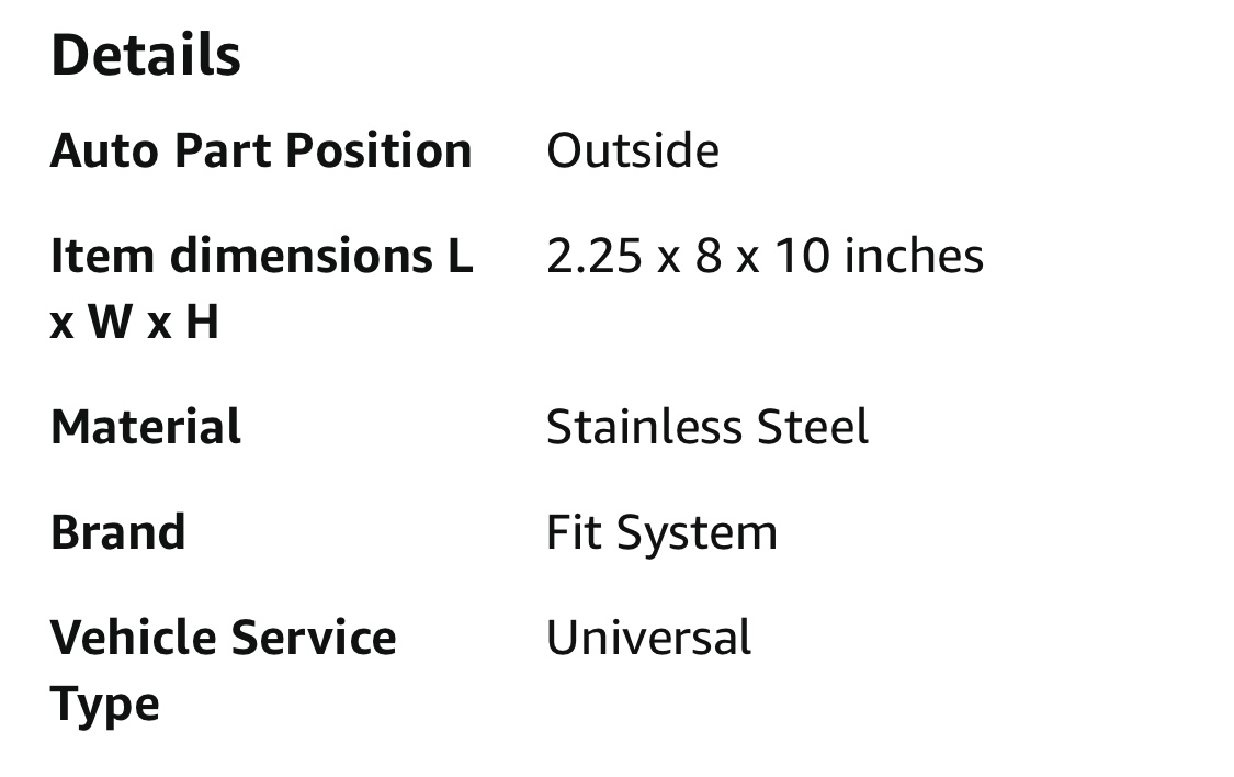

  3. Hotrodjohn71
    Joined: Feb 25, 2018
    Posts: 137
    Hotrodjohn71
    Thank you, Johnny.
    I have been considering those although they are smaller at 5x7.
    I would like to use the bigger mirror because I pull a trailer from time to time

  5. Johnny Gee
    Joined: Dec 3, 2009
    Posts: 14,477
    Johnny Gee
    from Downey, Ca
    This is what the description say’s. Send a question to them to verify. IMG_2811.jpeg
