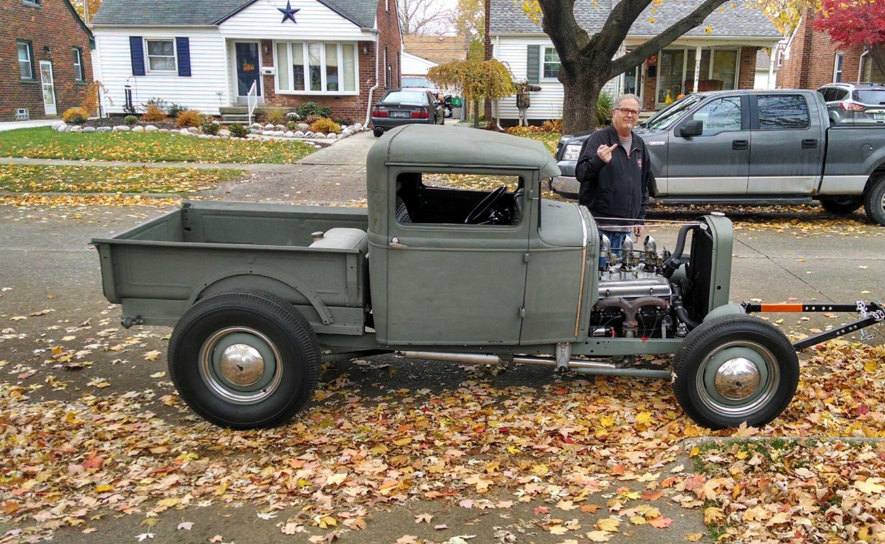

  14. F-6Garagerat
    Joined: Apr 12, 2008
    Posts: 2,652
    F-6Garagerat
    Cool project, body looks real nice. As far as tires, I had an old truck I had 16x650's on the front and 16x750's on the rear and thats a bigger difference than your tires. It was fenderless and I hated it. Fronts were way too big.

  16. F-6Garagerat
    Posts: 2,652
    F-6Garagerat
    Personally I like the 16x500/525 on a 4" wheel for the front but thats just me.

  18. F-6Garagerat
    Posts: 2,652
    F-6Garagerat
    Yeah that's what I run on my AV8 pickup with a 3" dropped model A axle. Gets the front down. A lot of guys had issues with the 16x425's being out of round a while back around the time I was buying tires. The 500/525' are almost the same overall diameter.

  21. F-6Garagerat
    Posts: 2,652
    F-6Garagerat
    Yeah on a channeled car the 750 might come out of the wheelhouse too much. 16x650's and 16x500/525 would probably look right. In sure someone with that combination will chime in with a pic.
