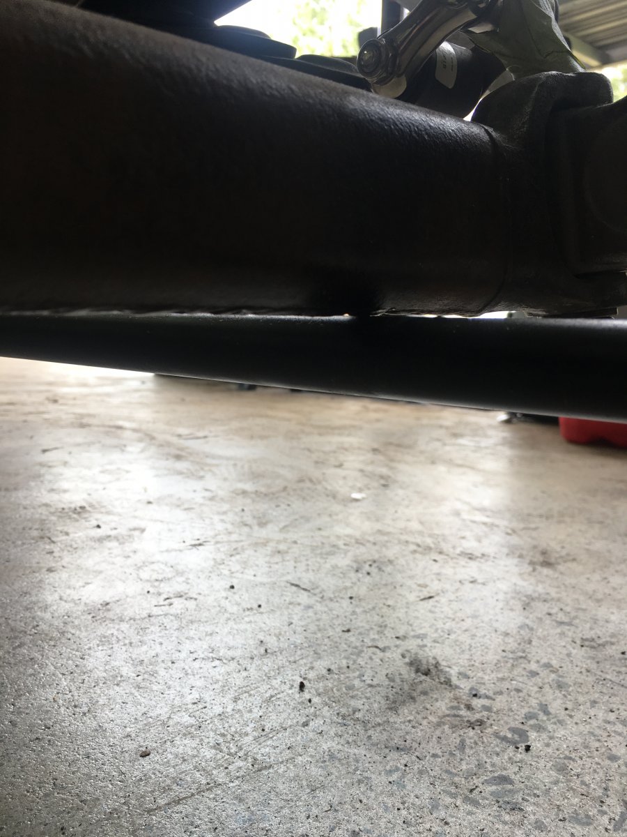

    So here's the problem I have with the tie rod, I've used socal deep drop steering arms and using a 4" drop axle, using stock split bones the tierod hits on the under side of the bones and I still have maybe a quarter inch still to go into the steering arms. IMG_2672.JPG IMG_2673.JPG IMG_2674.JPG IMG_2675.JPG
    I scored a set of original square back spindles I think I'm going to swap out, heat and drop them but should I also go for the later 37-41 wishbones aswell, the ones that step down after a few inches?

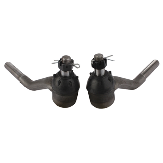

    46-4? Ford pickup tie rod ends are your solution :)
  20. Tim
    Joined: Mar 2, 2001
    Posts: 20,810
    Tim
    from KCMO
    Speedwaymotors.com part number
    910-48640
    1948-1964 ford truck
    brEad and brainfreeze like this.

    holy ****! that looks like exactly what I'm chasing! would be the easiest fix! and still be high enough from the ground not to worry about!
    thanks Tim!

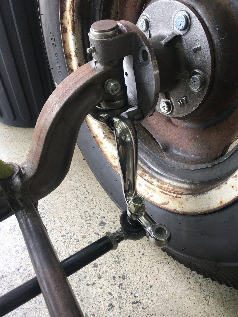

    Also got my dropped tie rod ends in the mail today so I'll test fit them tomorrow and see how it looks! Hopefully fixes that problem, just hope the tierod doest end up too low
