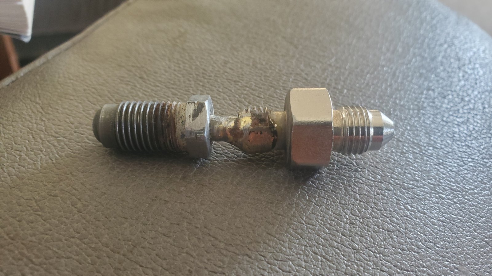

    I need this 3an fitting..
    Maybe a source and part number.
    Thank you
    Terry aka dirt t

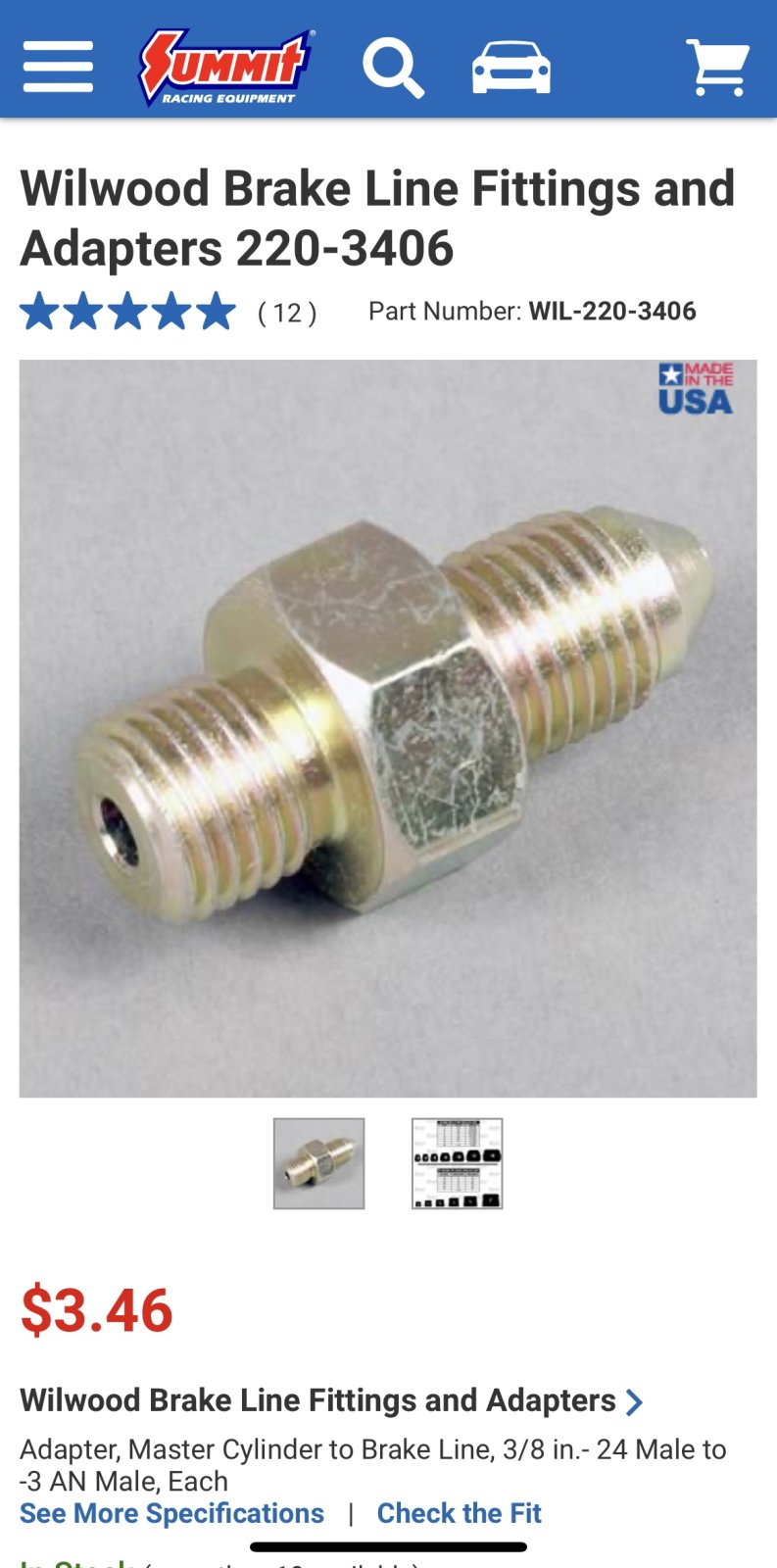

  2. I know Summit has a large selection of fittings. They are not going to have one like that but they do have 3an to 1/8 npt or inverted flare.

    Is that a bubble flare on the left end? And what thread is the flare nut?

    It's not an both ends. One end is standard brake.

    Yeah, that's a bubble flare, not the good old inverted flare that I'm used to.
    Is it SAE or metric thread?

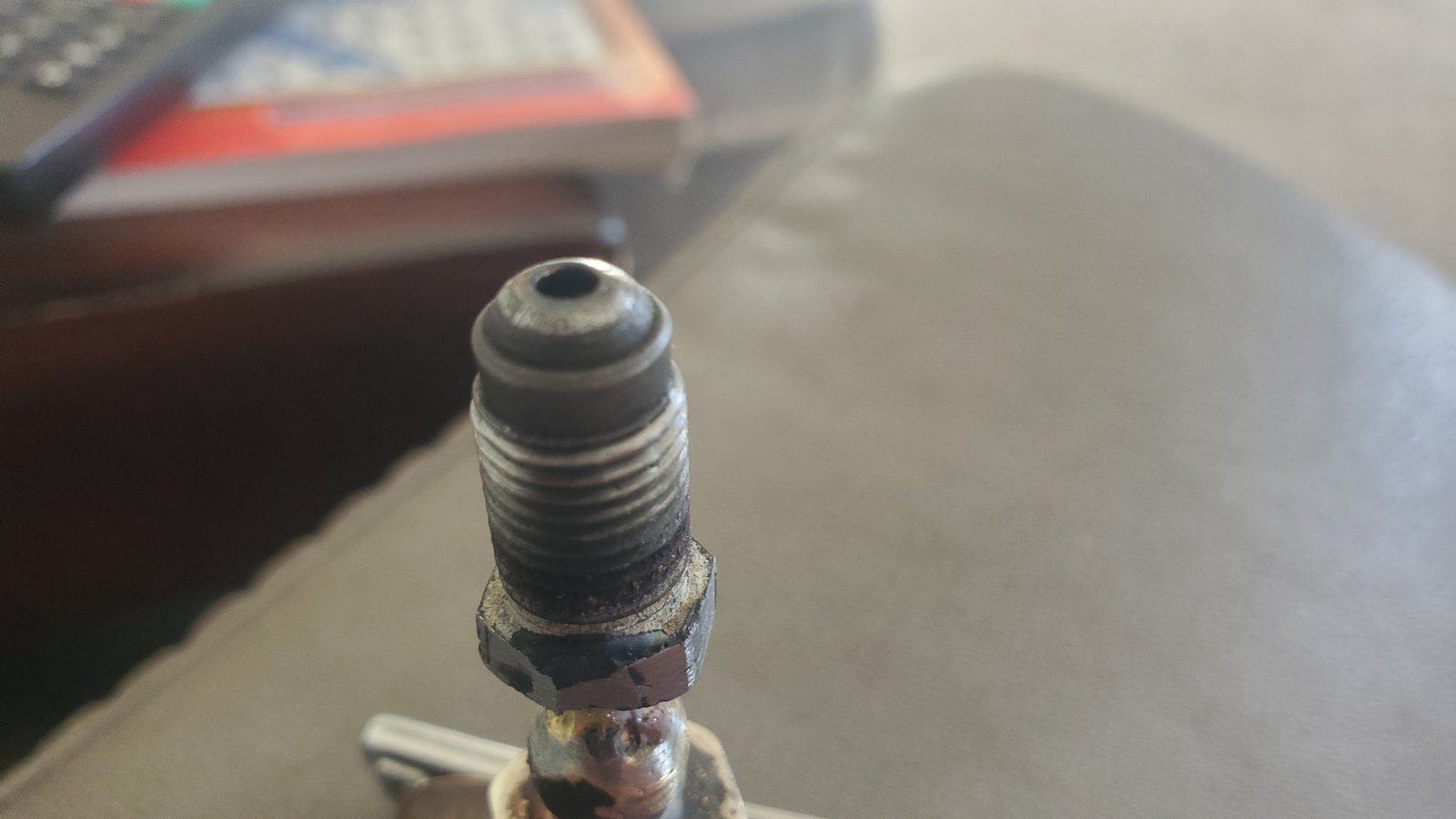

    what exactly does it fit into?

    I believe these might work if the bubble flare isn’t mandatory, there’s a generous face, would that seal?

    Speedway has fittings that go from 3an to standard line, I just used them on my Henry J

    Your right, I missed that! My bad. I've not seen one like that having searched my usual sources, but that doesn't necessarily mean they're not available. Closest is the metric version as indicated by Hoptup32, but being metric that's not going to work, the thread isn't remotely close. It may prove you'll be needing something made or modified. The seat in the cylinder seems logical, or perhaps the easiest might be to take an aluminium 3an /3an adapter (the thread should be ok) and turn down, or even sand on a drill, to make the bubble end. Any mismatch should be capable of being overcome with gentle force forming the aluminium.

  19. Our local auto parts store sells different lengths of brake line that is flared on both ends and comes with fittings installed. ALL of the lines that come with a bubble flare have metric fittings, ALL of the lines with the regular inverted flare/double flare have standard fittings. You have a bubble flare, suggesting to me that you probably have a metric fitting.
    If you can figure out what your thread is and what the fitting is going into, it might be easier to answer your question.
