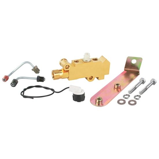

    Maybe try a hold off vavle for the front. Keeps the front discs from actuating until the rear drums catch first. Speedway sells them for disc/drum setups. Bigger rear wheel cylinders would also be on my list, the 15/16" size.

    I believe he means proportioning valve lol

    go back & get the proportioning valve off the s10 & it should work fine

    A proportioning valve is a patch up method that people use when they "Get out of their depth"

    Sooo, all those brake engineers from Bendix, GM, Mopar, KH etc. must have been "out of their depth" when they designed proportioning into production disc/drum and disc/disc systems. :confused: Learn something every day. :rolleyes:
  12. Kerrynzl
    Joined: Jun 20, 2010
    Posts: 3,516
    Kerrynzl
    No, but it sounds like the average F***wit is out of their depth .
    Those proportioning valves you are referring to , are actually pressure limiting "regulators"
    When they get to a maximum pressure or higher, they don't allow that higher pressure to pass through.
    They do not proportion the fluids at lower pressures. This is what Fluid mechanics do.
    Anybody that uses a proportioning valve to fix their mismatched cowshed engineering is a real F***wit, that should stay away from cars.
    If you had a poorly balanced brake system with a proportioning valve, and the traction conditions were less . You would be in a dangerous situation because the brakes [at one end] would lock up before the maximum pressures were obtained.
    A true proportioning system is Twin master cylinders with a balance bar.

    Since I'm a "F-wit" I'll not tell you how a proportioning valve REALLY works....""A true proportioning system is Twin master cylinders with a balance bar."" Yes after you adjust the balance bar...

    Bruskie...I doubt the S10 valve will be of any help. The front calipers are much larger than s10 calipers and that will throw a monkey wrench into its ability to do its job properly.
    Loudbang...the brakes are properly adjusted. I immeadiately checked that once I realized that there was a potential issue...and while they did adjust a small bit due to the new shoes bedding in...it had no noticeable effect on the rear brake effectiveness.
    Hnstray...I feel you are dead on when you say you want the fronts to do a greater portion of the braking...but my butt is telling me they are doing a little too much! LoL I'm weary of doing full on panic stops on pavement with my small diameter hairpins. They have been there for years but don't have any tie braces between the upper and lower bars. I'm not fussy on that and will be adding them over the winter to increase strength. Until then I will save the panic stops for times of real panic!
    Kerrynzl...I don't want to change the fronts as they work great with nice pedal feel...not to mention that changing the calipers will require changing the mounting brackets and potentially the master cylinder. I think its a lot simpler and more likely to keep that good pedal feel to go with a change in the rear. I have to see what the big mid-size Chevys were running back in the mid 70's and see if something of similar size will match up to the S10 backing plates. Who knows...maybe the mid-size wheel cylinders are a direct bolt on!
    Regarding the bantering back and forth over use of Proportioning valves. Its pretty much a moot point as I don't think adding a proportioning valve will help my issue in any way. I need an increase in braking effectiveness to the rear...not a way to limit it.

    DO NOT put a proportioning valve on the front system, these only limit the "increase in pressure" beyond a pre-set maximum pressure [ this can have adjustable spring pressure ]
    Manufacturers use these proportioning valves on the rear to prevent lockup under extreme weight transfer and braking. They normally have more rear bias dialled into the car for normal braking conditions or mild braking [wet weather etc].
    If you removed the proportioning valve from a car, with normal driving you wouldn't even notice the difference, UNTIL you jump hard on the brakes which causes the rears to lock.
