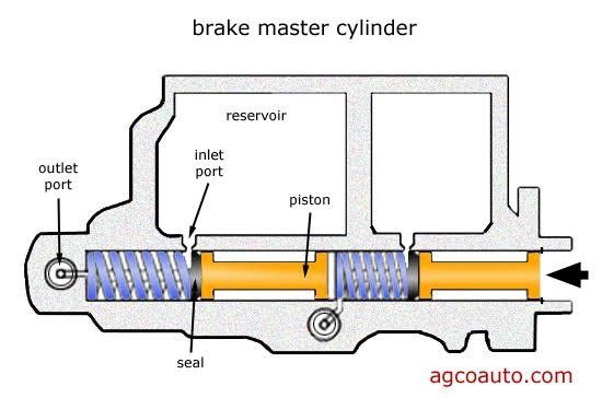

    That could well be the issue right there. If the inlet port from the reservoir to the cylinder is covered no fluid will flow.
    I'm not out ruling the concept that the piston in the proportioning valve is stuck to one end and not letting fluid flow .
    Back in my early days of doing mechanic work as a job I had the pressure differential valve in a combination valve go to one side and actually break the tip of the brake warning light switch and ended up having to take the whole valve apart to get that chunk of plastic out and then make a trip to the dealer to buy a switch out of my pocket at lunch. My screw up I fixed it and the parts house across the street didn't have one. If that valve/piston is stuck to one side that may be the issue.
