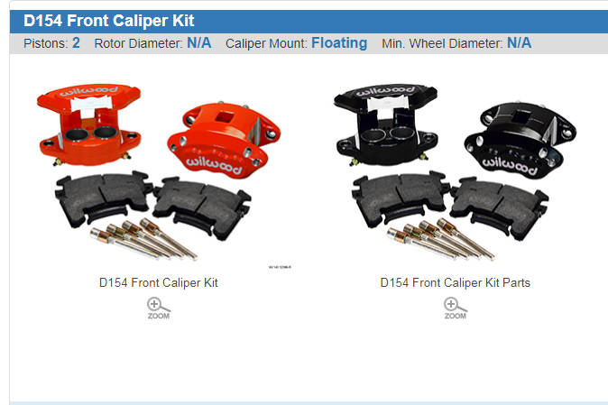

    My Wilwood calipers are 4 piston and no floaters.. I’m not aware of Wilwood floating pistons.

    They are a replacement for GM metric low-drag callipers
    joel, jaw22w and jimmy six like this.

    OK.. never had a catalog. I looked them up for kits for different cars using stock spindles and only showed individual piston sets in 4 or 6. But since they are in the aftermarket brake business it would only make sense. Brakes are a secondary part of their business.

    Thank you. That is the style I have, but what is shown is the dual piston caliper. Mine are the single 2-1/2" piston with 4.90 sq. in. The 1.62 duals are 4.12 sq. in.
    I went with this style because that is the bracket style already on the car.
