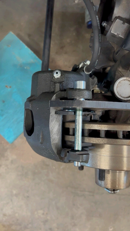

  8. It might be the picture, but it appears the pins are at an angle and not perpendicular to the rotor.
    Tim, Unkl Ian, nochop and 2 others like this.

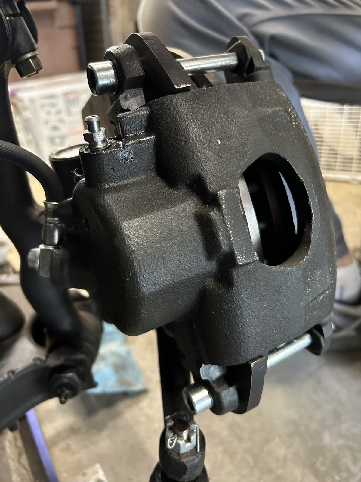

  11. lothiandon1940
    Joined: May 24, 2007
    Posts: 32,579
    lothiandon1940

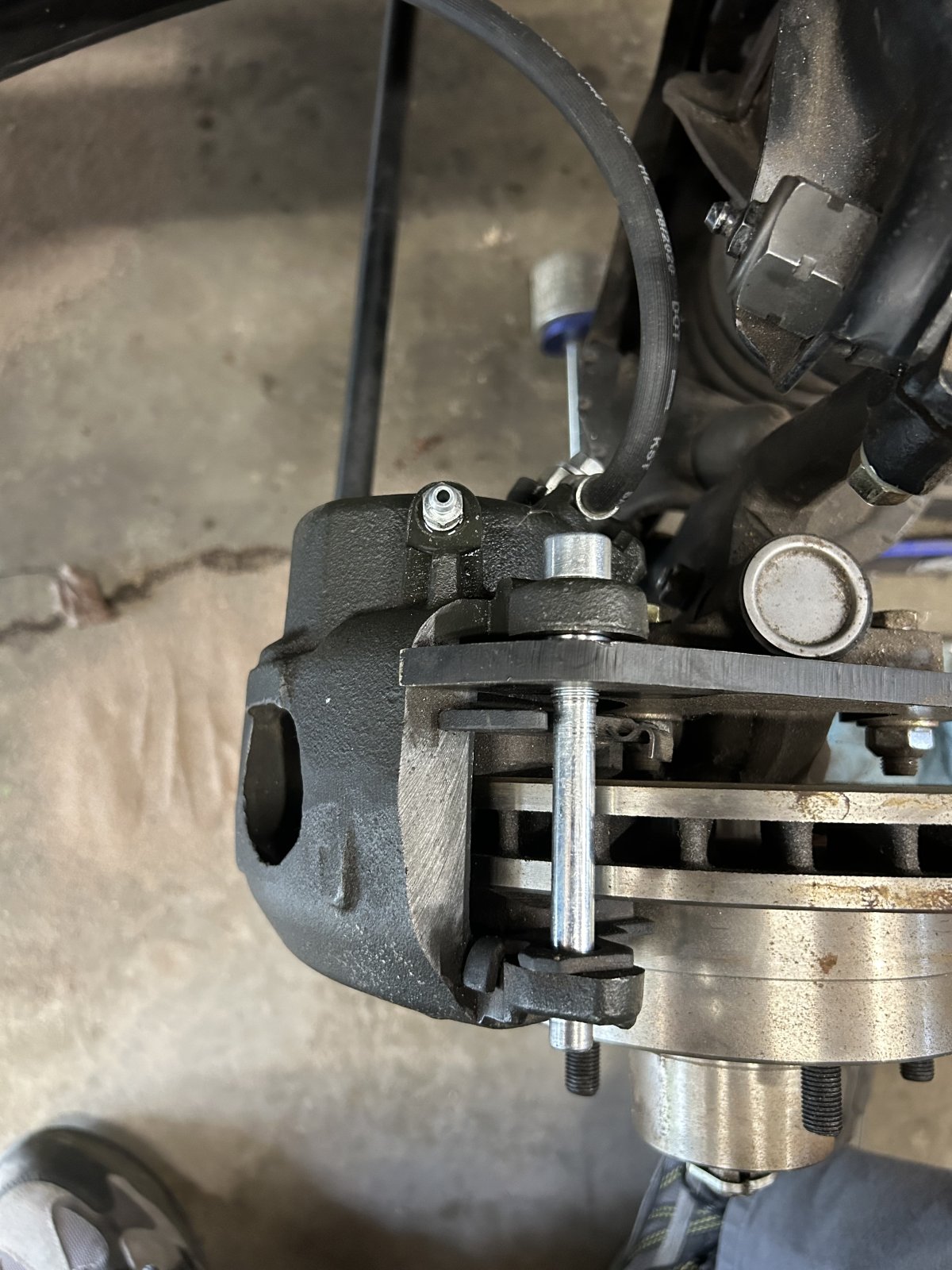

  12. rattlecanrods
    Joined: Apr 24, 2005
    Posts: 529
    rattlecanrods
    From the GIF, it looks like there is way too much slop between the pin and holes on the inboard side. It's it missing a guide bushing?

  13. 67drake
    Joined: Aug 8, 2008
    Posts: 818
    67drake
    from Muscoda WI
    “It might be the picture, but it appears the pins are at an angle and not perpendicular to the rotor.”
    I agree. In the second pic the pins seem to “spread out”. I would pull the rotor and pads back out and ***emble without them. The caliper should slide freely on the pins and give a better idea of what’s happening.

  22. gimpyshotrods
    Joined: May 20, 2009
    Posts: 24,566
    gimpyshotrods
    Those are clones of GM Metric calipers. Those were used from about 1978-1988, or so.
    Anything GM G-body (Monte Carlo, Malibu, Regal, etc.)
    If they were OEM, they would have GM raised on the side.
    The clones vairy greatly in quality. I pretty much limit myself to Afco calipers, unless I can score OEM ones.

  28. lostone
    Joined: Oct 13, 2013
    Posts: 3,649
    lostone
    from kansas
    Are ALL of the o-rings in the caliper ?
    There should be four, one in each hole. To me it looks like the outside holes may be missing theirs. Or the o-rings are too thin, soft etc allowing excessive movement.
    If they are there I'd almost be tempted to buy a good quality caliper rebuild kit from Napa and replace the o-rings and hardware from the Napa kit onto this caliper and see what happens.
    If it fixes the problem I'd buy another kit from Napa and install it in the other caliper just to be on the safe side.....

  30. CageyCustom
    Joined: Dec 3, 2022
    Posts: 15
    CageyCustom
    The o-rings might not have been in when the pictures were taken, but they are all there. I could not actually measure the groove where the o-ring sits, but rather the diameters on each side of the groove.
