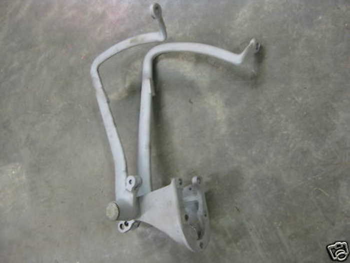

  7. chopt top kid
    Joined: Oct 13, 2009
    Posts: 959
    chopt top kid
    ** OFFICIAL ** hot rod clutch brake pedal thread !
    The pivot shaft on my F1 pedal assembly is only about 5 3/4"...
