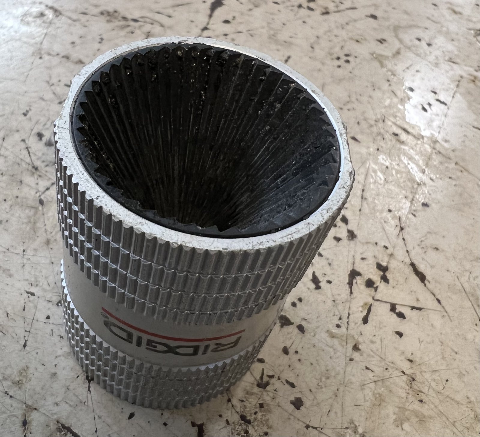

  30. TRENDZ
    Joined: Oct 16, 2018
    Posts: 386
    TRENDZ
    FFA437AF-47E7-4854-9C76-E3D11259F2AA.jpeg As recommended, no tubing cutter. Work hardening makes steel or ss more likely to crack while flaring.
    A nice square cut with a good deburing inside and out is also essential to minimize the likelihood of cracking while flaring.
    With 3/16” tubing I use a drill bit by hand to debur the inside, and a hand file for the outside. All other sizes of tubing I use a Ridgid brand tube deburring tool.
    I also strongly recommend the Eastwood flaring tool. It makes the job much nicer to do, and the results are terrific with stell or ss.
    I personally don’t like using the nicop, but I’m admittedly a little strange.
