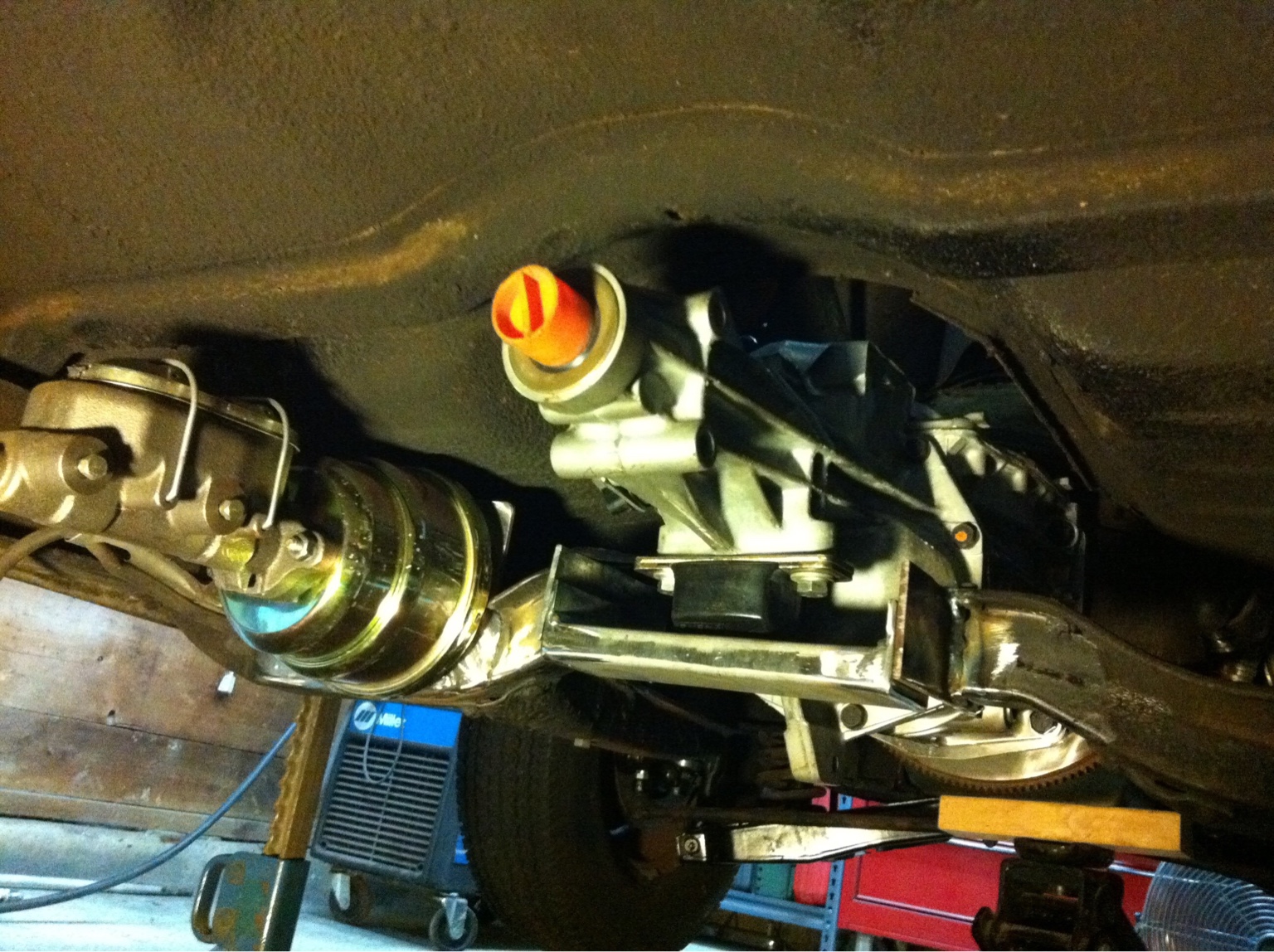

    A while back I added an "upgrade" to my 52 Chevy styleline by installing a set of disk brakes up front and a master/booster combo under the floor off a fabricated bracket welded to the crossmember. I had read thru a bunch of old H.A.M.B posts about what guys were doing and I formulated my own approach. The mounting and brackets are not where I'm having the problem. BTW thanks H.A.M.B. for all the old posts and search option!!
    All new 3/16 brake lines front to back, new 1 3/16" master, small 7" booster, all new rubber lines front and back. New rear 1" wheel cylinders. New large GM (not metric) calipers, pads, and rotors. 2 LBS RPV to the front (because the master is under the floor), and 10 LBS RPV built into the proportioning valve to the rear. After driving the car for a while I noticed the front dove on deceleration and would sit still on declines with the clutch pressed in, so back to the H.A.M.B. I went and read what people had to say. A lot of posts had said that RPVs aren't needed in some cases and to remove them. I removed the 2 LBS RPV and the brakes unlocked. Now that the RPV has been removed I can't get volume to the rear. I'm able to bleed the system but it trickles out like an 80 year old man with prostate issues.
