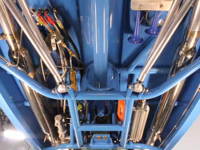

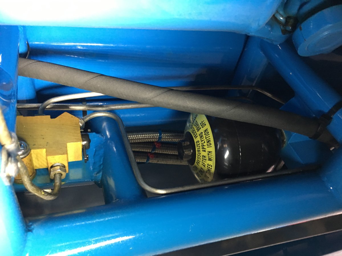

    I am trying to identify the system design for these brakes. I have sent pictures to many experts and no one can identify the system design. At times the pedal becomes extremely hard, no ***ist. I expect its a faulty pressure ac***ulator (black sphere). Has anyone seen this type of system before? Thanks!

    That's a GM master cylinder, it appears with the pressure ac***ulator it's a hydro-boost system. Looks to be a big mess. With a bunch of different unions. That's kinda scary.

    It is scary! I get what you're saying but it does Not have power steering so how can it be a hydro boost system?

    Those hydraulic hoses, what are they for then. That is some weird stuff for right there

    They go to the M/C and prop valve. See pic. The black sphere is the ac***ulator. I have only ever seen these on high end cars like Mercedes and Maserati (and the occasional Buick).

    Electric power brake booster.

    The reservoir is in the trunk (top pic). The actual M/C is under the floor so the hoses run from the reservoir to the M/C. I just don't know what the silver can (cylinder) is under the reservoir.

    The reservoir can be anywhere, as long as it is bled, and has no leaks.
    The silver can is the electro-hydraulic pump that provides boost pressure.

    Wow, thanks gimpyshotrods!!!!! You win! I don't immediately see any electrical wiring, but maybe I am just not seeing it. That "silver can" I referred to might be the electric motor. I need to crawl up in there and look. You have helped a ton! I have read that these ac***ulators are notorious for going bad. I'm glad I bought a spare!

    There should be an electrical connector on it somewhere. Feel around.
