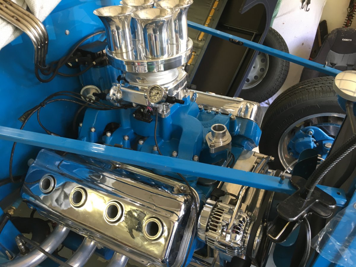

    So, I am finally done with all of the other stuff and am putting the roadster back together. I haven't installed the tank with the in tank pump yet. Today I did check the electrical system and cranked the motor. I noticed the "wurring" of the brake motor. I never realized it before because of the loud carter fuel pump. Thanks to you all, I now know that is the electric brake motor. Is it supposed to run continuously? It never stops when the key is on.

    I will be firing it up in the next day or two. Then I can get a feel for how much vacuum the engine pulls. It certainly does not sound like a radical cam. Crossing my fingers....
