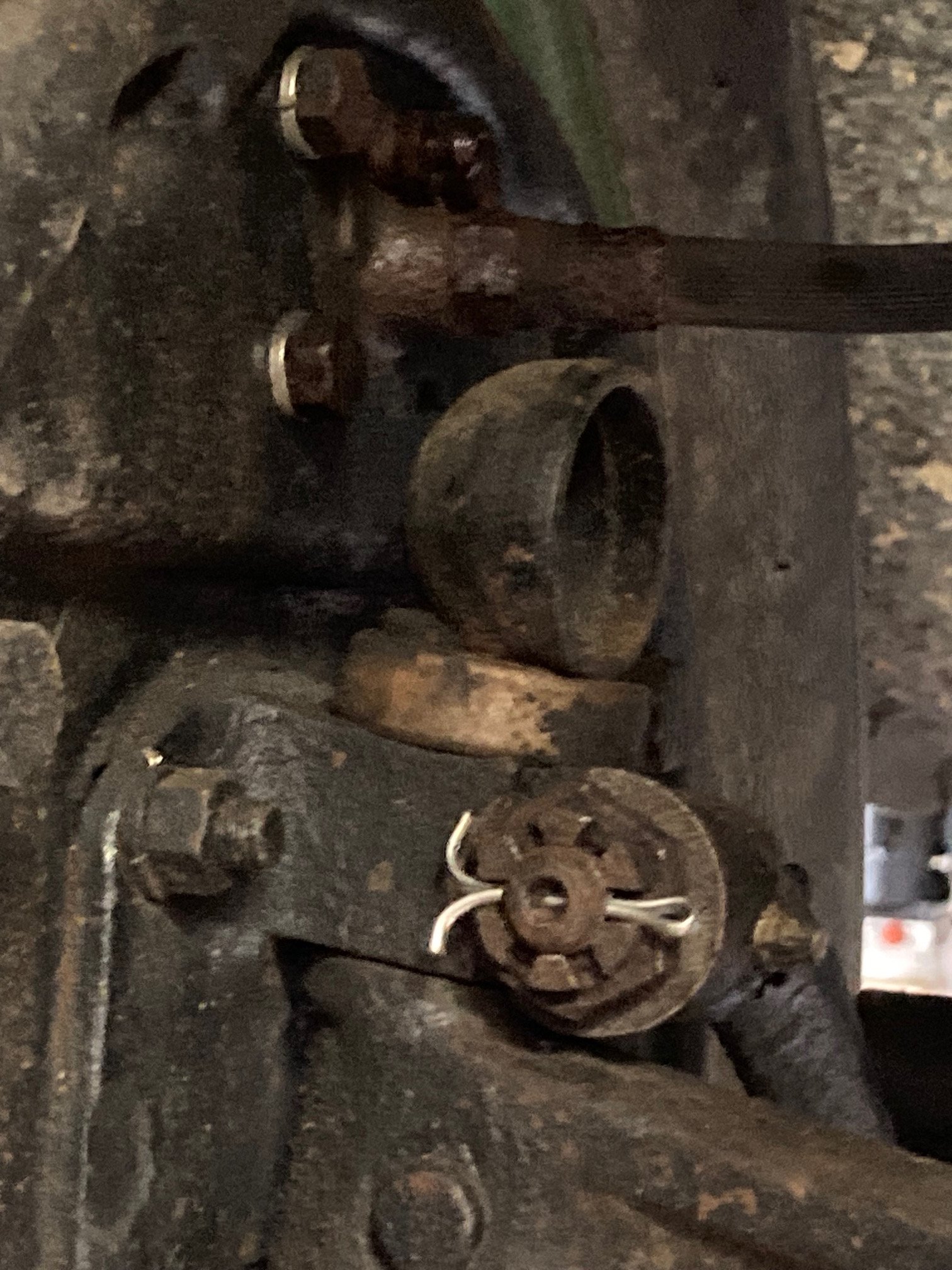

    Interesting how you would know this? I decided to work backwards yesterday and see what the wheel cyl could tell me.
    They are-Wagner Lockheed FD-2766
    I think the problem is this is not a common wheel cylinder. the thread size is 7/16 x 20 and new ones commonly have 3/8-24. from what i see on line
    So i am working this angle now. I may need to have the two hoses made, then what if the cylinders are bad. so may be time to replace the hoses and cylinders with new.
    I have a few hoses ordered, but not confident.

    I would say that as I recognize the characteristics of the backing plate in your picture as belonging to '42-'48 Ford Lockheed brakes.
    Regarding the thread size; I have been working on Lockheed brakes since I was in HS back in the '60s and they have always been 7/16. The Raybestos WC8264 & 65 that I bought a couple months back still had 7/16 ports.
    After your post; I looked up some other listing and saw that Dorman said their cylinders were 3/8; interesting that someone would reengineer specs of a part after 87 years.
    Would be an unwanted surprise to someone fixing their brakes and finding a different thread size.
    Maybe a modern Chinese thing; on the other hand most all wheel cylinders are made their now-a-days anyway.
    Anyway if you did end up with 3/8 threaded wheel cylinders; looks like there would a good choice of hoses that would work for you.
    Just be sure to anneal the copper washers as the new ones are too hard.
