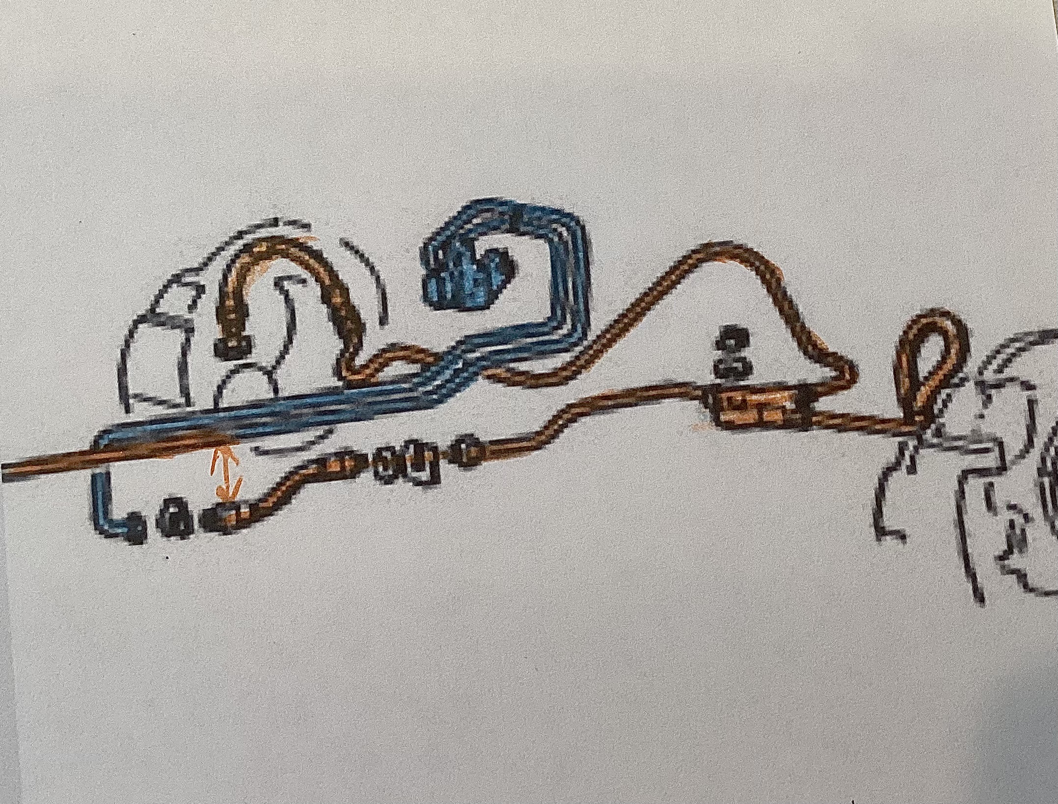

    IMG_1763.jpeg Thanks guys. I ***umed that was the case. When I looked up brake hose, some of the listings said: gas line, brake fluid line, transmission fluid line. Gas line, I have in several sizes. Brake fluid is so strong, I figured it wouldn’t work. I think the PO used gas line, that is one of my issues with the brakes. Hopefully, it didn’t dissolve and get into the master cylinder and lines (which the PO installed new)… the two reservoir lines don’t match, and one has a bubble on the side… I just eliminated some over engineered Italian brake parts on the rear brakes. The rear has a cut off valve, that cuts the brake fluid to the rear brakes under hard braking, to prevent the rear brakes from locking up. No easy way to check if it’s adjusted properly, and I’m just going to be driving this that hard. I connected the rear brake line directly to the brakes, and (orange View attachment 6464296 View attachment 6464296 View attachment 6464296 line) eliminated the valve

    I replaced that valve on mine...don't know if it did any good...but also had a leak back there that didn't want to go away. But I sold the car, so next guy got to deal with it.

    These prop valves are usually called 'compensator' valves. As long as the linkage to it is not mangled and moves freely with suspension travel it should work fine.
