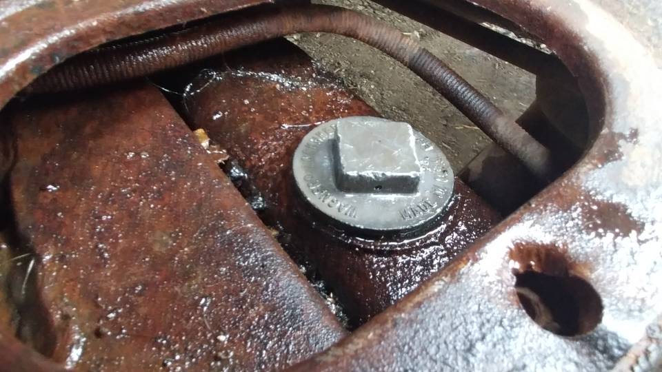

    I have a 1950 dodge meadowbrook, i have adjust all the shoes, bleed the brakes and adjusted the pedal. If i hit the brake pedal it goes all the way to the floor, if i let off and hit it immediately it goes 3/4 of the way and stops with full brake. [​IMG]
    After hitting it the second time and letting off after a second or two brake fluid gushes out the 2 little holes on the master cylinder cap.
    What am i missing to get full brake pedal everytime?
