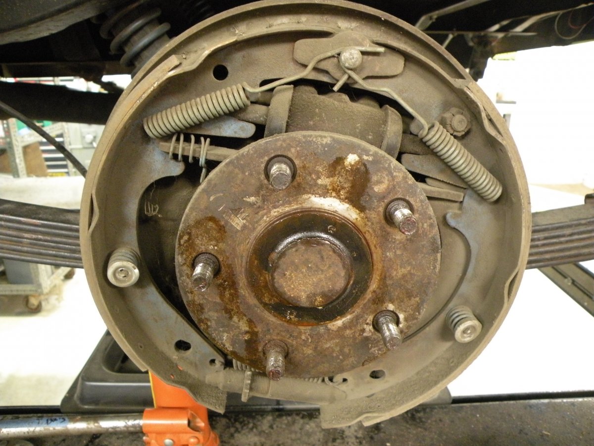

    I took a look, and they are the same on all 4 corners: 11x2" and the wheel cylinders are all the same.
    I have not done any cleaning, this is how they looked when the drums came off.
    Everything looks new and dry, and the drums look as if they are new or recently turned. The adjustment was ok.. Pretty hard to rotate by hand on the drums, but feels more like a slight drag when the tires are on.
    Is this a Chevrolet style brake?
    The only difference I noticed was the brake linings. The fronts look to be a grey color, while the rears look like they are a bit reddish in color.
    I did a close inspection of the brake lines, and no kinks or pinches anywhere. I suppose the flex lines could have an internal issue, but from the outside everything looks to be fine.
    It looks as if we've narrowed it down to being a weight bias issue..The rear end is just too light.
    Now how can i adjust the brake pressures to prevent the rears from locking? This truck will never see a load in the back.

    The brakes are Bendix design and normally found on Fords.
    The front wheel cylinders should be larger internally than the rears, so take the time to actually measure all of them. Odd why the front and rear linings are different, but the same width. I would think about replacing them with matching linings.
    An adjustable proportioning valve may be needed to reduce rear braking and prevent rear slide. But first make sure the front wheel cylinders are larger than the rears. You don't want to limit rear braking when the front brakes are not doing their share.
