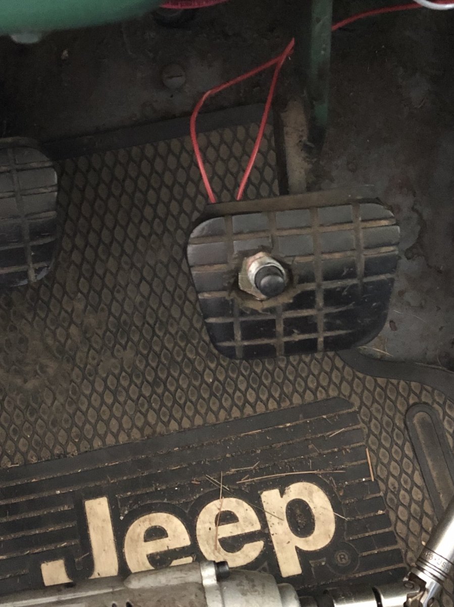

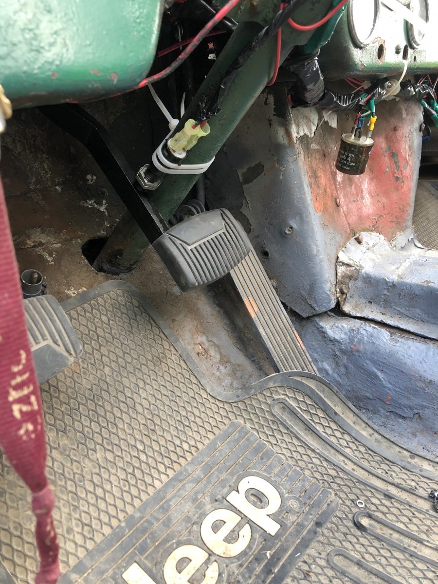

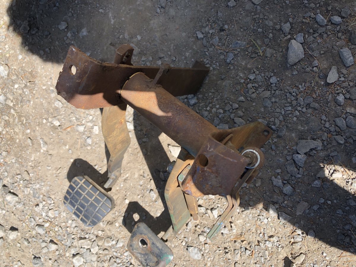

  26. Thepartsbinguy1
    Joined: Oct 14, 2019
    Posts: 285
    Thepartsbinguy1
    from Space
    Like the post above I had a ****on on the pedals. When I took the pedals out and had to use a pressure switch. 2ECF1508-3C6A-4F63-A048-FC49E3DF6212.jpeg 384F4132-B34E-48F9-8AB9-B52CFA37B46E.jpeg AC7E0B51-B928-44A4-8361-3D493409E85C.jpeg
