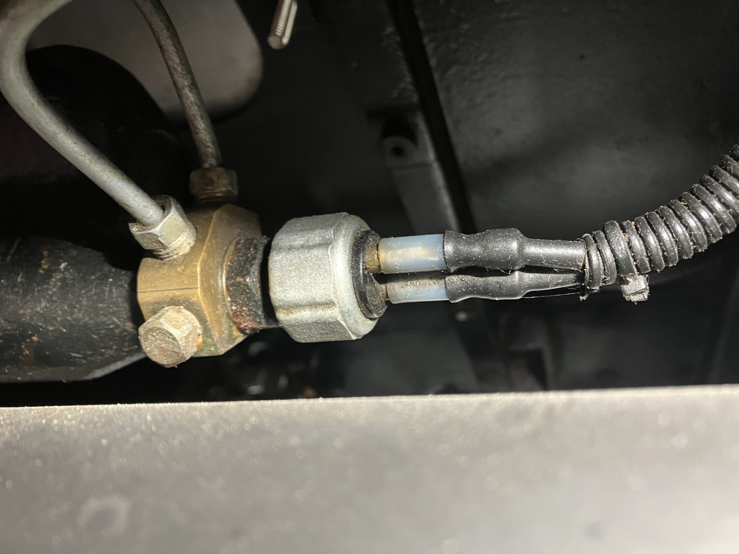

    This is in my ‘30 Model A, no clue what the original application would be. Figured I would ask to see if these were fairly universal. Any thoughts on what part number or application to start chasing?

    Any switch with 1/8'' pipe thread will work. There's at least 10 different configurations of terminals, so pick what serves you best with your wiring.

    that looks like the type used on Fords....from the 40s-60s.
    SLS27 is a common part number, in stock at OReillys, etc.
    There are problems with how long they last, so maybe you'll want to dive deeper, but there are plenty of threads here about them.
